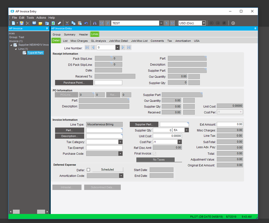

I have a PO that was closed and invoiced in Nov 2018. They went back in Feb and added a Misc Charge to the Line. We can’t invoice the line since it was already invoiced. (Does not pull in when creating invoice). The only think I can think accounting needs to do is create a Misc Loan for that charge.
Am I telling them correct to just create a Misc Line?

Did you ever resolve this? We are running into the same situation and I’m curious if you figured out the best way to handle it. I think Nick’s response is accurate but is related to the Order/AR Invoice side, whereas this is an issue with the Purchase Order and AP Invoice.

We didn’t get a clear answer and I may not have another for a few weeks when our consultant comes back. Are your charges related to a job? He showed us this but we are linked to jobs.
Yeah our charges are linked to a Job. So we ended up just adding them as Job Misc Charges instead of PO Misc Line Charges, and then Invoiced them that way. Seemed to work well! Thanks again for checking!
