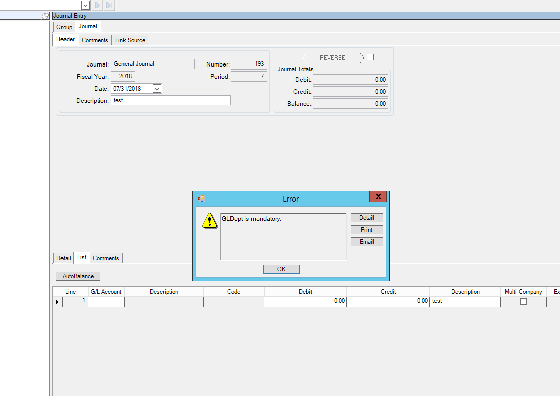

The error code I continue to get when attempting this is “GLDEPT is mandatory”. Any Ideas? I have then entire G/L code under G/L account.
I assume you’ve made the group, and added a new Journal.
The values you are using in the GL Account are exact matches for the format the company uses, and the GL accounts are active?

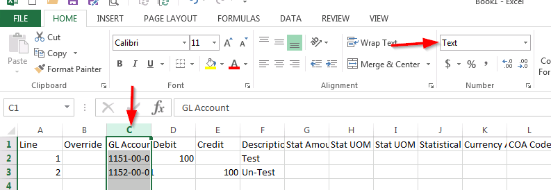

A far fetched thing, but make sure the source data is Text. I could see entering acct 2237-01-01 into excel, and Excel interpreting it as a date (Jan 1, 2237). Then when it’s copied to the clipboard, it tries to paste the value 123089 (the excel date equivalent of 1/1/2237)
Select the column in excel that has the GL account, and set the type to Text
I have made a group, and new journal and a new line.
I did verify that I have it on text and got the same error code.

I tried with and without the code filled in
You should be able to right click in the grid and select copy to Excel if it is available.
first clear that incomplete line by selecting it and deleteing it.

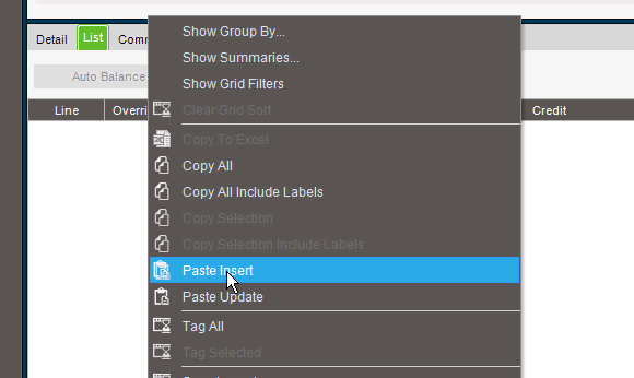

Just so we’re clear… When using Paste Insert, you don’t need to make the first row. Just right click in the grid area, and select Paste Insert.
Try just copying and pasting just one row. Don’t select the whole row in Excel, just the first few columns. Like:
Try pasting that into a word doc (use Ctrl+Shift+V and select Unformated text), and turn the show characters on. (the Paragraph symbol)
I highlighted the values that will be pasted (2 of them are blank)

I was starting a line but you have to not start the line, click on the header “line” and paste. Also, the GL under code was not a valid reference. I had to remove that.
