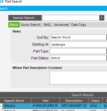

Are you talking about in the part entry screen? Because there it is displaying and working fine. It is in the search option that we are seeing issues. If the whole word is spelled out it skips “Rectangl” completely.

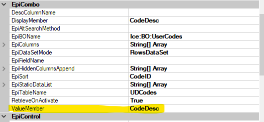

On your custom drop down. Open it up in Customization mode and go to the properties for that drop-down field (EpiCombo). This will default to CodeID. So it’s storing only the ID to the database, not the description. Change it to CodeDesc and then try to reset your drop down and save it.

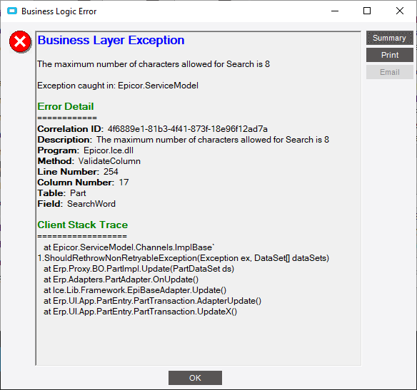

It is throwing a complaint when I try and update a search word field that it is limited to 8 characters then and won’t let me save.

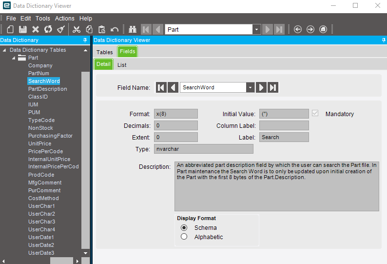

Well that’s a bummer. That field in the Part table is limited to 8 characters. It won’t let you shove any more into it.

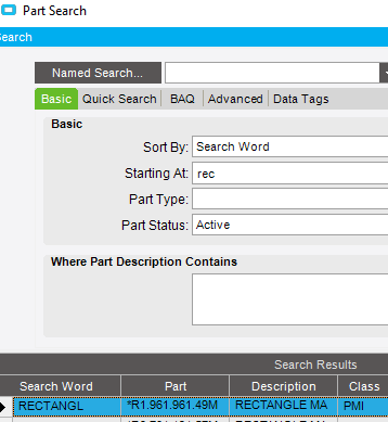

I do want to use the description in the search but it seems to be searching on the code is the issue. When I click the binoculars and select search word as the Sort By and then type in Rectangle I want it to compare that to the Description not the Code.

I see. Then you definitely want to store the codeID, not the description. To search it, you may consider making a quick search and adding the field in there but making the input be a list… then you could hard code the list as codes/descriptions and a user could pick from the drop down in the search rather than type it in… just thinking out loud.
