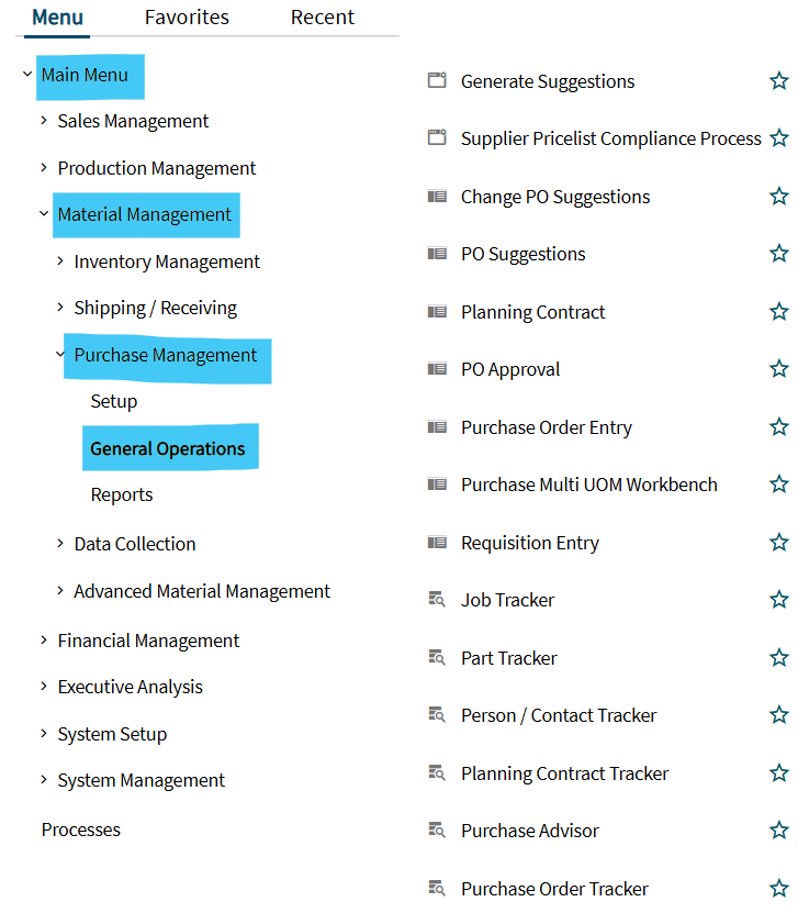

I’m on Kinetic but the permissions issue likely has to work the same for you. Grant access to all the ones in blue and then grant the individual ones off that Gen Ops menu that you want him to have.

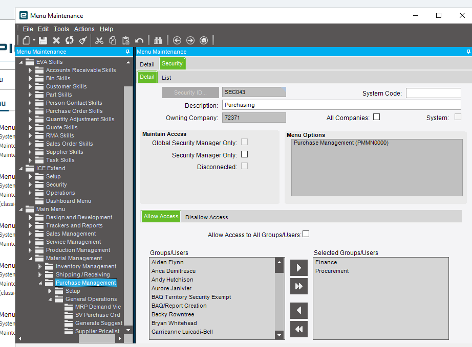

I have created a security group
I have menu maintenance open on one window to find the name of the Security ID for the menu items I need.
I can allow or deny them for
Material Management
Purchase Management
However everything is greyed out for General options and everything inside it.

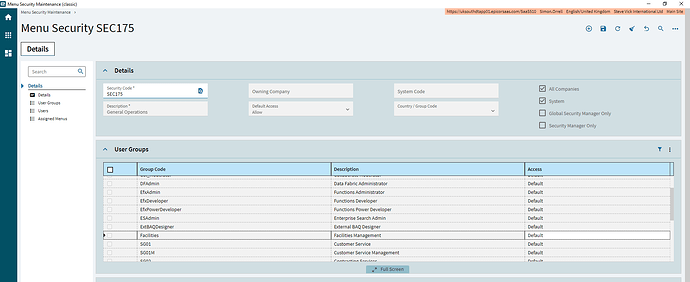

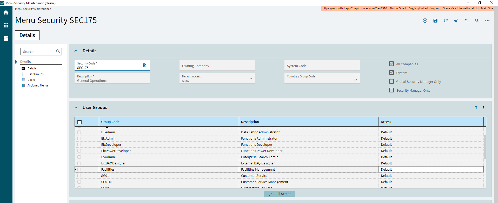

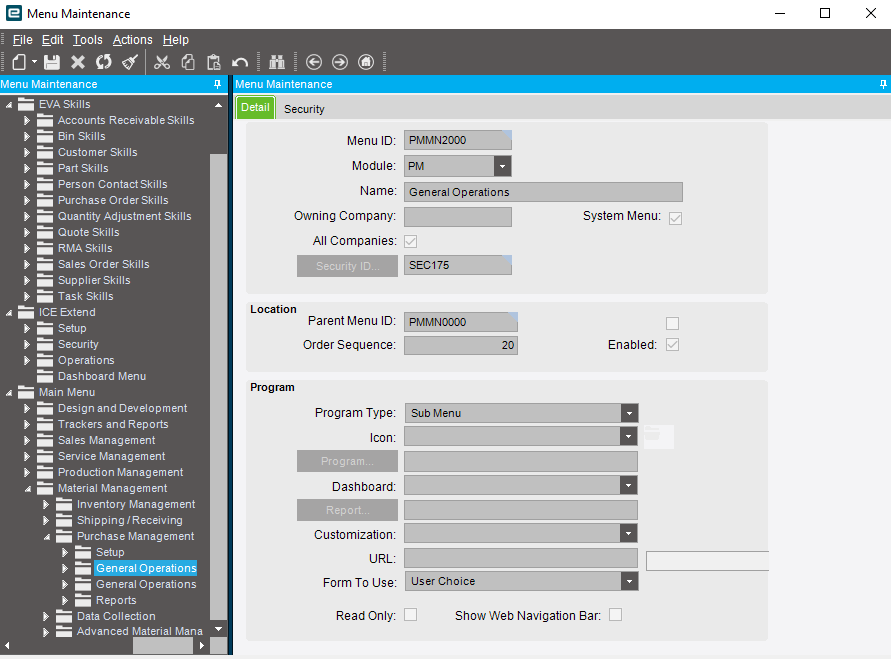

As you can see in the below screen shot this is for the General Options Menu item. The Facilities security group is the one I need to ammend however they are all greyed out and wont change from default.
I do notice the default access is to allow which is also greyed out. Perhaps this is my issue?
That’s odd…if General Ops is allowed by default then you might have to disallow the individual menu items underneath for that Facilities group code?

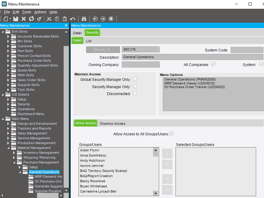

At the menu level, go to the Overflow menu (three horizontal dots in the upper right) and select “Copy to Current Company”. Once you do that the fields will open for input. You’ll need to do that on each menu you want to change access to.
I’ve only tweaked security - haven’t added new groups etc - so maybe I’m only seeing a partial picture. :roll_eyes:
yes looks like the security group cannot be changed for that menu item.
see below the one for the purchase management node and then undernearth the one for general management (open in classic view)

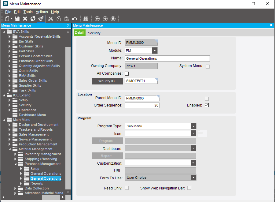

Copied the menu to the current company. Then it allowed me to change the security group to the test group I created.
However the original menu item is still present and wont let me uncheck disabled or remove it or delete is so I have both menus.
below is the old menu screenshot followed by the new menu screenshot.
on that classic screen you’re on, go to the Security tab. The “Copy to Current Company” option is under the Actions menu here.
Thank you very much that’s brilliant. Now its changeable.
