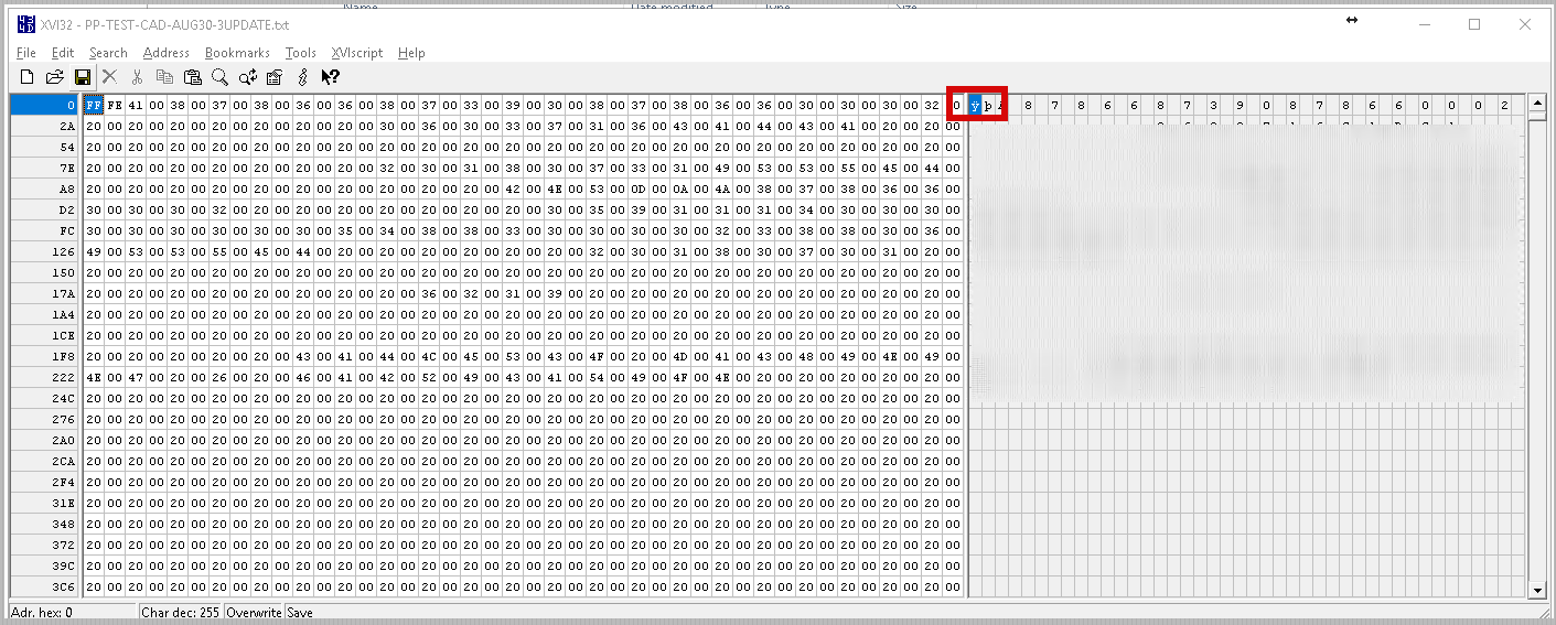

I created a positive pay SSRS report by modifying the Check Register report. The problem I’m finding though is that when I export the file (or make any changes to it), these two hidden characters appear in my text file. I have to use a hex editor in order to see them. If I remove them, the file is good, but if I make any changes to the file, they come back and I have to use the hex editor again.

Figured it out @bordway - when I print it out to csv, I was choosing ‘unicode text’, if I chose ‘tab delimited txt’ it doesn’t have the hidden characters.
