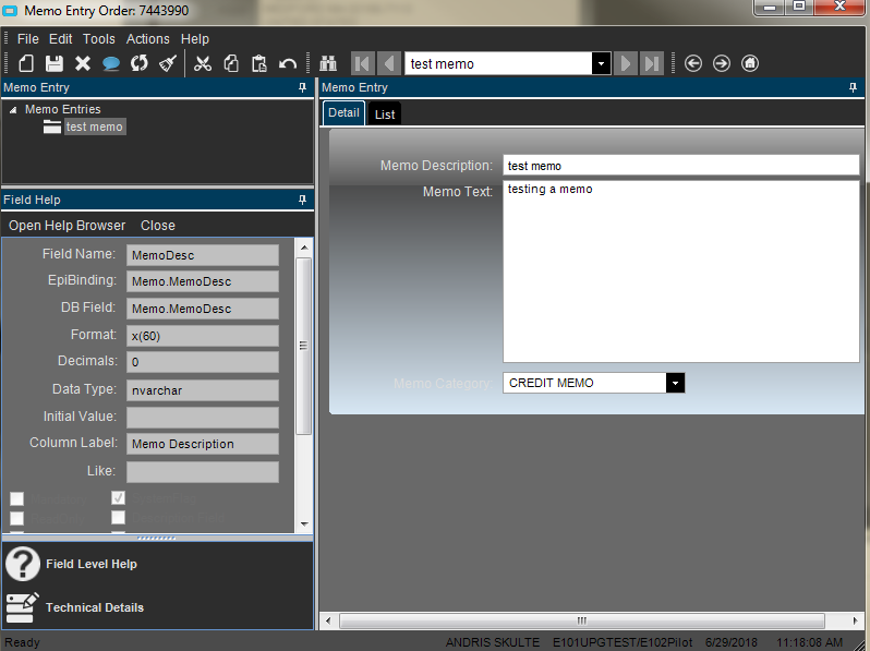

Here’s details from a memo attached to a sales order:

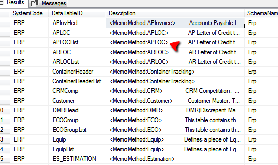

Now the problem described for UD100 tables which may not be a problem for APInvHead IS that when you hit Add New Memo Epicor Checks ZDataTable to see if the Description looks like this
2018-07-01_1930
If it does then it checks permissions to see if it can run
Ice.Manager.Security.CheckSecurityAccess("BO.Memo.Allow___YOURTABLE_HERE___Memo"));
Not sure what else you have to do for a UD100 table! But you might have no issues doing it for APInvHead since I see
APInvHed	<MemoMethod:APInvoice>         Accounts Payable Invoice Header. DELETE: Not allowed if Posted.
