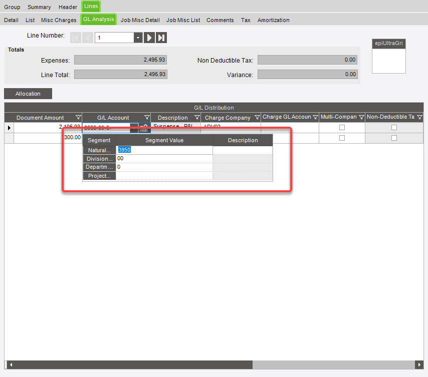

How do I get the same GL Account Combo box for a UD GL Account field
I have added a UD field that is another GL Account.
I want to allow the user to enter the data the same as the G/L Account combo. (see pic)
I have done the extended properties to become the same. I think I need more customisation in order to allow the user to use the same data entry combo. Any one got ideas, please let me know.
