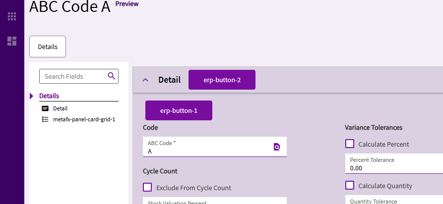

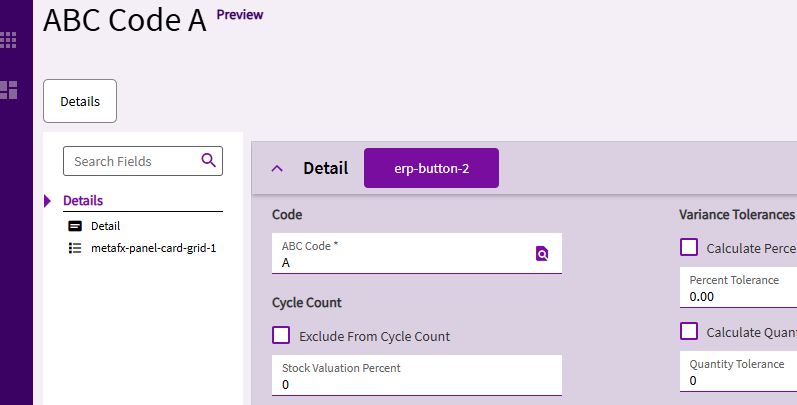

~~ My Test ~ ~
Added a DIV and just threw a button inside so something would display.
I then created an onClick event of Button no. 2 in the title bar.
Iām not checking any conditions here⦠but just wanted to test the hidden property.
Preview - Before:
After:

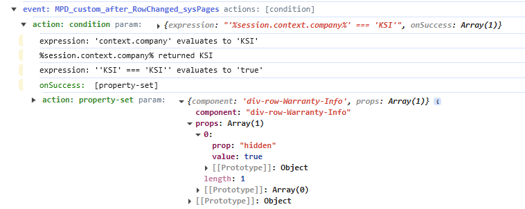

Is there a way to see an objects current settings like the hidden through the Console?
Here is a snippet from my Console Log:
rowChanged: RowChanged_sysPages actions: [condition]
main.b8b589898f0735be.js:164 action: condition param: {expression: āā{sysPages.epBinding}ā.startsWith(āLandingPageā) && ā{TransView.SysBypassLandingPage}ā != ātrueāā, onSuccess: Array(1)}
main.b8b589898f0735be.js:164 expression: āāā.startsWith(āLandingPageā) && āfalseā != ātrueāā evaluates to āfalseā
main.b8b589898f0735be.js:164 event: MPD_custom_after_RowChanged_sysPages actions: [condition]
main.b8b589898f0735be.js:164 action: condition param: {expression: āā%session.context.company%ā === āKSIāā, onSuccess: Array(1)}
main.b8b589898f0735be.js:164 expression: ācontext.companyā evaluates to āKSIā
main.b8b589898f0735be.js:164 %session.context.company% returned KSI
main.b8b589898f0735be.js:164 expression: āāKSIā === āKSIāā evaluates to ātrueā
main.b8b589898f0735be.js:164 onSuccess: [property-set]
main.b8b589898f0735be.js:164 action: property-set param:

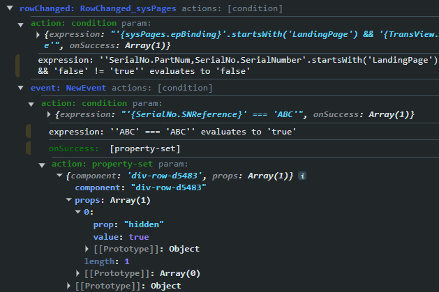

I threw a condition in my event just to verify⦠still worked.
Can you show your property-set params in debugger, like below?

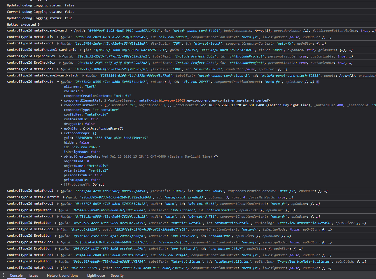

Ctrl + Shift + L will log all components to the console.
Iām doing this on a form like this

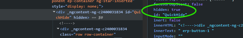

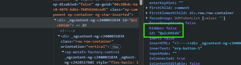

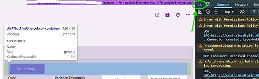

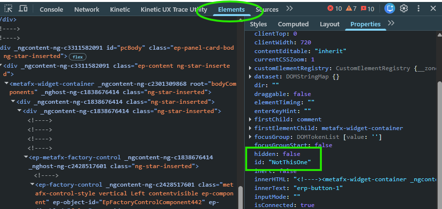

In debugger, there is an icon for looking at individual elements. You can click that icon, and then click on an element in your form.
This will switch over to the Elements tab in your dev tools⦠and you can see properties there:
Just keep in mind that some elements are layered on top of others. In this case the one I clicked on was NOT the one I wanted.
You can click around in the left hand side to move up/down the layers of elements to find the right one:
After I run my event, I can see that value update to True:
May be easier ways to do this⦠but, this has worked for me.

Itās supposed to work when epdebug is true. (ctrl + shift + 8)
It worked for me today for the first time in like forever.
Supposedly not working is caused by a competing hotkey registered locally but I never found anything on my end.

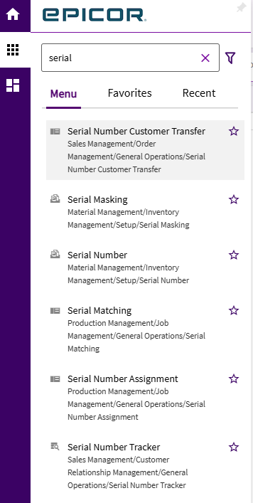

Where are you? We donāt use serials⦠but I can dabble:
Oh⦠never mind⦠I think it is just the Serial Number menu.

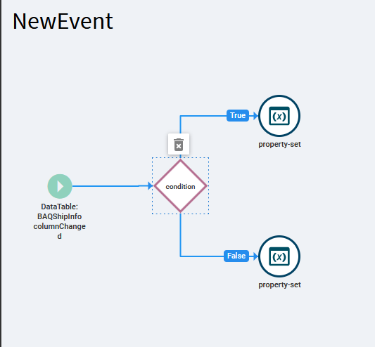

Used a different condition⦠but still worked fine for me:

When the f*er doesnāt work, press CTRL + K, and type Lo, you should see āLog All Component Modelsā
FFS Epicor, make hotkeys configurable
I think I had to click in the form and not the console to get this to work. Then again, you may all tell me:

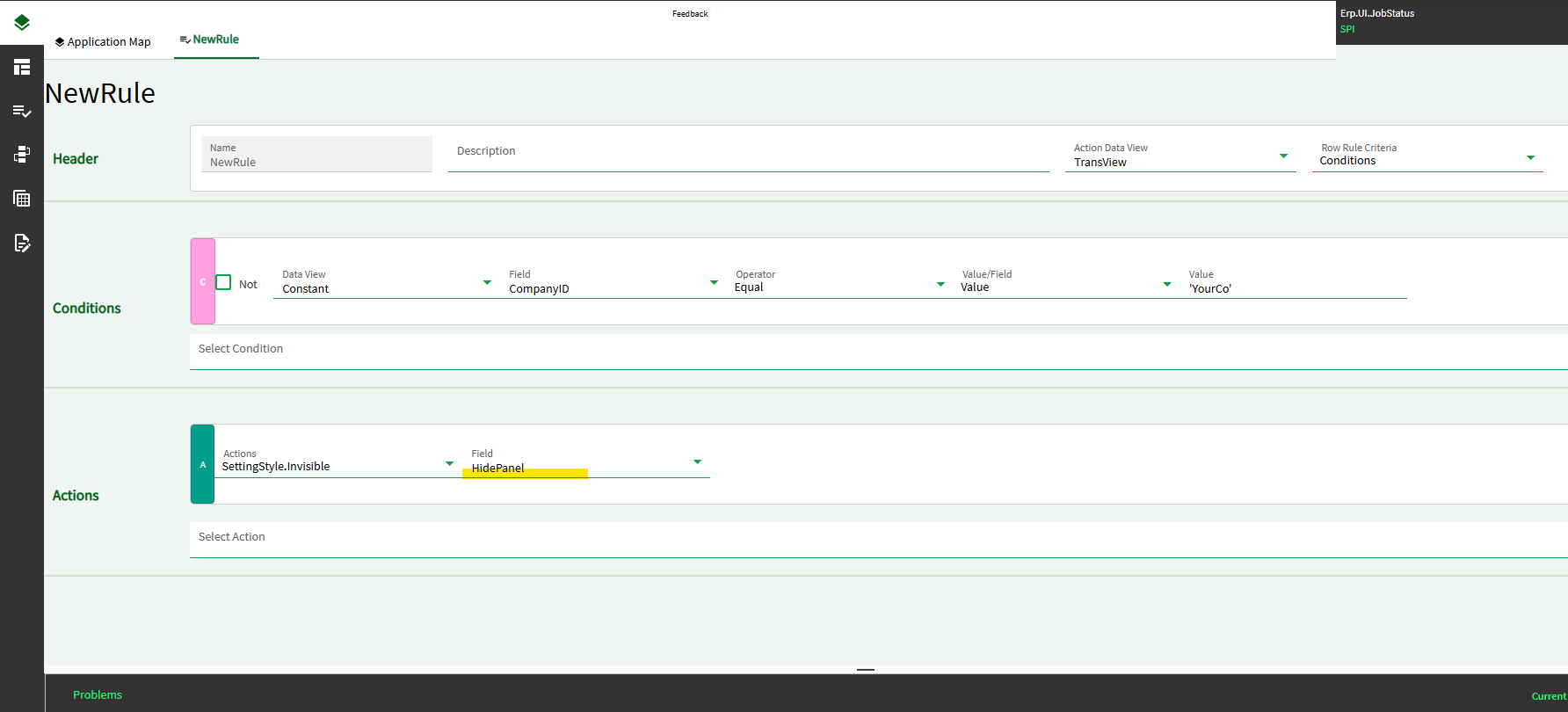

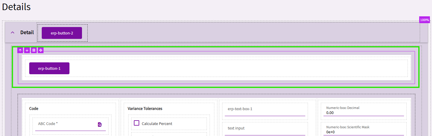

It should work for 2025.2. As a plan B you could try a row rule. You;d have to put the div inside a container having an epBinding property such as a panel-card. Then condition your rule off Constant.CompanyID = āYourCoā
Like this where TransView.HidePanel is the epBinding property value of the panel youāre hiding:

Looks like Plan B is working but a bit ugly.
I am going to poke at Plan A some more to see if there was something I was overlooking yesterday.
