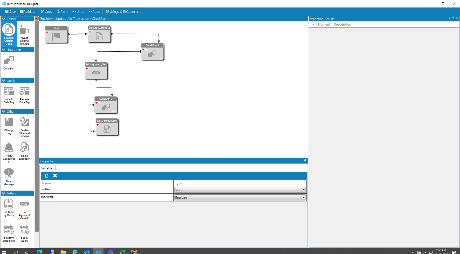

And the custom code is
string JobNum = "";
JobNum = ttJobMtl.FirstOrDefault().JobNum;
var JobInfo = (from JobHead_Row in Db.JobHead where JobHead_Row.JobNum == JobNum select JobHead_Row).FirstOrDefault();
if (JobInfo.JobType.ToString() == "MFG")
  checkPart = true;
 else
   checkPart = false;
So you’re only checking MFG jobs… and if you find a part number that doesn’t exist in Part table, you’re throwing an exception, correct?
It looks like you need to add some more criteria at the beginning because you’re going to pickup every change to the JobMtl table… not just the “added rows”. So you’re preventing anyone from updating those jobs in addition to creating new ones. That’s my guess.

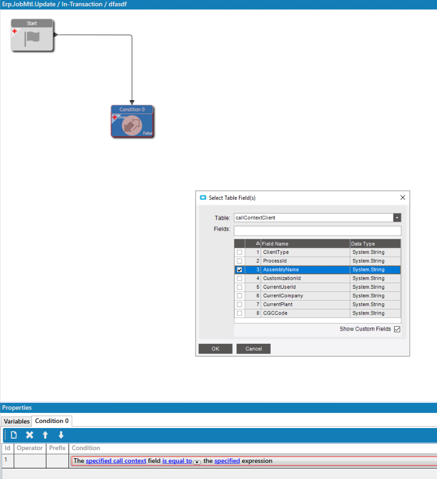

You can check the calling assembly from a property in the client call context, from the BPM.
What property? Is that something I need to write custom code for?
You don’t have to write custom code, it is available in a regular condition widget:

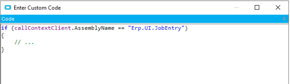

Or, if you are going to write code anyway:
Check the trace to see what the actual value will be…
