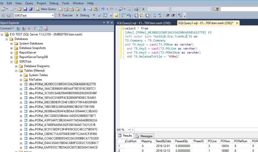

Do you have a sql editor? TOAD or SQL Server Management Studio, or something like that?
You should be able to test the query there to see if there are error in the query. Find the temp guid replace it and run the query.

I am attaching what I mean.
You need to write the query in the SSRSTest (or what you call the report database), not from the Epicor Database. If you have issues let me know. We can connect offline.

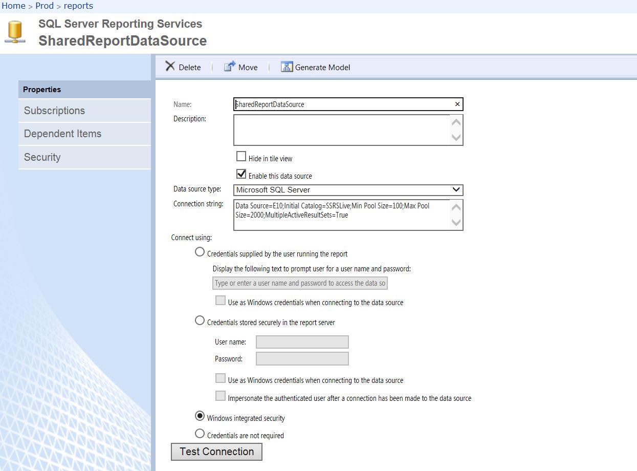

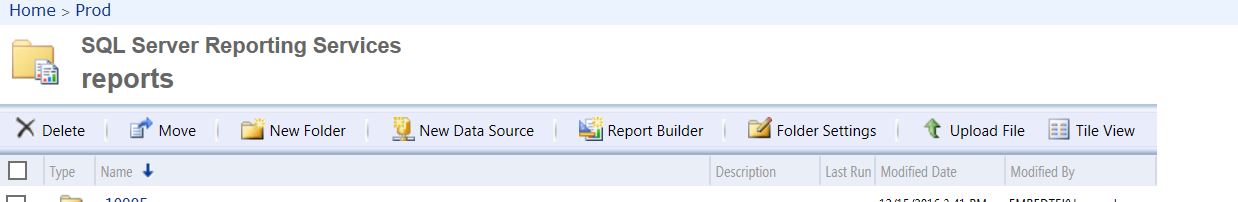

You might need to add a New data Source in SSRS
http://YOURSSRSSERVER/Reports/Pages/Folder.aspx?ViewMode=Detail
fill in the information. and then add the datasource to the SSRS report in the report builder.
