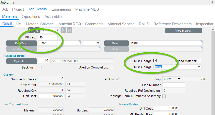

  1. on your job, you will need to add a MATERIAL line. When you add this, check the “Misc Charge” checkbox.
  2. Then choose the Misc Charge account you want it to go to.
  3. Now when you are in AP, you can apply any expenses to this misc charge on the job.

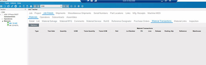

While I have seen that when the related AP Invoice post , the application updates the estimated unit material cost field of the related Misc. Charge; what I havent seen is the actual cost of the expense hitting the phase job. I can see the actuals in the ProjectPhase costs, but when I look at the job level I cannot see a direct material cost impact from those expenses. Shouldn’t I be able to see those as actual costs on the job?
Jason,

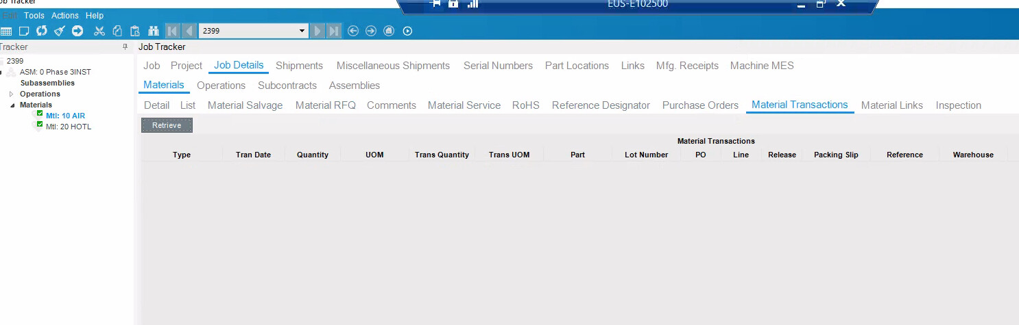

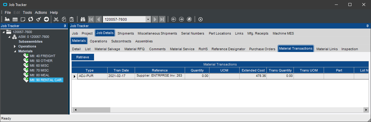

The charges should be applied to the job as ADJ-PUR entries. Can you see any transactions in Job Tracker > Material Transactions?
No there is nothing in the material transactions history. Nothing on the Produciton Detail report either.

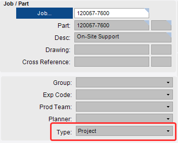

Is the job example you used above a Project Phase Job, or a manufacturing job?
It’s a Project Phase job.
Im not sure why the transactions are showing up then on ours. I can even see the Green checkboxes on the mtl tree cards indicating the demand has been fulfilled…but the transaction history is blank.
Misc Charge always shows the green checkmark, because technically there is no real demand. Are you entering the costs via Job Charge on an AP Invoice, or just creating the Misc Charge in Job Entry?
Its being auto-created during the Generate Expense Invoices for Employees process that creates the invoice and makes the job charge references in both the Invoice Detail (APInvjob table) and in the Job Material table. The posting of that Invoice is what I was looking for to make the actual cost apply to the job.
