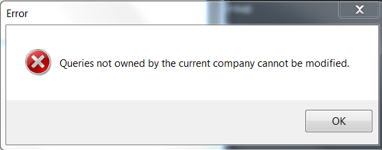

I would assume if you take ownership (change author) from a diff company, that might work.
Mr. Chris: Thanks for the suggestion. I get an error message:
Drats, foiled again.
