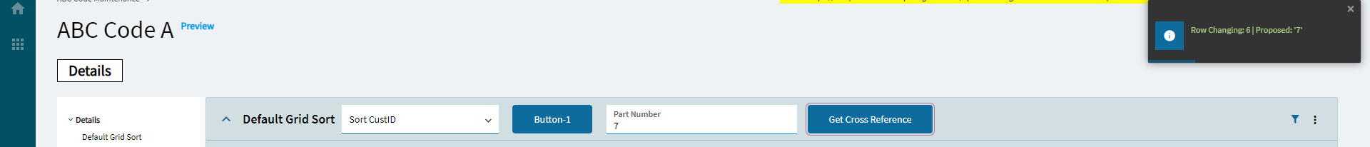

I have also question related to “Column Changing” Data Event.
Lets assume that user is changing text in TextBox from “A” to “B”, TextBox is bind to View.ColName.
When I will call a dialog box in Column Changing event then View.ColName will show me “A”.
Question is how can I get proposed value, in that case “B”?.
I was trying to display “B” in dialog using javascript, JSON but no success. Any hint?

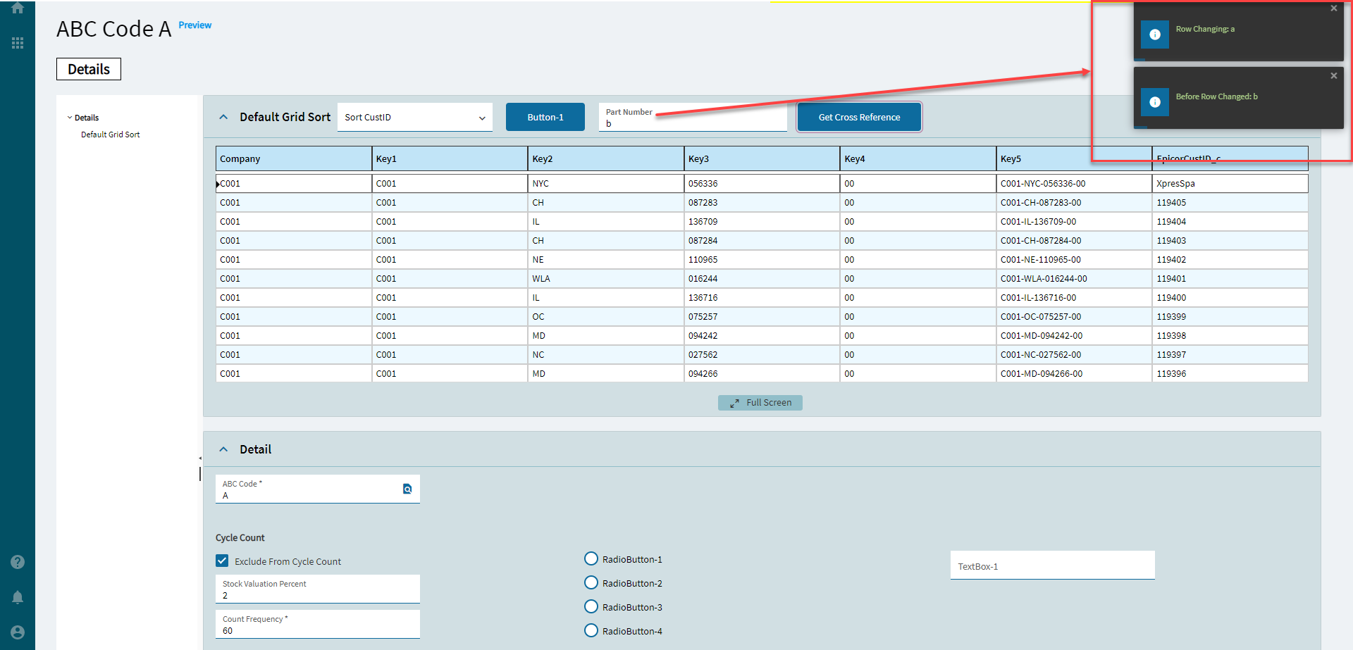

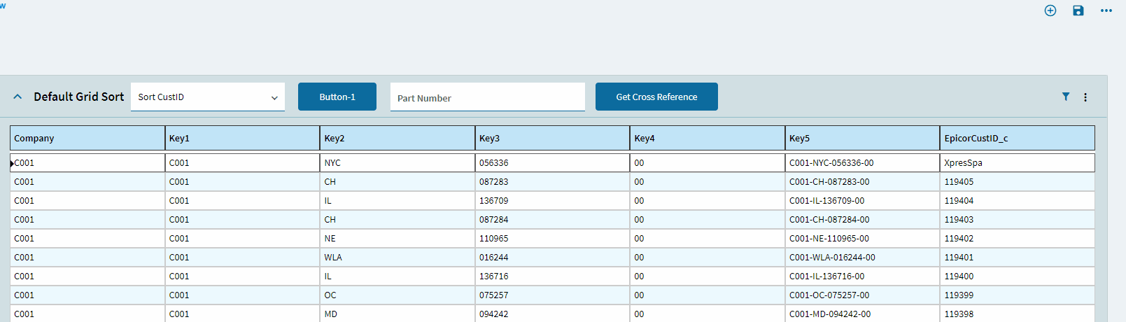

You may have to play with timing to get what you need, but first pass is you’ll want 3 events: DataTable > Column Changing, DataTable > Column Changed, and Event > Before > Column Changed.
This is just a stub event, so I can hook into the before.
That was smart :). However I need to check if adding even-cancel to ce_Before_RowChanged_PartNum will revert value from “b” back to “a”.

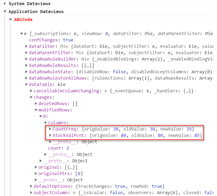

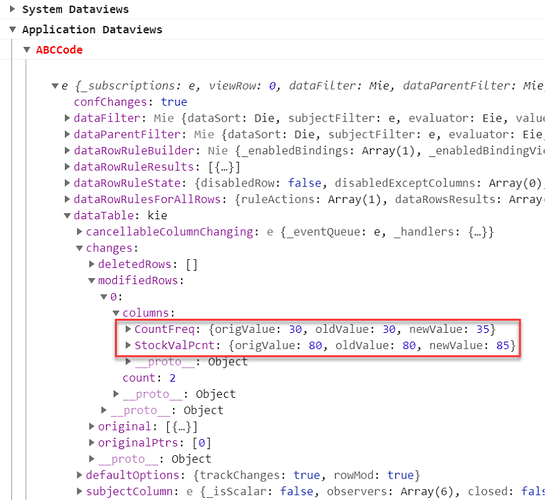

I was wondering if we can access the same information in Application Studio which is available during runtime in debugger.
As you can see on screenshot below “ABCCode” DataView is Red higlighted. So debugger knows that it was changed - where is that information stored?.
Debugger also know original value, oldValue, newValue - it means that this is also stored somewhere. Can we access that information in App Studio code? (two columns in dataTable > changes > modifiedRows)
I am also missing a place where I can do some “foreach” and go over all dvRows and dvColumns (or at lease all dvColums for current DataView).
I’m sure you can access those. I’ll just need to find the proper syntax. I can take a peek tomorrow morning.
Foreach is less than ideal. You have to use the dataview condition widget and do your stuff in the iteration event.
There’s a post floating around here regarding that.

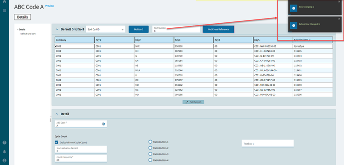

H’okay–you should be able to use %value% on the RowChanging event to get the proposed value.
Here’s with an event cancel.
EventCancel

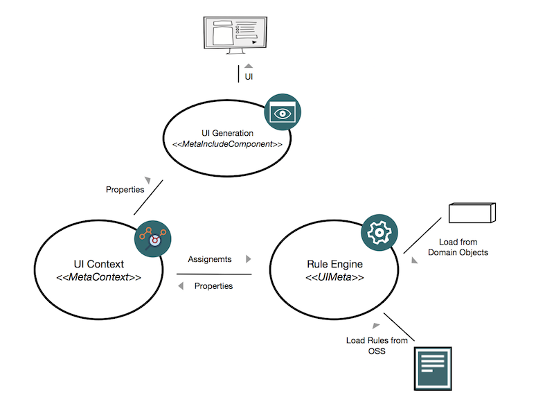

Chances are its a fork which then has been customized by epicor of
which used to be GitHub - SAP-archive/angular-metaui: Framework for building angular applications declaratively using rules. For more information: https://sap.github.io/angular-metaui/html
Their current website seems down by an archived version explains a bit more:
