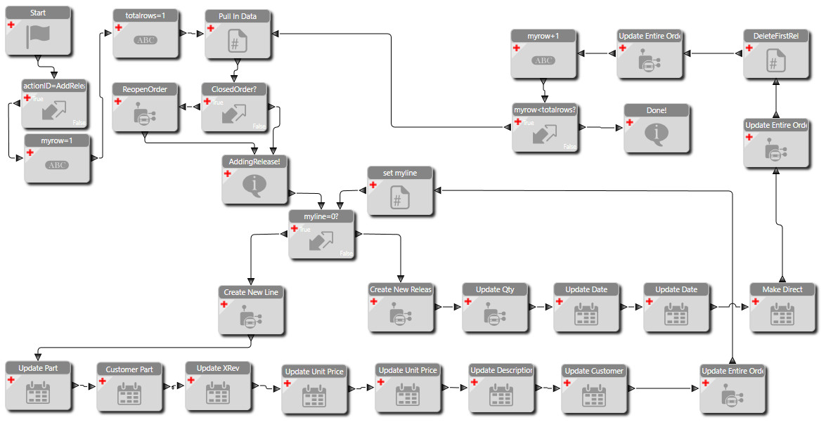

Next I use a set of updatable BAQs to compare existing order releases in Epicor with the expected order releases in UD02. If any of our orders in Epicor do not match, then we want to close the release and delete it. I can close the release just fine with the code below. But I canât figure out how to delete the release. In this example I am trying to delete the first release on a line.
I canât find the BO or method for deleting a release. In the code below MyOrder = the order number, MyLine = the line number, and MyVar = SalesOrder Tableset.

Side question: Can DeleteByID() be used to delete a release, not an order?
I have run a trace when deleting a release, but I donât recognize any of the methods as a delete method. Perhaps I need to set RowMod=âDâ, but I canât get the syntax to work for that in a custom action.
I understand that you canât delete a release if it is the only one left on a line, and you canât delete a release if something has shipped on it. Neither of these cases apply to my specific issue. I can expand on this further if it is helpful, but I donât want to get you all side-tracked.
