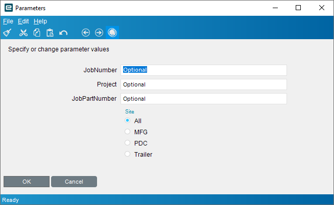

I’m making a dashboard to show jobs. I plan to give the user a parameter pop up like this (well, the App Studio version of it). Yes, truly optional parameters are possible in the BAQ (skip if empty, etc.), but they have drawbacks. This is nice because it actually says “optional” in the field.
But…
- What if they leave the “Optional” string in the boxes?
- How do I handle a dropdown or radio button for the sites AND allow the user to see all sites if desired?

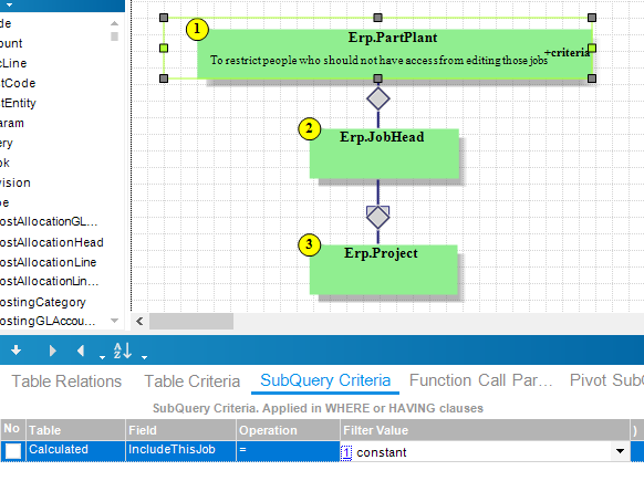

Here are the tables. Basically it’s just JobHead
. But to explain the rest:

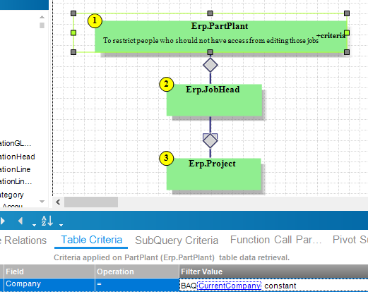

- As the comment says, I added
PartPlant
as an easy way to block a user that has no access to some sites. - The
Project
table is there only to add the Project Description - The criteria is as shown; it made the BAQ run faster. Yes, it really does.

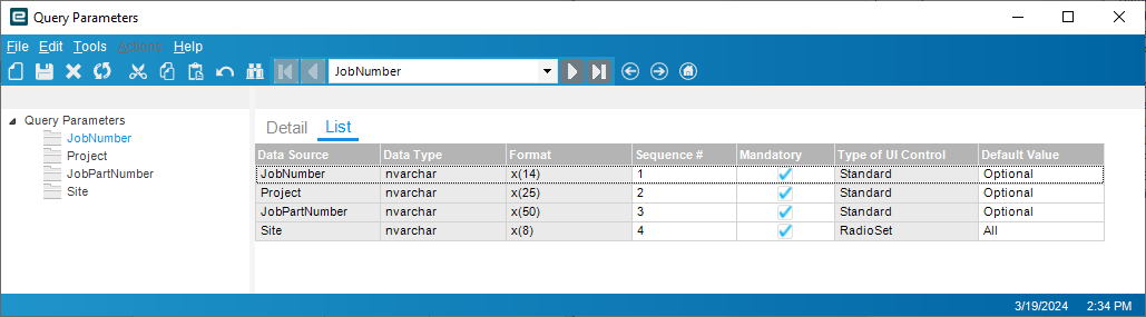

Here is the parameter setup.
- All are
Mandatory
and none are “Skip if empty” - Did you know that you can set default values in the grid, even if they look uneditable in the Detail tab? True story.
- Also did you know that the default value likes to delete itself any time you edit the parameters? Good times.

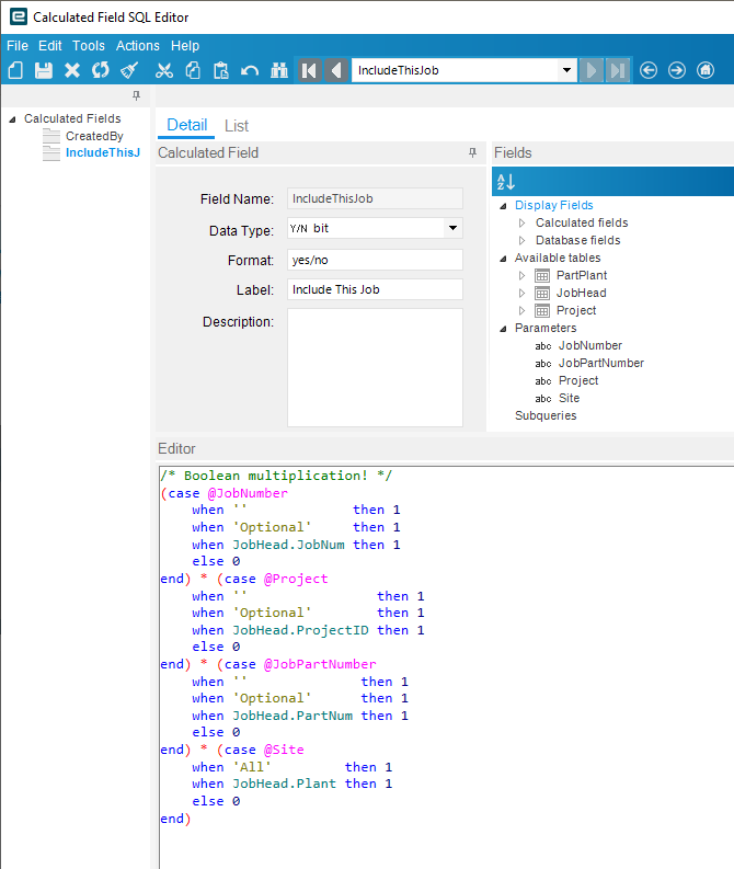

And here is how I handle those parameters.
- Each
case
statement results in a 1 or zero depending on the input- For the first 3
- If it’s blank, I take that to mean “don’t filter by this” – therefore all rows pass this test.
- If they left the word “Optional” in the input box, I also take that to mean “don’t filter by this”
- If they enter anything else, filter the corresponding field to that value

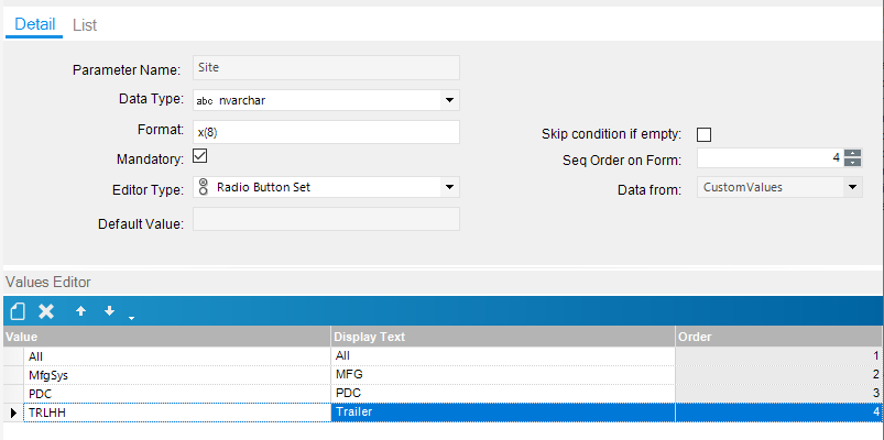

- For the site, I use a similar logic – ‘All’ results in 1, otherwise it needs a match
- For the first 3
- Then I multiply the
case
statements together- If all
case
statements return 1, then 1 x 1 x 1 x 1 = 1 – which meanstrue
- But if any
case
statements equal zero, the whole thing results infalse
- If all
And finally, I filter the whole SubQuery on that calculated field.
(If you use this as a SubQuery inside another SubQuery, you could put the criteria there, of course.)
