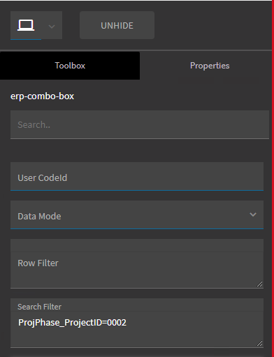

I tried by passing project binding to combo box and it showed me “No Data Found” but if I pass static value to filter of the combo box it works fine.
Below is the screenshot of passing the static filter to combo box:

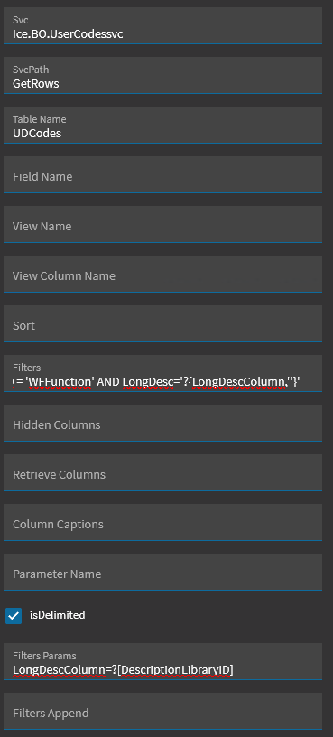

Is an example. The ‘LongDescColumn’ in the ‘Filters’ section is essentially just a placeholder that is replaced via the ‘Filters Params’ configuration.
JSONC Example
“svc”: “Ice.BO.UserCodessvc”,
      "svcPath": "GetRows",
      "textField": "CodeDesc",
      "valueField": "CodeID",
      "isDelimited": true,
      "comboId": "Test2",
      "tableName": "UDCodes",
      "filters": [
        "CodeTypeID = 'WFFunction' AND LongDesc='?{LongDescColumn,''}'"
      "filtersParams": [
        "LongDescColumn=?[DescriptionLibraryID]"

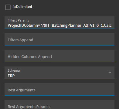

I tried your approach but still it is not working, I am attaching the below screenshots for reference:
In the above screenshot, it looks like you’ve used curly brackets ‘{’ instead of square ones ‘[’. See my example:
“LongDescColumn=?[DescriptionLibraryID]
How/where the difference types of brackets and syntaxes are used is a bit all over the place and I am yet to see a good resource/document with examples for all which is making it a lot harder than it should be at the moment. Hopefully soon Epicor or someone else can share a solid guide for clarity and assistance.
Maybe try square brackets and then if that doesn’t work, confirm that a static filter value works.
