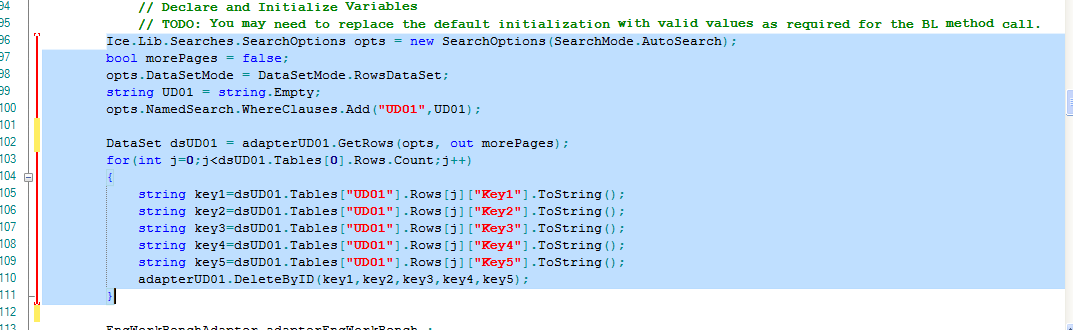

How to quickly delete table ud01?
I want to quickly delete the records in the ud01 table through adapterUD01. Is there a quick conditional delete function that is not for through each data line and then calls the function adapterUD01.DeleteByID(key1,key2,key3,key4,key5); Are not?
Ice.Lib.Searches.SearchOptions opts = new SearchOptions(SearchMode.AutoSearch);
bool morePages = false;
opts.DataSetMode = DataSetMode.RowsDataSet;
string UD01 = string.Empty;
opts.NamedSearch.WhereClauses.Add(“UD01”,UD01);
	DataSet dsUD01 = adapterUD01.GetRows(opts, out morePages);
	for(int j=0;j<dsUD01.Tables[0].Rows.Count;j++)
		string key1=dsUD01.Tables["UD01"].Rows[j]["Key1"].ToString();
		string key2=dsUD01.Tables["UD01"].Rows[j]["Key2"].ToString();
		string key3=dsUD01.Tables["UD01"].Rows[j]["Key3"].ToString();
		string key4=dsUD01.Tables["UD01"].Rows[j]["Key4"].ToString();
		string key5=dsUD01.Tables["UD01"].Rows[j]["Key5"].ToString();
I want to delete the condition is company data 01

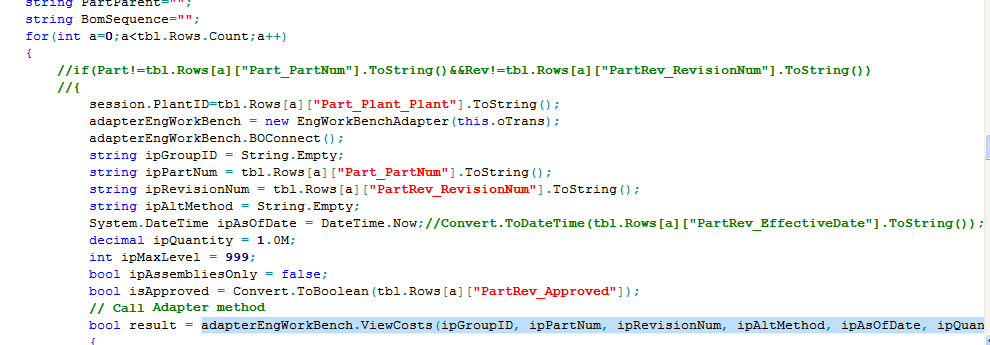

my company use ud01 table to store BOM (adapterEngWorkBench.ViewCosts) to get data as weekly or monthly report
EngWorkBenchAdapter adapterEngWorkBench ;
adapterEngWorkBench = new EngWorkBenchAdapter(this.oTrans);
adapterEngWorkBench.BOConnect();
//adapterEngWorkBench.BOConnect();
int key=1;
DataTable tbl = GetBAQData(“DMS_GetAllPart”);
string Part=“”;
string Rev=“”;
string PartParent=“”;
string BomSequence=“”;
for(int a=0;a<tbl.Rows.Count;a++)
//if(Part!=tbl.Rows[a][“Part_PartNum”].ToString()&&Rev!=tbl.Rows[a][“PartRev_RevisionNum”].ToString())
session.PlantID=tbl.Rows[a][“Part_Plant_Plant”].ToString();
string ipGroupID = String.Empty;
string ipPartNum = tbl.Rows[a][“Part_PartNum”].ToString();
string ipRevisionNum = tbl.Rows[a][“PartRev_RevisionNum”].ToString();
string ipAltMethod = String.Empty;
System.DateTime ipAsOfDate = DateTime.Now;//Convert.ToDateTime(tbl.Rows[a][“PartRev_EffectiveDate”].ToString());
decimal ipQuantity = 1.0M;
int ipMaxLevel = 999;
bool ipAssembliesOnly = false;
bool isApproved = Convert.ToBoolean(tbl.Rows[a][“PartRev_Approved”]);
// Call Adapter method
bool result = adapterEngWorkBench.ViewCosts(ipGroupID, ipPartNum, ipRevisionNum, ipAltMethod, ipAsOfDate, ipQuantity, ipMaxLevel, ipAssembliesOnly);
int BomLevelPre=0;
int BomLevelCur=0;
string PartParentCur=“”;
//string PartParentPre=“”;
List PartPar=new List(); //Part Parent
List Bomseq=new List(); //Bom Sequence Part Parent
for(int i=0;i<adapterEngWorkBench.EngWorkBenchCostData.Tables[1].Rows.Count;i++)
result = adapterUD01.GetaNewUD01();
if(result)
string PartArr = adapterEngWorkBench.EngWorkBenchCostData.Tables[“PartRevCostsDetail”].Rows[i][“MtlPartNum”].ToString().Split(‘.’);
int PartIndex=PartArr.Length-1;
BomLevelCur=Convert.ToInt32(adapterEngWorkBench.EngWorkBenchCostData.Tables[1].Rows[i][“BOMLevel”]);
if(Convert.ToInt32(adapterEngWorkBench.EngWorkBenchCostData.Tables[1].Rows[i][“BOMLevel”])==0||Convert.ToInt32(adapterEngWorkBench.EngWorkBenchCostData.Tables[1].Rows[i][“BOMLevel”])==1)
PartParent=adapterEngWorkBench.EngWorkBenchCostData.Tables[1].Rows[i][“PartNum”].ToString();
BomSequence=adapterEngWorkBench.EngWorkBenchCostData.Tables[1].Rows[0][“BomSequence”].ToString();
BomLevelPre=Convert.ToInt32(adapterEngWorkBench.EngWorkBenchCostData.Tables[1].Rows[i][“BOMLevel”]);
if(BomLevelPre==1)
PartPar=new List();
Bomseq=new List();
PartParentCur=PartArr[PartIndex];
PartPar.Add(PartArr[PartIndex]);
Bomseq.Add(adapterEngWorkBench.EngWorkBenchCostData.Tables[1].Rows[i][“BomSequence”].ToString());
//BomLevelCur=0;
else{
if(BomLevelCur>BomLevelPre)
if(BomLevelCur>PartPar.Count)
else{
PartPar[BomLevelCur-1]=PartArr[PartIndex];
Bomseq[BomLevelCur-1]=adapterEngWorkBench.EngWorkBenchCostData.Tables[1].Rows[i][“BomSequence”].ToString();
else if(BomLevelPre==BomLevelCur)
PartPar[BomLevelPre-1]=PartArr[PartIndex];
Bomseq[BomLevelPre-1]=adapterEngWorkBench.EngWorkBenchCostData.Tables[1].Rows[i][“BomSequence”].ToString();
else{
PartParent=PartPar[BomLevelCur-2];
BomSequence=Bomseq[BomLevelCur-2];
BomLevelPre=BomLevelCur;
						adapterUD01.UD01Data.UD01.Rows[0]["Company"]=adapterEngWorkBench.EngWorkBenchCostData.Tables[1].Rows[i]["Company"];
						int l=key.ToString().Length;
						string Mykey="000000000"+key.ToString();
						adapterUD01.UD01Data.UD01.Rows[0]["Key1"]=string.Format("{0}",Mykey.Remove(0,l));
						adapterUD01.UD01Data.UD01.Rows[0]["Key2"]=adapterEngWorkBench.EngWorkBenchCostData.Tables[1].Rows[i]["PartNum"];
						adapterUD01.UD01Data.UD01.Rows[0]["Key3"]=adapterEngWorkBench.EngWorkBenchCostData.Tables[1].Rows[i]["RevisionNum"];
						adapterUD01.UD01Data.UD01.Rows[0]["Key4"]=adapterEngWorkBench.EngWorkBenchCostData.Tables[1].Rows[i]["MtlPartNum"];
						adapterUD01.UD01Data.UD01.Rows[0]["Key5"]=adapterEngWorkBench.EngWorkBenchCostData.Tables[1].Rows[i]["BOMLevel"];
						adapterUD01.UD01Data.UD01.Rows[0]["Character01"]=adapterEngWorkBench.EngWorkBenchCostData.Tables[1].Rows[i]["Quantity"];
						adapterUD01.UD01Data.UD01.Rows[0]["Character03"]=adapterEngWorkBench.EngWorkBenchCostData.Tables[1].Rows[i]["BOMType"];
						adapterUD01.UD01Data.UD01.Rows[0]["Character04"]=adapterEngWorkBench.EngWorkBenchCostData.Tables[1].Rows[i]["MaterialCost"];
						adapterUD01.UD01Data.UD01.Rows[0]["Character05"]=adapterEngWorkBench.EngWorkBenchCostData.Tables[1].Rows[i]["LaborCost"];
						adapterUD01.UD01Data.UD01.Rows[0]["Character06"]=adapterEngWorkBench.EngWorkBenchCostData.Tables[1].Rows[i]["BurdenCost"];
						adapterUD01.UD01Data.UD01.Rows[0]["Character07"]=adapterEngWorkBench.EngWorkBenchCostData.Tables[1].Rows[i]["SubcontractCost"];
						adapterUD01.UD01Data.UD01.Rows[0]["Character08"]=adapterEngWorkBench.EngWorkBenchCostData.Tables[1].Rows[i]["BomSequence"];
						adapterUD01.UD01Data.UD01.Rows[0]["Character09"]=PartArr[PartIndex];
						adapterUD01.UD01Data.UD01.Rows[0]["Character10"]=adapterEngWorkBench.EngWorkBenchCostData.Tables[1].Rows[i]["PartDescription"];
						adapterUD01.UD01Data.UD01.Rows[0]["Number01"]=adapterEngWorkBench.EngWorkBenchCostData.Tables[1].Rows[i]["MaterialBurdenCost"];
						adapterUD01.UD01Data.UD01.Rows[0]["Number02"]=adapterEngWorkBench.EngWorkBenchCostData.Tables[1].Rows[i]["TotalCost"];
						adapterUD01.UD01Data.UD01.Rows[0]["Number03"]=adapterEngWorkBench.EngWorkBenchCostData.Tables[1].Rows[i]["MaterialUnitCost"];
						adapterUD01.UD01Data.UD01.Rows[0]["Number04"]=adapterEngWorkBench.EngWorkBenchCostData.Tables[1].Rows[i]["LaborUnitCost"];
						adapterUD01.UD01Data.UD01.Rows[0]["Number05"]=adapterEngWorkBench.EngWorkBenchCostData.Tables[1].Rows[i]["BurdenUnitCost"];
						adapterUD01.UD01Data.UD01.Rows[0]["Number06"]=adapterEngWorkBench.EngWorkBenchCostData.Tables[1].Rows[i]["SubcontractUnitCost"];
						adapterUD01.UD01Data.UD01.Rows[0]["Number07"]=adapterEngWorkBench.EngWorkBenchCostData.Tables[1].Rows[i]["MaterialBurdenUnitCost"];
						adapterUD01.UD01Data.UD01.Rows[0]["Number08"]=adapterEngWorkBench.EngWorkBenchCostData.Tables[1].Rows[i]["TotalUnitCost"];
						adapterUD01.UD01Data.UD01.Rows[0]["Number09"]=adapterEngWorkBench.EngWorkBenchCostData.Tables[1].Rows[i]["QtyPer"];
						adapterUD01.UD01Data.UD01.Rows[0]["Number10"]=adapterEngWorkBench.EngWorkBenchCostData.Tables[1].Rows[i]["RequiredQty"];
						adapterUD01.UD01Data.UD01.Rows[0]["Number11"]=adapterEngWorkBench.EngWorkBenchCostData.Tables[0].Rows[0]["MaxLevel"];
						adapterUD01.UD01Data.UD01.Rows[0]["Date01"]=adapterEngWorkBench.EngWorkBenchCostData.Tables[1].Rows[i]["EffectiveDate"];
						adapterUD01.UD01Data.UD01.Rows[0]["ShortChar01"]=adapterEngWorkBench.EngWorkBenchCostData.Tables[1].Rows[i]["MtlRevision"];
						adapterUD01.UD01Data.UD01.Rows[0]["ShortChar02"]=tbl.Rows[a]["PartRev_Plant"].ToString();
						adapterUD01.UD01Data.UD01.Rows[0]["ShortChar03"]=PartParent;
						adapterUD01.UD01Data.UD01.Rows[0]["ShortChar04"]=adapterEngWorkBench.EngWorkBenchCostData.Tables[1].Rows[i]["PartNum"].ToString()+adapterEngWorkBench.EngWorkBenchCostData.Tables[1].Rows[i]["RevisionNum"].ToString()+PartParent+BomSequence;;
						adapterUD01.UD01Data.UD01.Rows[0]["ShortChar05"]=adapterEngWorkBench.EngWorkBenchCostData.Tables[1].Rows[i]["PartNum"].ToString()+adapterEngWorkBench.EngWorkBenchCostData.Tables[1].Rows[i]["RevisionNum"].ToString()+PartArr[PartIndex]+adapterEngWorkBench.EngWorkBenchCostData.Tables[1].Rows[i]["BomSequence"].ToString();
						adapterUD01.UD01Data.UD01.Rows[0]["CheckBox01"]=isApproved;
						adapterUD01.UD01Data.UD01.Rows[0]["Character02"]=isApproved;
						adapterUD01.UD01Data.UD01.Rows[0]["Date02"]= DateTime.Today;
						adapterUD01.Update();
					else
						PartError += ipPartNum +", ";
					adapterUD01.UD01Data.Clear();
					//adapterUD01.Dispose();
					key+=1;
			adapterEngWorkBench.EngWorkBenchCostData.Clear();
			adapterEngWorkBench.Dispose();
			//Part=tbl.Rows[a]["Part_PartNum"].ToString();
			//Rev=tbl.Rows[a]["PartRev_RevisionNum"].ToString();
			PartParent="";
			BomSequence="";
		// Cleanup Adapter Reference

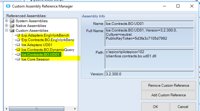

You’ll need to add a reference to the UDxx adapter.
In the customization:
Go to Tools/Assembly Reference Manager
Select Add Custom Reference
At bottom right, select All files (.)
Search for the UD01 adapter: Ice.Contracts.BO.UD01.dll and select it.
See what that does for you.
Joe
@jdtrent
i have added dll of table Ice.Contracts.BO.UD01.dll here the error message is
“The type or namespace name ‘Assemblies’ does not exist in the namespace ‘Ice’ (are you missing an assembly reference?)”
I don’t know if I’m confusing In the customization and BPM? here exactly i use customization!
