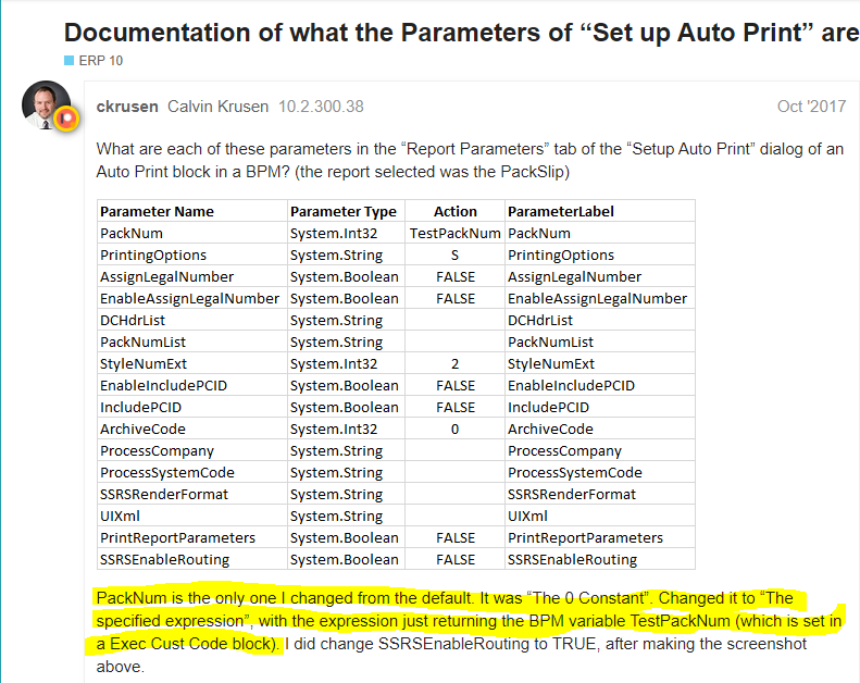

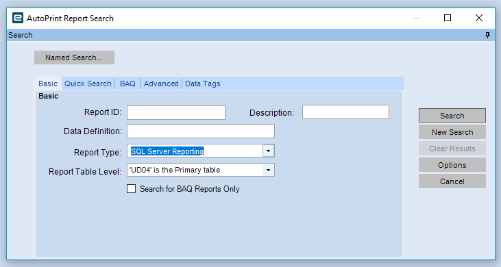

I’ve been trying to follow your suggestion, and I have a question. In another of your posts, you mention that you’d changed the Setup Auto Print > Report Parameters > PackNum field from the default ā€œThe 0 Constantā€ to ā€œThe specified expressionā€¦ā€ but you said it used custom code. For the QuoteHed table, what should this field say? I’ve never set this up before, so I’m learning as I go.
This is the post I’m referring to:

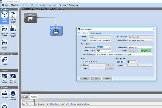

Here is mine, so far:
DMT is running now in Third updating UD04. My plan was to enable the BPM and see what happens once they all load. You don’t have to refresh the data model with the UDxx tables, right?
Is there anything I need to change? Am I doing this correctly at all?

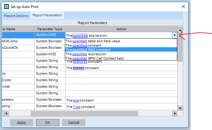

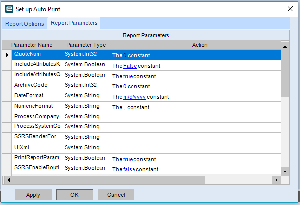

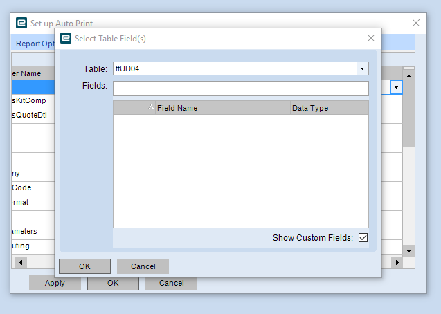

I’m stuck at the most important part - need to link the UD04.Number01 to the Quote Number - I’m not seeing how to do this correctly. I tried to follow your instructions, but I don’t see how to link them.
I believe my error is in the top row QuoteNum - System.Int32 - The 0 constant
Am I supposed to select the Expression option or the Table/Field option? I could not get an expression to work, and when I select the ttUD04 table in the Table/Field options, I get zero fields to choose from:
Which selection do I choose from the dropdown menu? I think I’ve got the rest correct, but this part is catching me up. And thank you in advance for any assistance, I know it’s Friday and you might just have a life. (Not me lol.)
I’m on the east coast and had already left for the day. :stuck_out_tongue:
I think you’re real close. I don’t have access to E10 at the moment, so I can’t tell definitely what to do. But things I’d double check

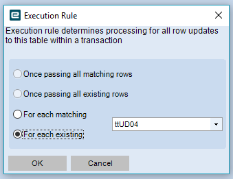

Was the choice in the Execution Rule the default one? Try the ā€˜For Each Matching’ option and then see if that makes the table/fields dialog show the UD04 fields.
If you use the ā€˜expression’ option for QuoteNum, does it show any datasets or tables you can choose from? If not just try making the expression ttUD04.Number01

Try setting that Constant 0 to an actual quote number, just to test the triggering and printing/generating aspects.
Then tackle the part of making the quote number dynamic.
