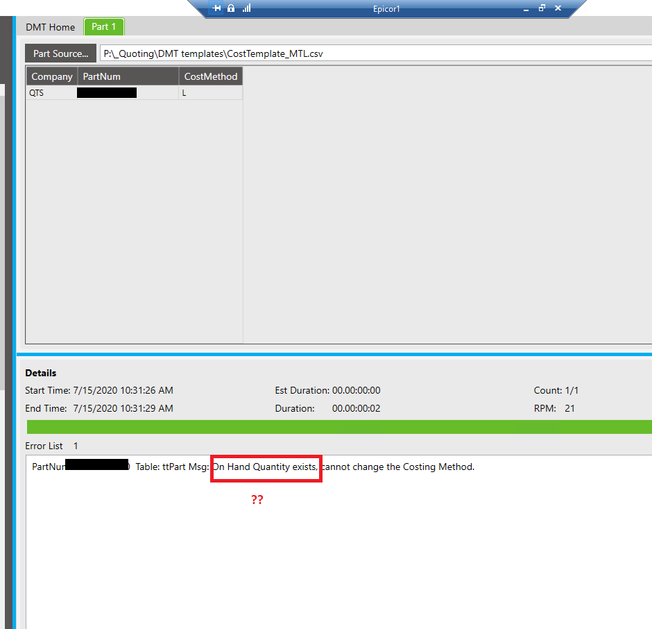

I am trying to update the costing method on a few MTL part numbers:

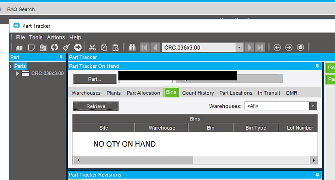

Per part tracker, there is no on hand qty of this part.
However, when I try to update using DMT, it tells me there IS qty on hand.
There is not. What on earth is happening? Help! I am having this issue on a whole slew of parts.

Do you have +5 in one bin and -5 in another bin (for example)?
It might not show on hand, but may be allocated to an order?
Alas, due to a legacy of odd configurations, we only have one bin…Bin A
hmmmm…good point. Thank you I will ck.

I’m sorry I read this fast and didn’t see the pic that already proved that.

I know that in the past we have had issues with the part having an on hand that was 0.00015 and we had to update the decimal places in company configuration temporarily to adjust to zero. Once this was done, I was able to update the part cost from avg to std
