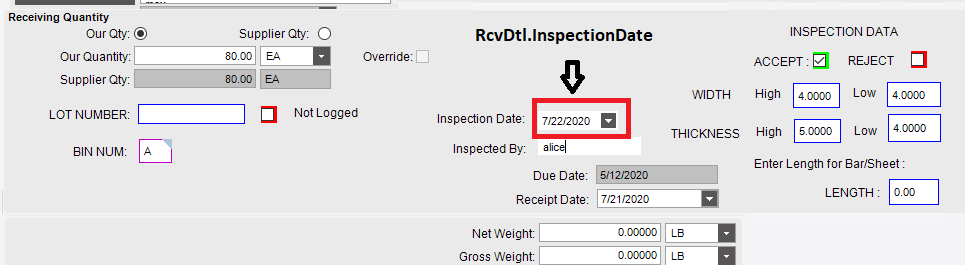

First off, we do not have the Quality module. We have a customization on the Receipt Entry screen that contains 5 UD fields for measurements but also uses the RcvDtl.InspectionDate field to hold the date the user enters the inspection values.

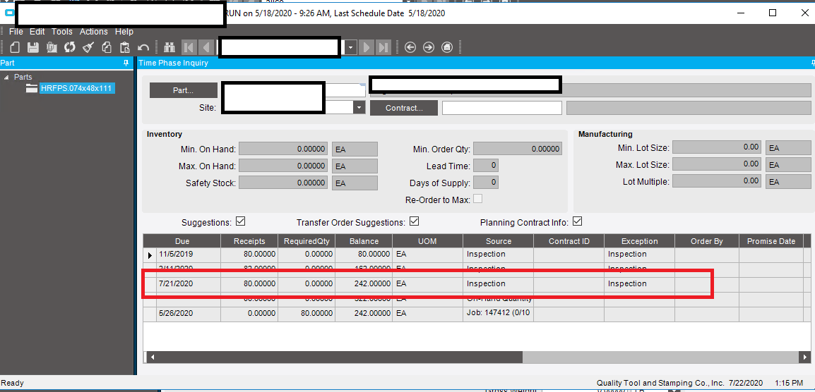

However, I realize that anytime that Inspection date field is used, we are getting a (UNINTENDED) line in the time phase for that part number that says inspection. This is happening for all receipts where a date is entered.

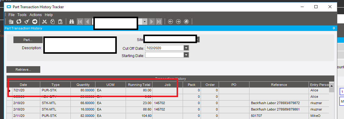

Oddly enough, we never noticed this since the received lines are hitting inventory and I see no PUR-INS lines in tran history (we only have one bin, one warehouse and one site):
I don’t know where to go from here. It looks like, from my testing, that the part gets an inspection line in time-phase the minute a value is entered in RcvDtl.InspectionDate field and once entered cannot be undone. This implies to me that a new record has been created somewhere but I donbt know what table to look in.

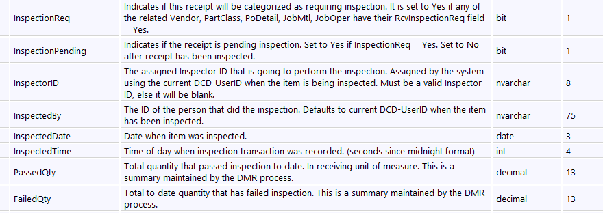

What does the InspectionReq field of RcvDtl look like on these problematic receipts?
Or any of these fields related to inspection…
All have “pending inspection” but none have inspection required. There is no data in the other fields.

The description for the InspectionReq field is:
Indicates if this receipt will be categorized as requiring inspection. It is set to Yes if any of the related Vendor, PartClass, PoDetail, JobMtl, JobOper have their RcvInspectionReq field = Yes.

It ONLY happens when we enter a date into the inspection date field. I agree that the misuse of these fields is causing us pain. Its confusing though, as the “Inspection Required” box is never checked on any of these records. Only “Inspection pending”. Hmmm.
I’d guess that something else normally clears that pending. Do you use the PassedQty and FailedQty fields?

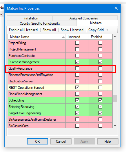

You don’t have the Inspection Processing screen at all in your instance?
No, no QA components. Which I suppose is why we felt safe hijacking the inspection date field on RcvDtl, since we thought it unlikely to impact anything, given that we have no QA module.
Did you check to see if the module was just hidden in Menu Maintenance? I could have sworn that the base Quality module came with Core Epicor. I thought that anyone who had Production had Quality.
Also, are you on one of the versions that has your license info in Company Configuration? You could double check to see if you are licensed for Quality Assurance.

We have Production, but not QA :frowning:
Thanks. That’s good to know. Trying to figure out Epicor’s licensing requires requires about 5 PhDs
Alas, no QA. I did double check in case it was somehow not visible on menu.
