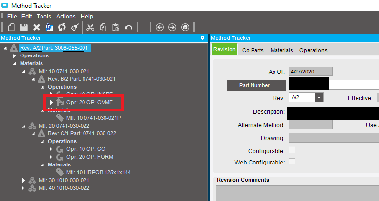

I feel like I am missing some crucial information about how “PO Suggestions” works. I have a weldment part that contains a component part that has an outside vendor step in the routing:
I know that we have both open jobs and future demand for this weldment:
I believe everything is set up properly in the routing, with a subcontract step and “days out” specified:

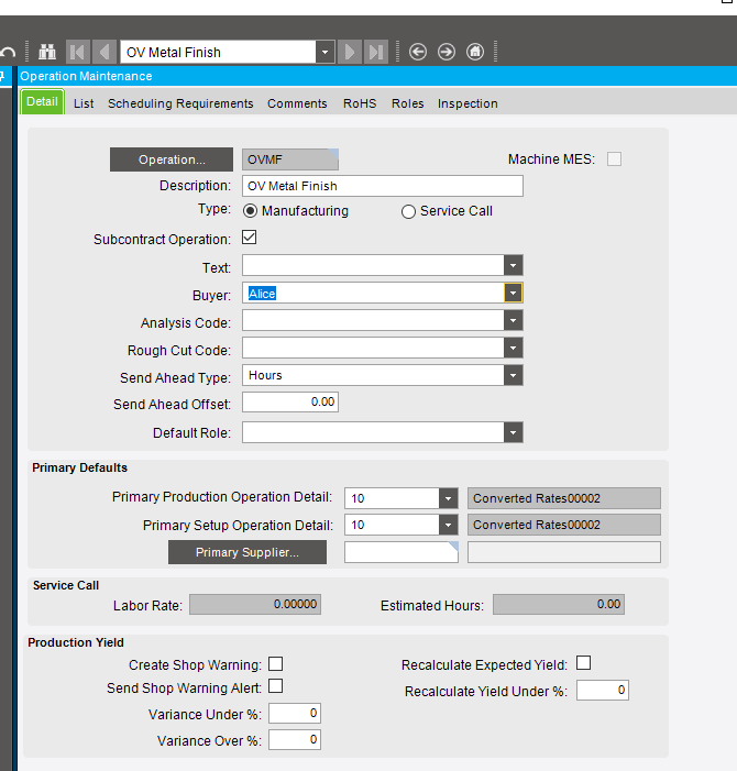

I checked operation maintenance and made sure I was the buyer and that the opeation is marked as subcontract. I did not put a send-ahead value, as I though the “Days out” in routing would specify that…am I mistaken?

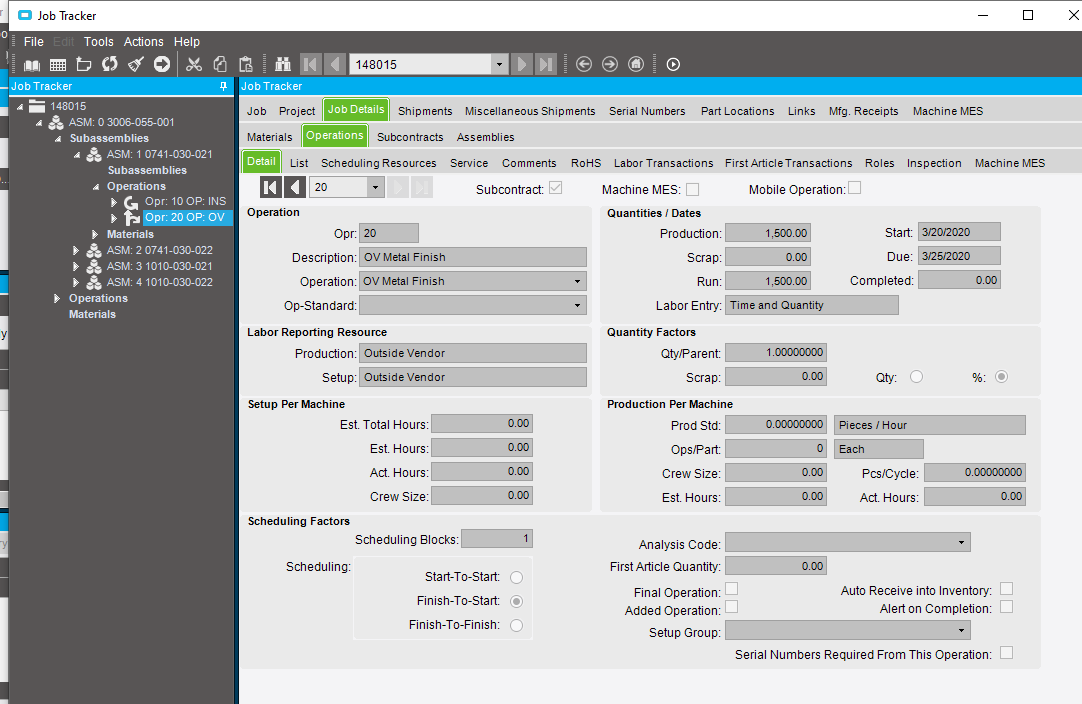

You are correct. Can you provide a screenshot of the Job’s SubContract Operation in Job Tracker? I’m checking to see that the Job Operation is scheduled.
Did you attach a Scheduling Resource to the SubContract Operation in Operation Maintenance?
That Resource needs to be marked as SubContract as well.

This is the Job’s subcontract operation from Job Tracker and it appears to be scheduled:
And in Operations: I don’t think I have the resource assigned correctly though:
The Resource type should be OV and the resource group should be “Outside Vendor”

If you changed the buyer for the Subcontract operation, you need to runas Regen.
Also I noticed that the Start date of the Operation is in the past, you need to make sure that Allow Historical is enabled.
