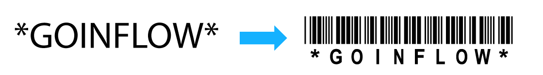

Like said above, barcodes are simply a font… so if you want to have the barcode, and then text, you will need to print the value two times. One in the barcode font, and one in the regular font that people can read.
Something like this:
That font he mentioned breaks it up for you so you can do it in one go.
Pretty sweet.
