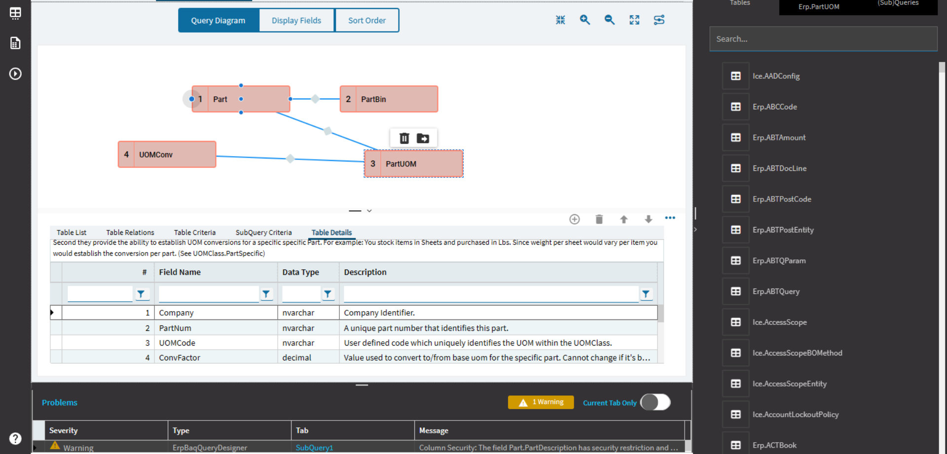

Is there a way to do this? Because I looked in the table and there is no conversion number

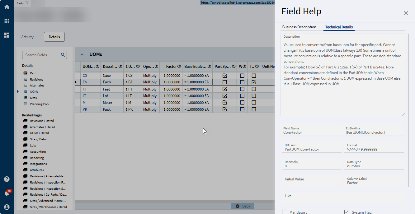

You’re looking for the PartUOM table and the field is ConvFactor. You can see it in Part Entry/Tracker:

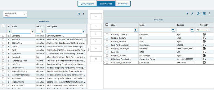

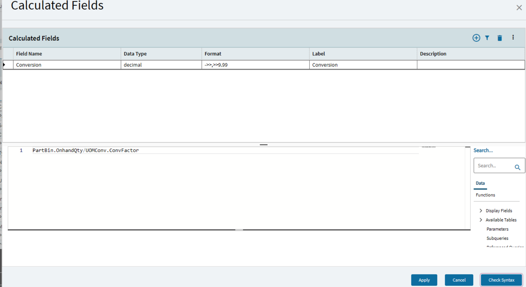

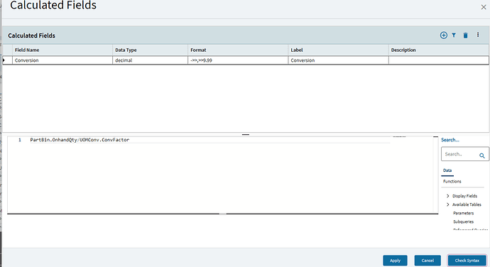

Did I do the right thing?
It looks almost correct, one thing you would need to consider is conversion symbol. Do a case statement if conversion symbol is’/’ then devide otherwise multiple.
I’m confused. Do you have an example?
Different UOMs may require different conversion methods, depending on how your system is set up. In our case, we sometimes need to divide to get the correct UOM conversion.
CASE
	WHEN UOMConv.ConvOperator = '/'
		THEN OrderRel.SellingReqQty / UOMConv.ConvFactor
	ELSE OrderRel.SellingReqQty * UOMConv.ConvFactor
END

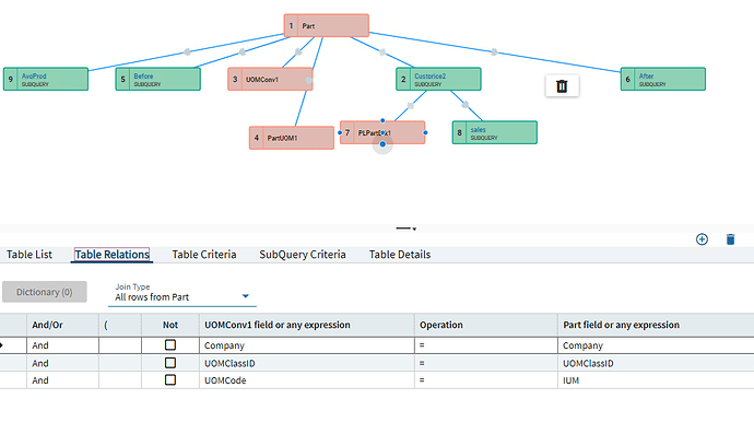

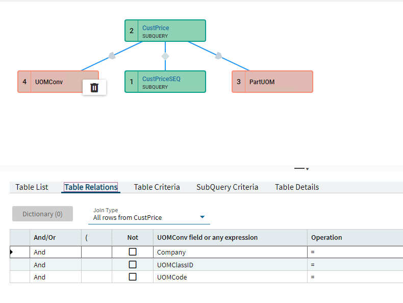

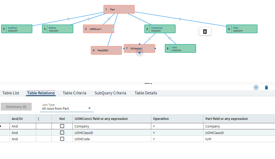

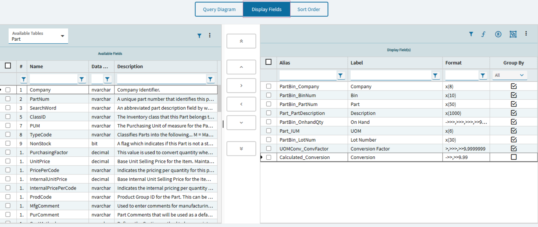

Here is an example:
Getting the IUM from UOMconv and PartOUM :slight_smile:
Getting sales UOM from the customer price list:
Calculated field for the conversion…

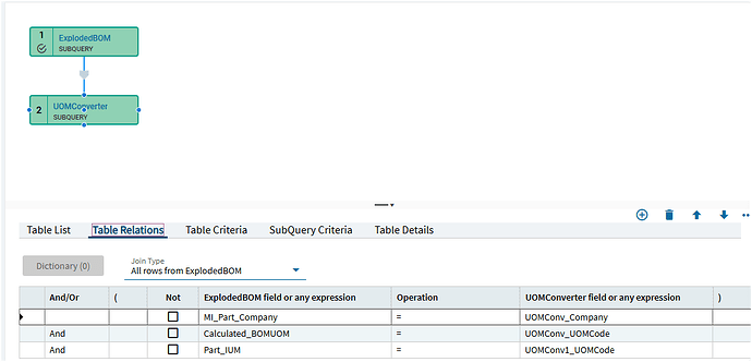

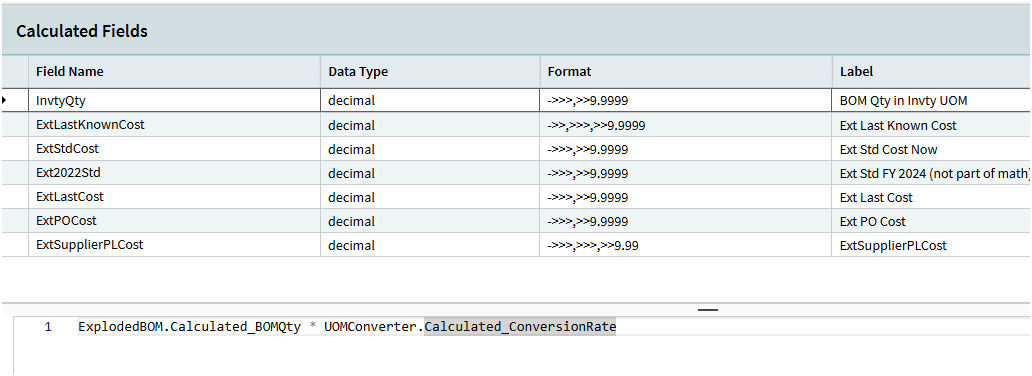

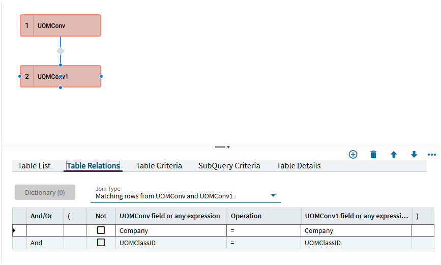

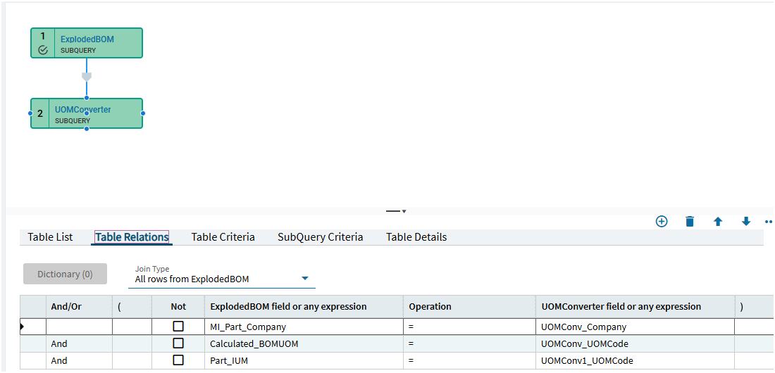

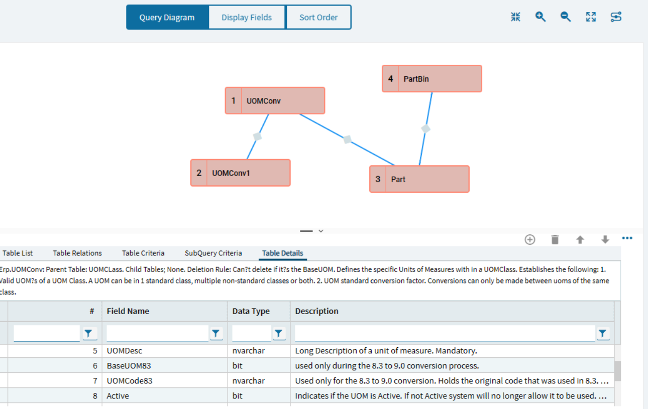

This does not solve all problems, but what I do for conversions is this, in a subquery:
So I make my own conversion table.
Then I join it like so. I joined on IUM, but you might join on PUM, etc.
And convert:
I think it works well.

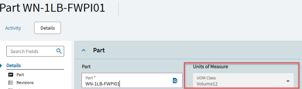

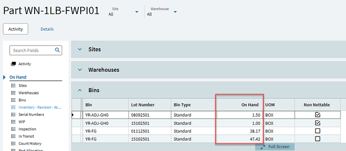

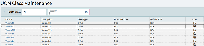

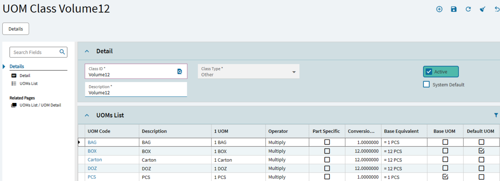

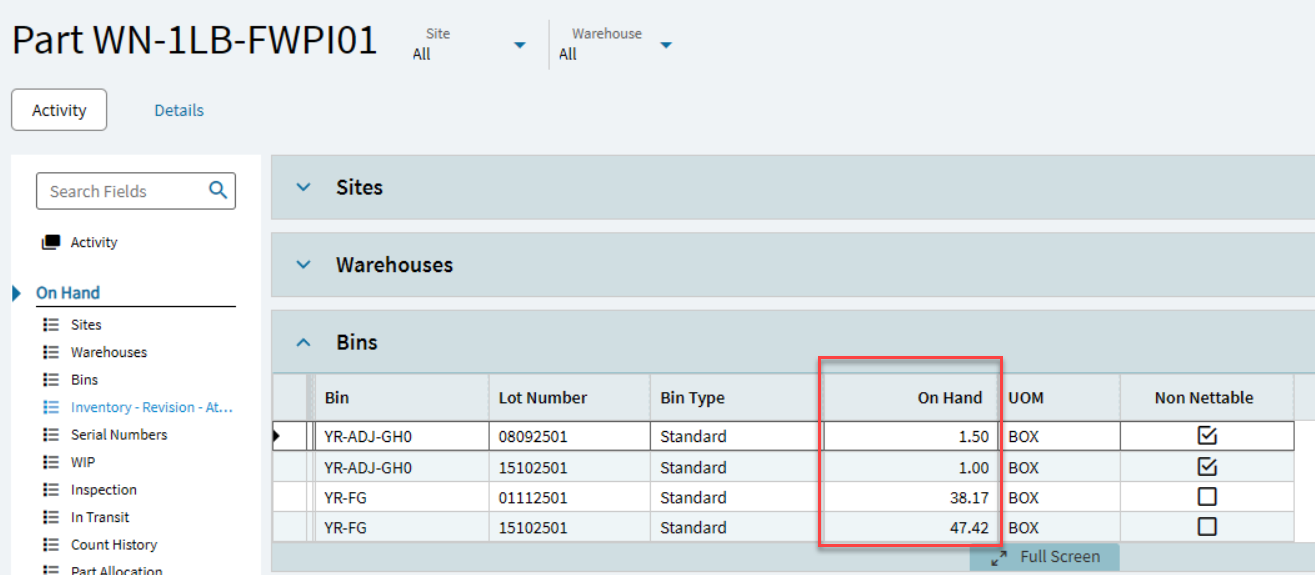

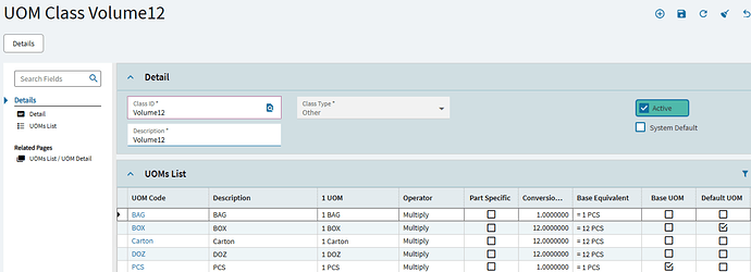

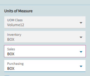

My purpose is to know if, for example, Volume 12, 1 box = 12 PCS, there are 38.17 BOX in stock on hand. I want to do a BAQ to determine the number of boxes in hand = 38 BOX and ? PCS.

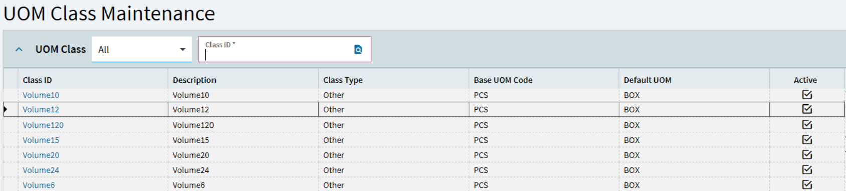

I have many Uom Class.
The method described by @JasonMcD plus a couple more calculations should work to get your full boxes and remainder pcs. Like pseudo-sql:

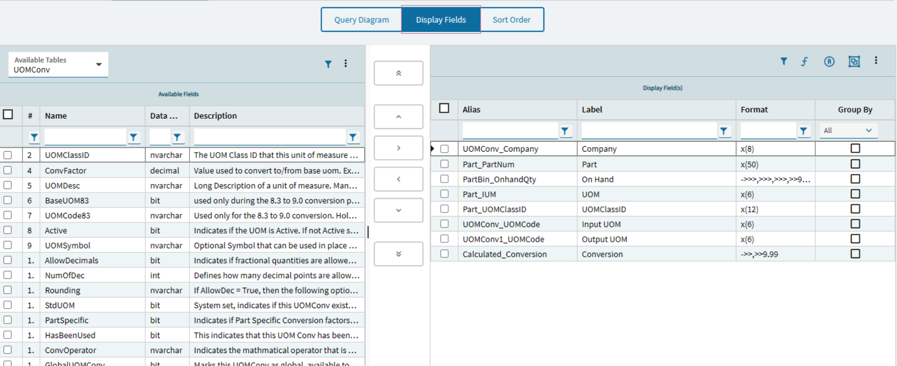

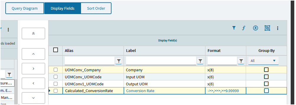

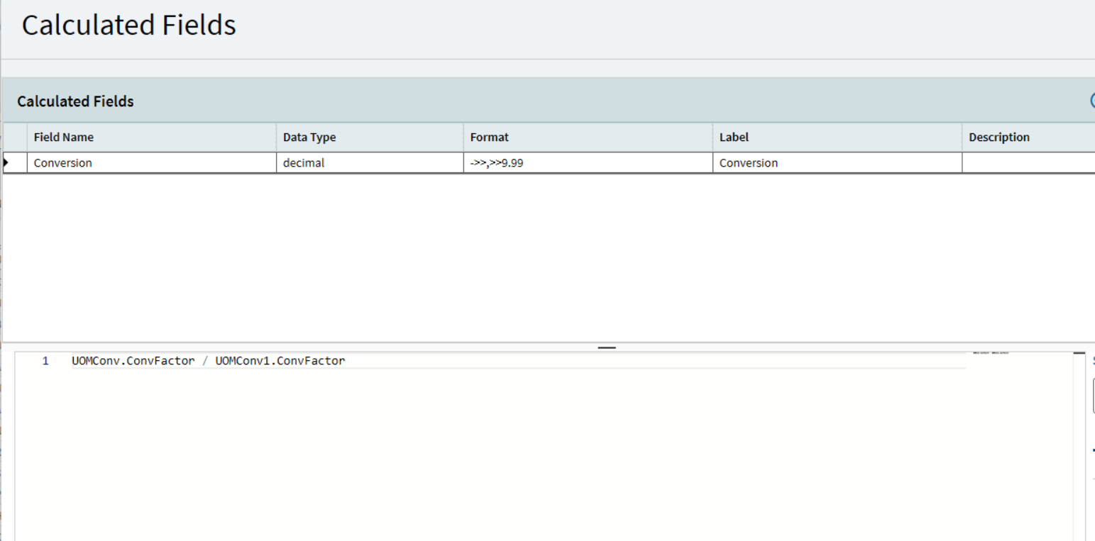

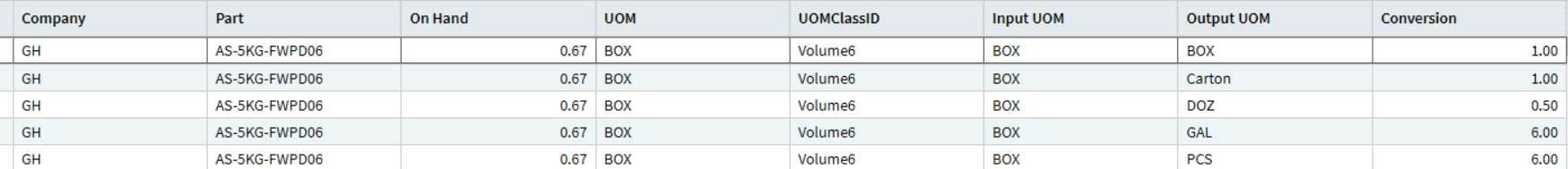

I tried to make the data come out like this.
GH-InventoryUomConversion.baq (9.6 KB)
