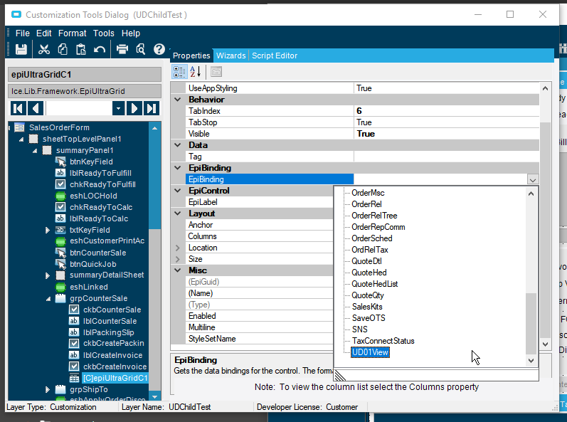

Can you try a test with a clean version first? Looks like this customization was created in 2017. I would like to see if a clean one works.
Also check out this thread on formatting code blocks. It really helps keep things clean in here.
The clean one works. I compared my code to the clean code, it looks like the wizard appended the new code to the frmProc class instead of the Script class. Moving the generate code to the Script class, everything compiles now. Thanks for the help.
Glad you were able to find it. I was looking for a while, but couldn’t figure out what the specific problem was (I’m still relatively new to this code thing)
ok, next problem. I added the tab and an EpiUltraGrid, my UD table does not show in the EpiBinding for the grid. Should it? Or am I doing something wrong.
It should show up. I’m pretty sure you have to save the customization, close and reload it to get the new view to show up. Did you do that?
I have this running, added the UD table as a child table and bound the UD table to an EpiUltraGrid for editing the list. Everything appears to work fine and does what we want. However, the UD data for the order only loads on a new instance of the Sales Order window. If we try to load a another order in the existing window, the UD don’t populate the EpiUltraGrid. Closing Sales Order Entry each time we want to view or edit an order is the only way to get the UD table to populate the EpiUltraGtrid. Any ideas?
