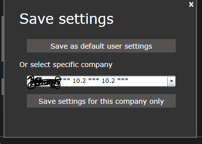

In the Appearance settings, add ability to change color palette per plants
I know we can show the plant on the bottom of a form, but users being users, they still make the mistake of being in the wrong plant writing a sales order.
It would be an more visible added feature to be able to change the coloring in the appearance settings section to save not only for a company, if multiple company, but for a specific plant of that company.

When we save it asks for a specific company… maybe add a the plant choice as well ?
And add the App Environment as parameter for color selection too.
PROD, PILOT, TEST, TRAIN, etc…

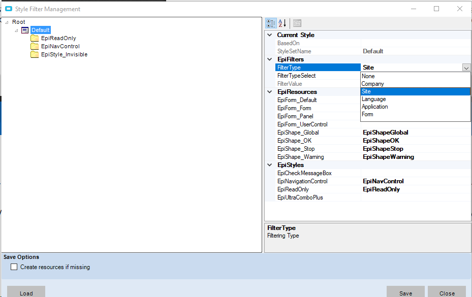

The Run-Time Styler has a filter option for Site
but I’m not sure how the Theme utilities work with the Active Desktop, if that’s what you’re using.

As well as the other things like company name change, I made a theme with a lime green background, and apply it to the TEST.
I made the theme in the live company, so when it is copied to the TEST DB it already exists. I just have to go into the TEST DB and set this special theme as the default.

Could not help myself not looking at this feature…after I noticed I had to set myself as “able to manage themes”.
Well Bingo this pointed me out to the right direction exaclty what I was looking for. The following Youtube video from CodaBears helped me step by step …
setting theme in 10.2
And the result, well if I am in one site, I see my color A, if I change site and open the same form, I see colorB !!!
It is a bit complicated though but looks promising!
