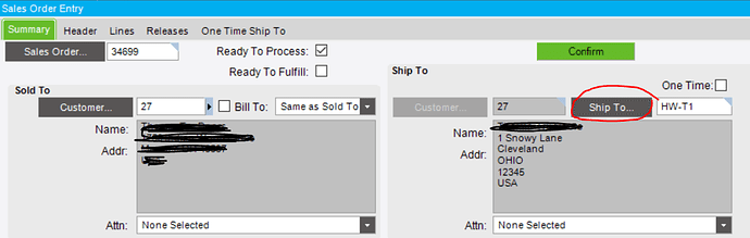

Hello,
I am looking for assistance in making ship to addresses inactive.

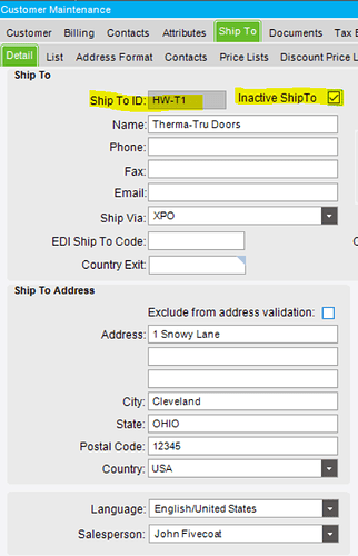

My goal is to set specific ship to addresses on the customer>shipto screen as inactive and then remove them from the ship to search.

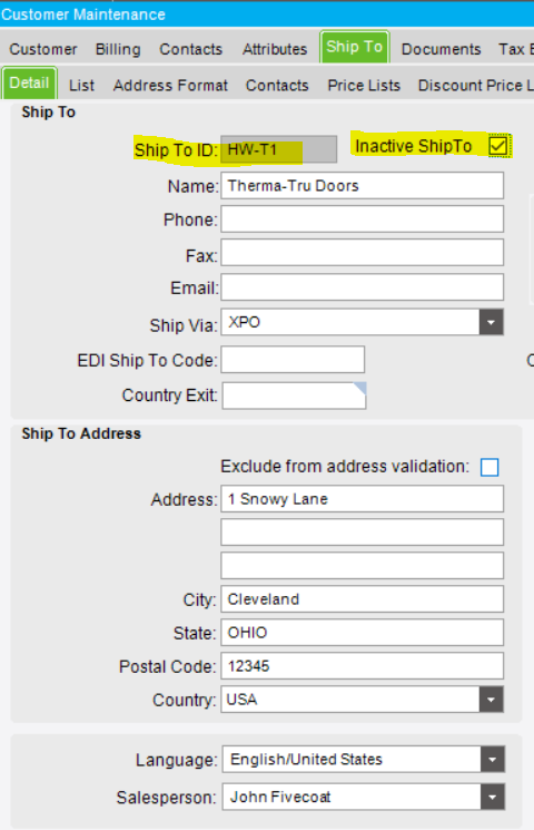

I have created a UD field on the Customer>ShipTo screen and linked it to ShipTo.CheckBox01. If the box is checked then the ShipTo address is inactive.

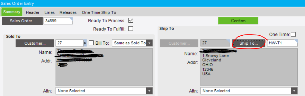

On the Order Entry>Header screen, I would like to click the search and see only ship to address for the specific customer and remove any inactive ship to addresses.

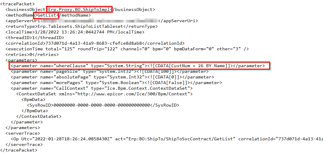

I am new to the trace, but when I click on the ship to button, I think the trace is BO.ShipToImpl and method GetList. There are a few different business objects and methods that it could be: BO.NamedSearchImpl and Method GetRows and/or BO.QuickSearchImpl and Method GetBaseDefault and/or BO.SalesOrderImpl and method ChangeShipToID.
Question 1) What method directive do I change?

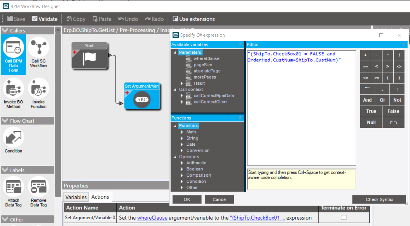

I went to the method directive for BO.ShipTo.GetList (couldn’t find BO.ShipToImpl). In the editor I typed, “(ShipTo.CheckBox01 = FALSE)”. The BPM ran without a server error but it is returning all ship to addresses minus the one I made inactive and not limiting the search to only addresses that are for the specific customer of the sales order.
Question 2) When I clicked the ship to search (on a sales order) before the new BPM it only returned ship to addresses for the specific customer and after the BPM it is returning ship to addresses for all customers. Why? And how do I fix it?

I have attached the trace.TraceData 2022-1-28 test 2.txt (104.0 KB)
So i believe you will need to look up the ShipTo BO and in PreProcessing of GetList update the argument whereclause with my logic of set whereclause = "CheckBox01 = 0 AND " + whereclause

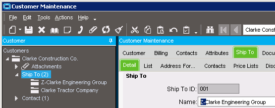

One old method is simple addition of a prefix to the names/descriptions of inactive items. In may case, I add “Z-” to anything that shouldn’t be used but… does not have a native method for inactivating.

I have been trying to read about a whereclause and this is my attempt:
Check syntax and validate are both successful. But when I run the BPM by hitting the ShipTo search button in Order Entry, I get a server error. I have attached the error message.ServerError message.txt (5.4 KB)

That where clause is SQL not c# the code in quotes would need to be SQL syntax.
You would want something like
(string.IsNullOrEmpty(whereClause)) ? "ShipTo.CheckBox01 = 0" : $"ShipTo.CheckBox01 = 0 AND ({whereClause})"
The above checks if whereClause is empty if so it just uses your inactive statement if not then it does that and adds the original where clause back in. You do not need to link orderhed to ship to in the where that’s all done in the background for you. Only add your custom condition of checkbox01 = 0

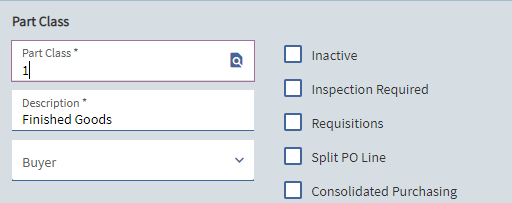

Cloud customers now have the ability to inactivate ShipVia, Part Class and Customers.
Now if they could do the same for suppliers, product group, etc…
Note - you need to launch in Kinetic to see the field.
Cloud Customers can also do a personalization on the classic screens grid view buy unhiding the new “Inactive” field. And the classic screens such as Order Entry when selecting ship via will remove the inactive entry from the list.
