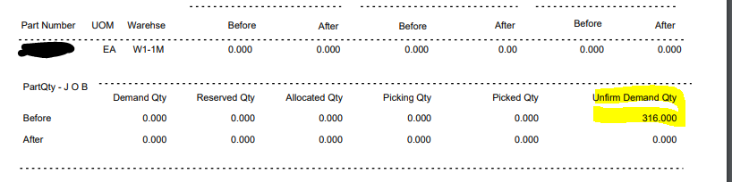

Every time I’ve had that issue, it was the QOH. Please update this if you end up having something else going on here…what about running one of the Refresh Part Quantities on Hand in Pilot - Report Only! and seeing what those results are for that part?
So there is apparently un-firm job demand quantity. So if I run report & update, will that remove that demand and will it affect anything else? There is no real demand. there are no firm or un-firm jobs using this part.
If you look at the second row (“After”) - it gives you what the value will be after running the update. In this case, it looks like it would set that part’s Unfirm Demand Qty to 0, so that sounds like what you want.
Make sure you do NOT run it wide open. Run it for ONLY that part. (I’ve done it wide open accidentally before - what a nightmare.)
That did the trick! Thanks for the suggestion and your help!
