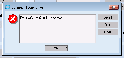

Also, if you do a manual Issue Material, you’ll get:

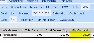

For whatever reason, the Mass Issue window shows the qty I just issued, but it doesn’t apply to the Qty To Isue
Here’s the QOH (from Part Master). The QOH prior to the Mass Issue was zero.
And the Production detail shows the transaction happened.
More info…
In the above test, the part was left as Qty Bearing = TRUE after making it inactive.
After resetting everything (Had to use Mass Return", as a manual return balks at the part being inactive), I set the QtyBearing to False, then did a mass issue.
This time, the mass issue did not create a change to the QOH, and no Part Trans show up on the Production detail.
