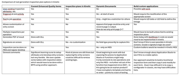

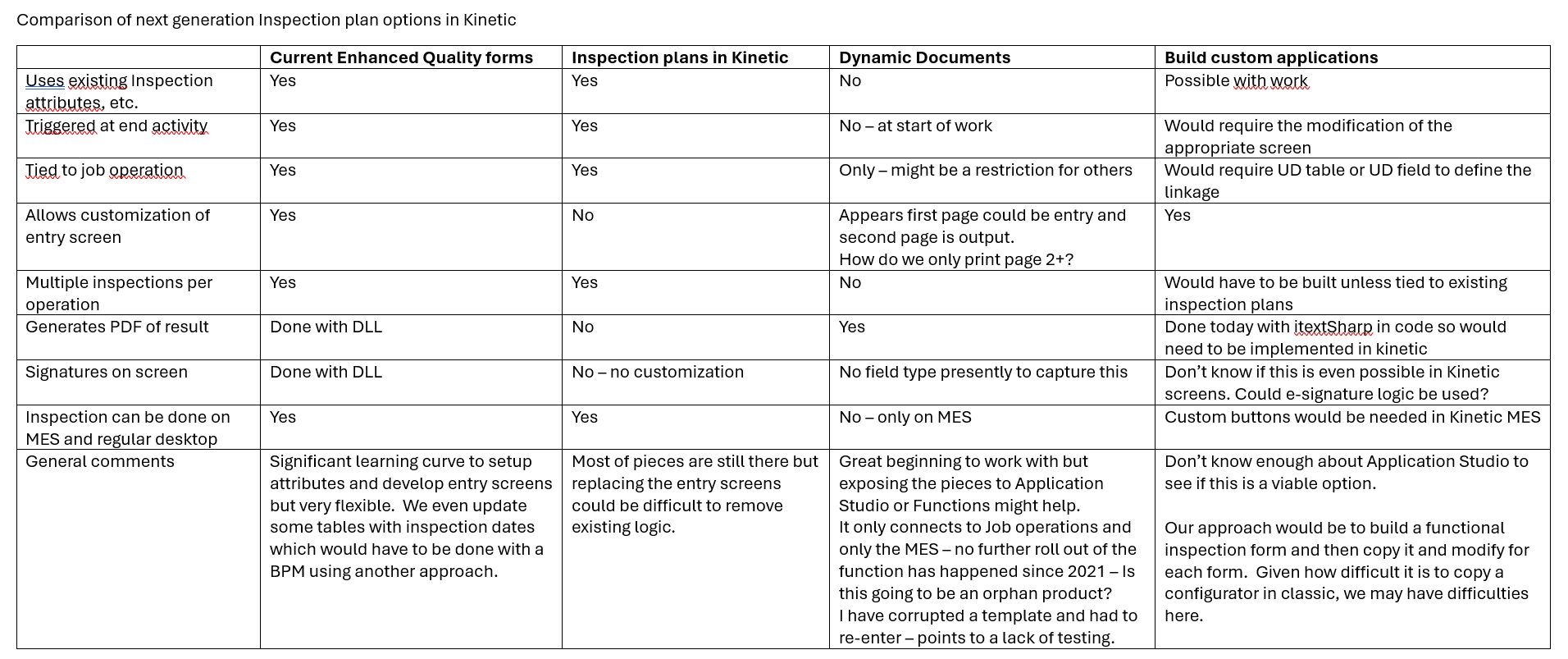

I did a comparison of the different approaches. Some promising developments but the bottom line is there is no path from the classic configurator…
