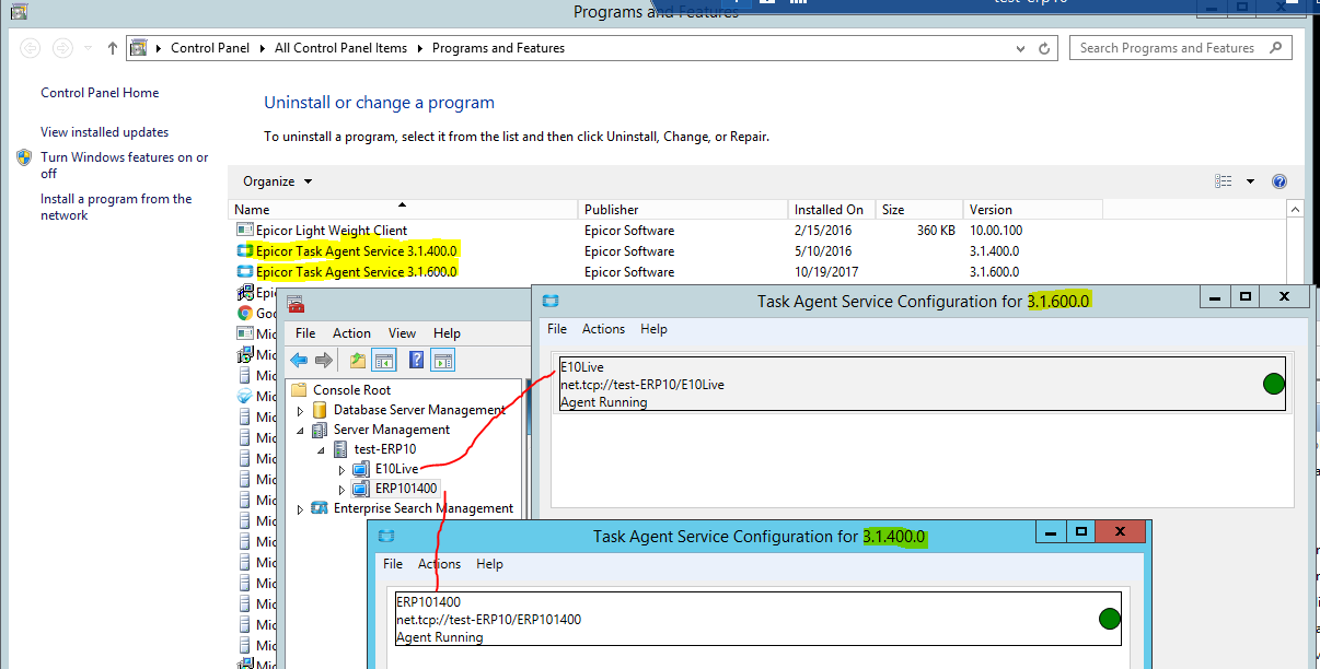

I’m currently testing upgrading from 10.1.400.26 to 10.1.600.13 on our test
server, and interestingly enough I have 2 databases and 2 applications, one
10.1.400 and one 10.1.600, all seems to be working fine. I have both
versions of the Task Agent installed as well, both tied to the correct
Application. Not sure I would recommend it for a Live server, but it’s
handy for my test server for sure!
I have had 400 and 600 running on the same server with no issues at all, but only because of lacking resources. If you have the resources I would follow the recommendations of others and split. If not, you will be fine installing \ un-installing task agents, etc.

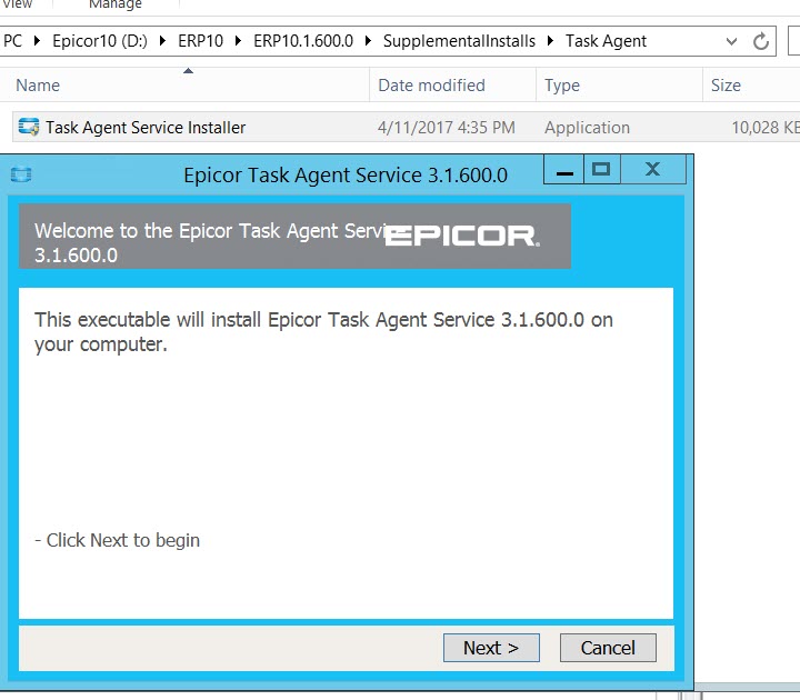

Thanks Norman. Your solution is correct and Epicor Support officially confirmed this with me. You can in-fact have 2 different versions of the Task Agent running on the same server w/o issues.
For reference, just go to the Supplemental Installs >> Task Agent and follow the prompts. At the end it will give the configuration screen for the 3.1.600.0 version. Everything is working just fine in the 2 different environments.

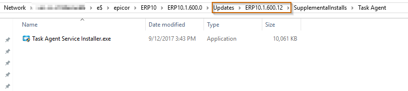

Just to clarify: when installing the Task Agent manually (not from the EAC directly), one should navigate to the updates > [lastest update installed] supplementalinstalls > Task Agent folder to install the latest Task Agent service. The .exe in the base folder is for the base version of the release (10.1.600.0).
