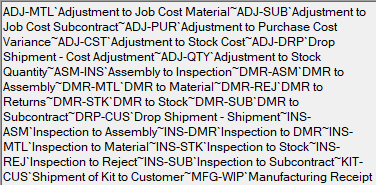

I tried StockProvisionFormat.GetTranTypeList which gets me both the TranType Code & Description:
But again, no idea where the list is coming from.
