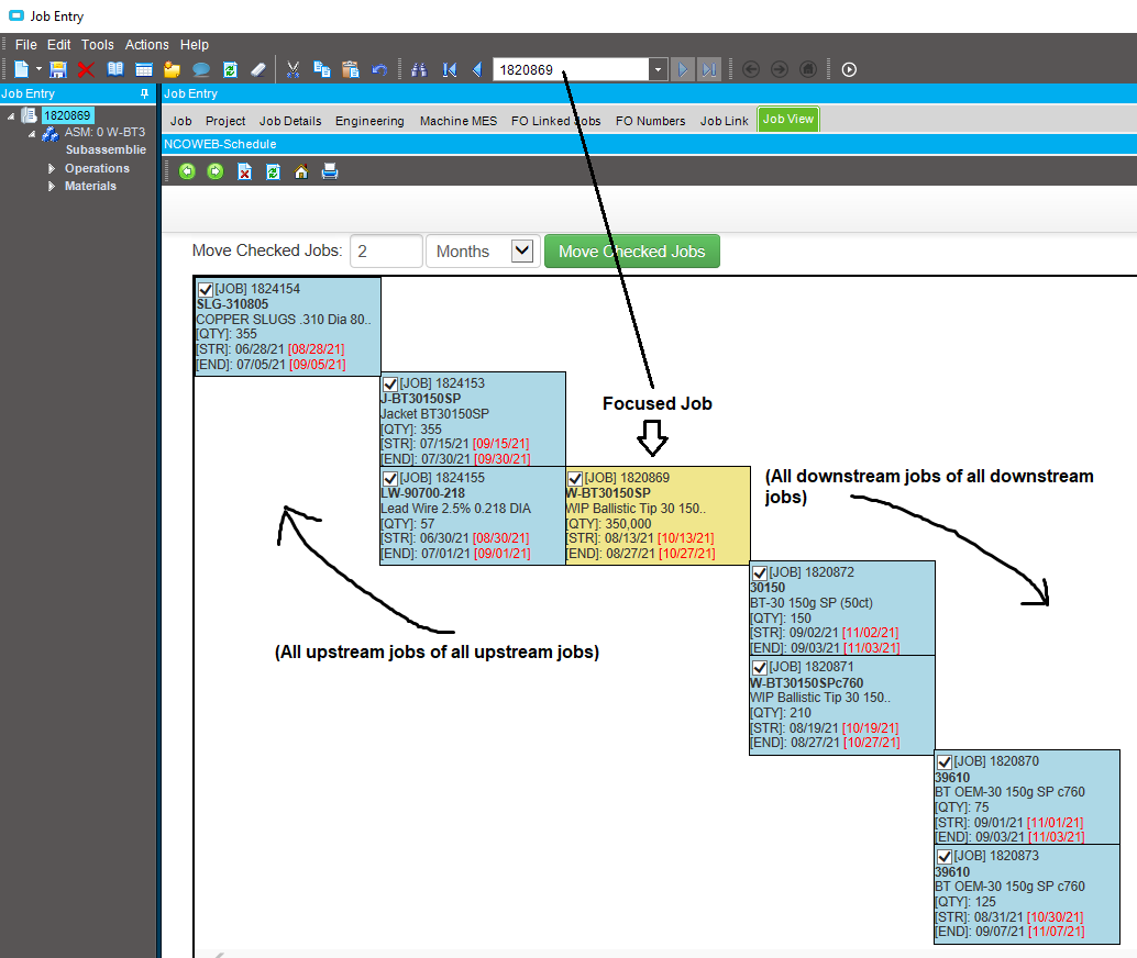

I’m using the UD03 table to hold a relationship between Parent (upstream) and Child (downstream) jobs.
As seen here, with PHP, I can do any number of loops from any focused job in the chain, going both upstream and downstream, finding any and all linked jobs recursively.
[Problem:] I want to be able to give a BAQ one job number in the chain and have it return all the linked jobs so my users can easily load the whole set into the Job Scheduling Board, Job Entry, etc.
Has anyone had luck with recursive loops in BAQs that could have any number of levels? Is it even possible?
Any other creative ideas to the [Problem] above are welcome. (For example, I can easily get the job numbers into a delimited parameter string, but I haven’t been able to get the BAQ to parse it into a selection.)
