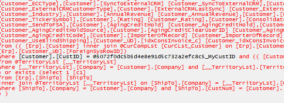

Jeff! Where have you been hiding! I dont know why I kept doing BAQ Reports still… This works almost as identical as a BAQ Report. I do recall you mentioning it before. Shame on me.
Little bit harder to setup because you have to create a RDL from Scratch but in this one I just used “Sync DataSet” and it even brought over my Calculated Field MEOW
The Help File guides you to use Base Definition, so I changed mine to SQL Server Reporting, I could Sync and Output types showed up. Nice!
You can mix also Filters into it and it will be stored in XML Format in RptParams Column UserCriteria, for me Sync Dataset didnt break it up but I found other Epicor Reports that show how to get your param value.
"  CAST(CONVERT(XML,CAST(UserCriteria as varchar(max))).value('UICriteria[1]/RptCriteriaPrompt[PromptName=""LCNRVReport""][1]/PromptValue[1]','VARCHAR(10)') as bit) as LCNRVReport "+
" ,CAST(CONVERT(XML,CAST(UserCriteria as varchar(max))).value('UICriteria[1]/RptCriteriaPrompt[PromptName=""InactiveSalesItemsReport""][1]/PromptValue[1]','VARCHAR(10)') as bit) as InactiveSalesItemsReport "+
" ,CASE WHEN  CAST(CONVERT(XML,CAST(UserCriteria as varchar(max))).value('UICriteria[1]/RptCriteriaPrompt[PromptName=""CalculationMethod""][1]/PromptValue[1]','VARCHAR(50)') as nvarchar(50))='Classes'  THEN 1 ELSE 0 END as CalculationByClass"
