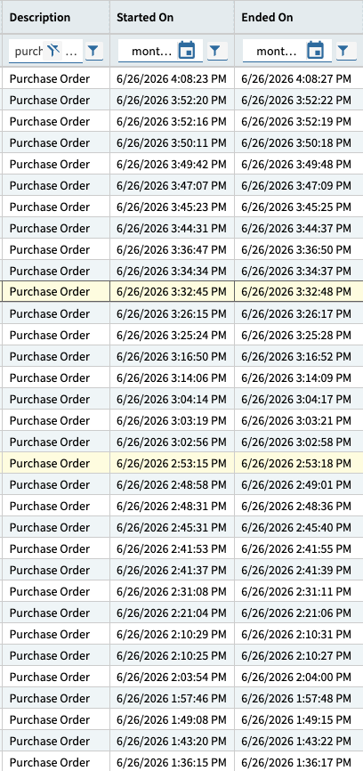

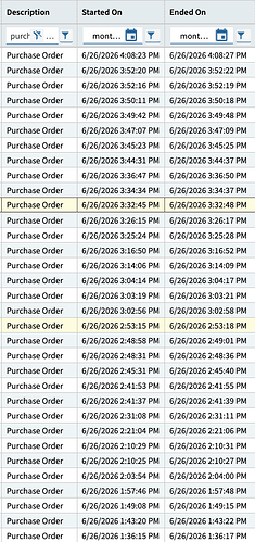

Here are a sampling of some of our print times for POForm. Averaging about 2-3 seconds for POForm without APR, with APR (auto sending email) the print time is increased to about double. So for the longest duration i see here (9 seconds) the total expected time for the print preview to pop up would be <=39 seconds.
OK maybe I am not following your instructions completely, I grabbed your BAQ and reviewing the results. The particular user that mentioned frustration over the report taking more than a day does not show in the BAQ for the past two days. Is there a case in which this report only shows a subset of user interactions or will it show everyone that has attempted to print during the time window I provide?
The BAQ is looking at all records in the SysTasks table, which captures anything scheduled to be run by the task agent, including Reports, Functions, Process Sets, etc. - and captures all companies / all users.
So yes, it should show everyone. Note that the date/times on the filters are server time, so adjust your input appropriately.
I realized my date range wasn’t broad enough to include today. The user did print a few times today all marked complete and within a minute. Not sure where the breakdown was. The BAQ only went to nearest minute can I get it to go down to seconds?

Gabe’s BAQ is showing that these reports start and end are within the same minute and show COMPLETE.
