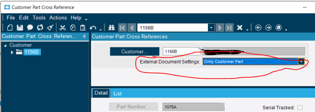

Issue finding CustomerView.CustPartOps field to query
I’m having difficulty finding where the data resides for CustomerView.CustPartOps. It’s the binding for the External Documents Setting in Customer Part Cross Reference. Our customers should be set as Print As Main Reference, but a few are not. I need to find those few and fix them. How can I find the field the data is stored in so I can at least see the customers affected by this?

Running a trace log when saving the record after changing that field shows:
<parameter name="pcCustPartOpts" type="System.String"><![CDATA[S]]></parameter>
Searching the schema for a field named CustPartOpts shows it is a field in the Customer table. The Data Dictionar shows:
edit
scooped by Brad :frowning:
If only I hadn’t taken the time to add the fancy picture … :wink:
