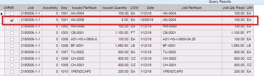

Here’s a BAQ that lets the user enter a Job Num and displays all Part Trans. It also indicates when the material issued was not what the job specified
z-JobPartSub.baq (17.5 KB)
Here’s a screen shot. The highlighted line shows a material substitution. Assy 0, Mtl 1001 had 5 EA of AN-0009 issued, when the job calls for AN-0004.
Edit: here’s the screen shot:

FYI - I threw that together real quick - just to show you what can be done - so it might not cover everything. I didn’t consider multi-level jobs, although I think they’d show up as different Assy#'s
Also, that’s just a BAQ. You’d want to make a dashboard for the users to use. There are threads on here for how to add that dashboard to a screen (like job closing), and link it to the job number on the Job Closing screen (so users don’t have to enter it manually)
