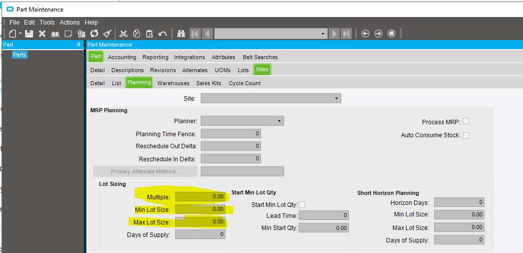

Set the Lot Multiple as 20K in Part Plant record which will create Jobs for 20K each.
Thanks for your valuable reply. May i know where is this part plant option available.
@Arul Thanks a lot.
