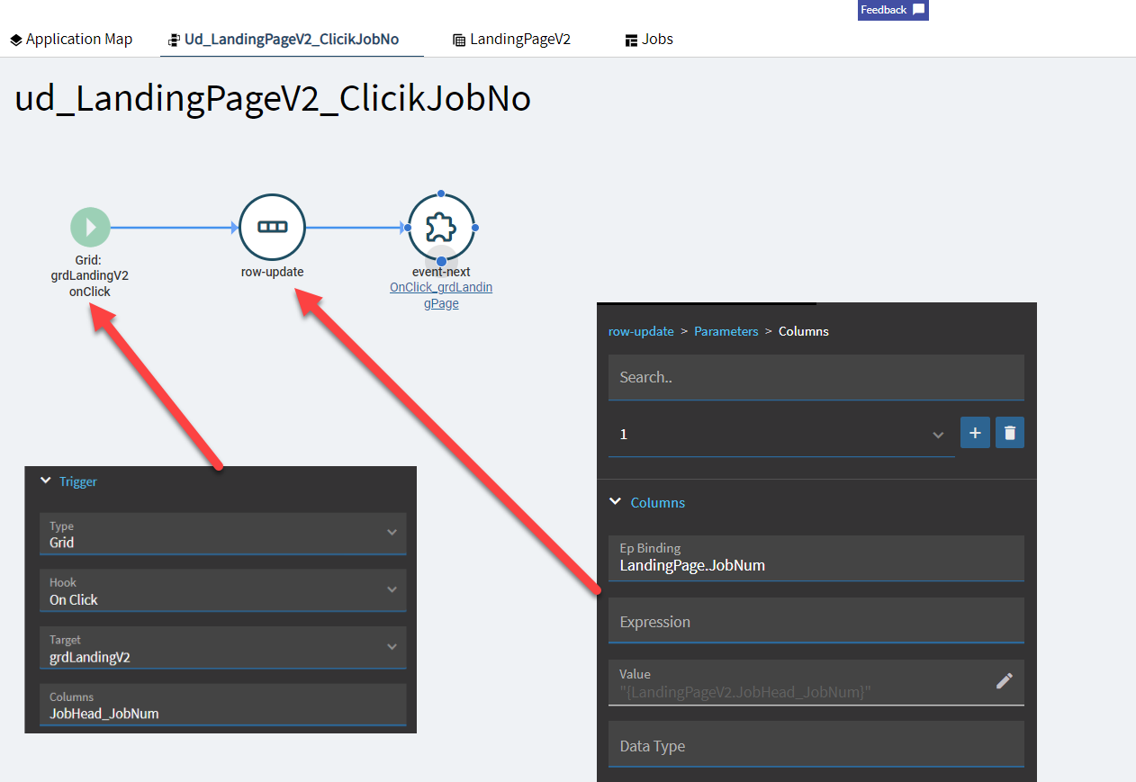

You can replace the landing screen with a BAQ as its data source. Thereafter all you need to do replicate the behaviour of the landing clicking on jobnum field :slight_smile:

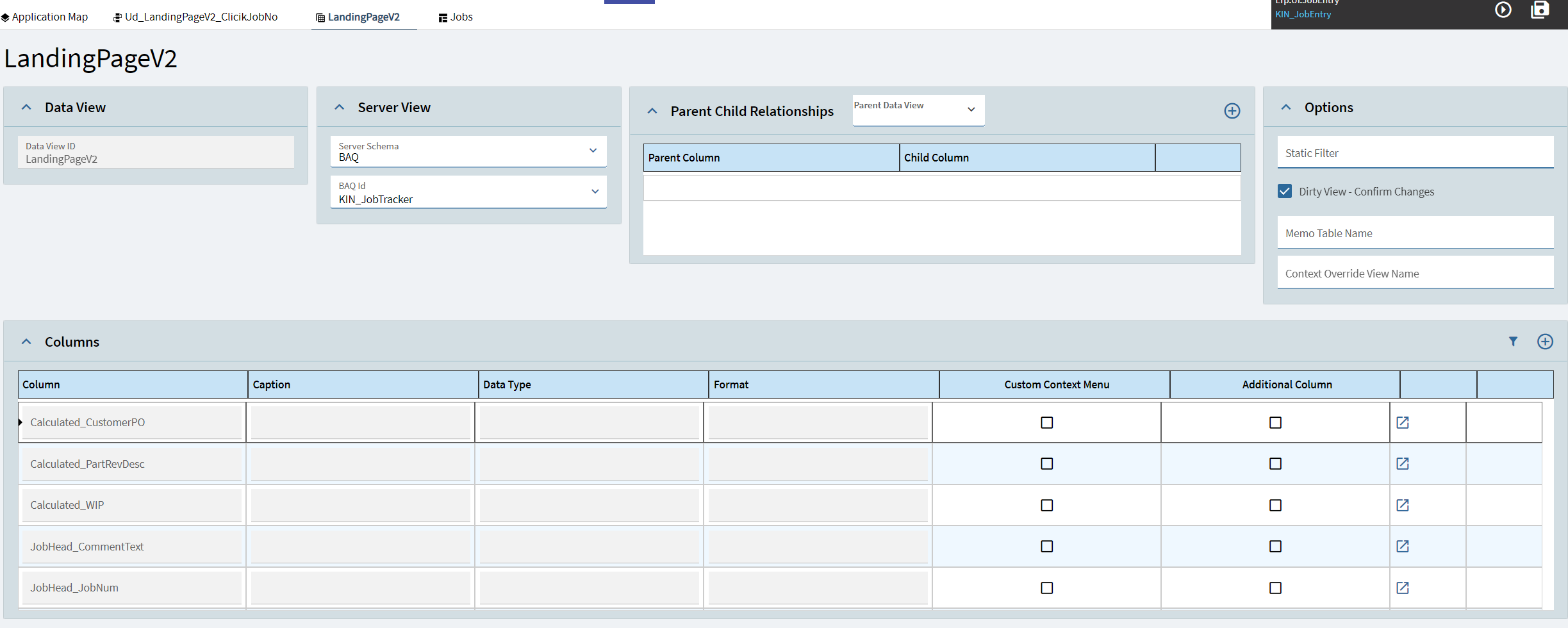

  1. Set up the data view

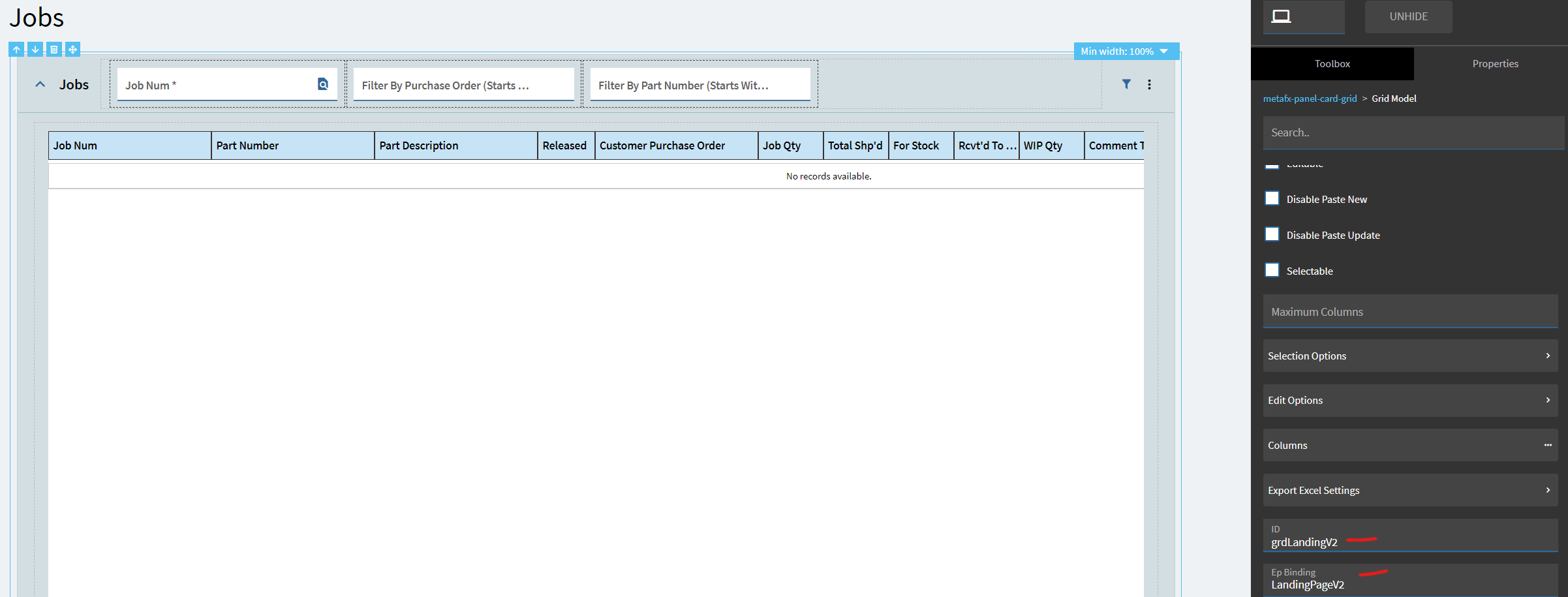

  1. Edit the lading page with binding col etc etc…

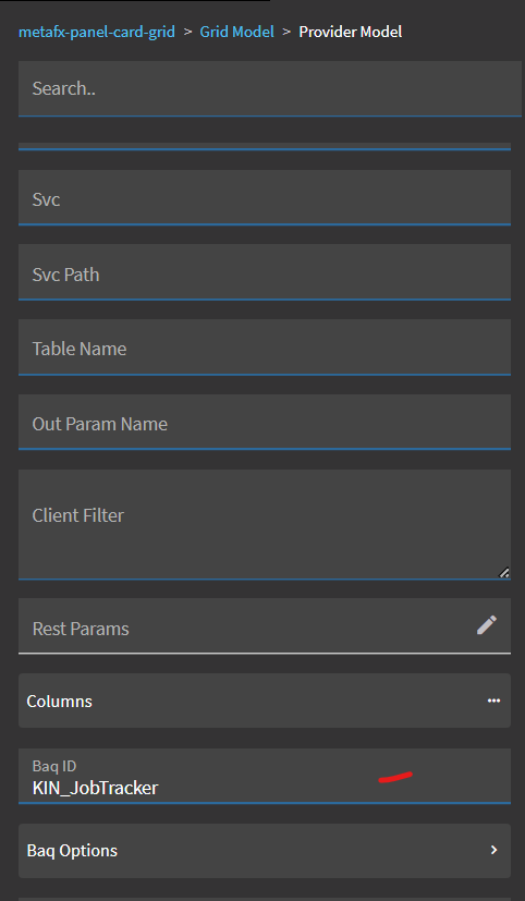

  1. Set the grid provider model

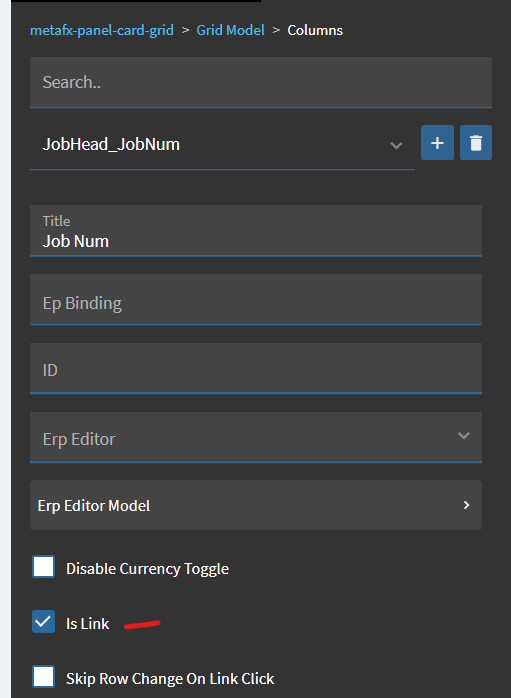

  1. Check “Is Link” in the Job number col
  1. Set up an event to get the ball rolling with the BAQ as the datasource

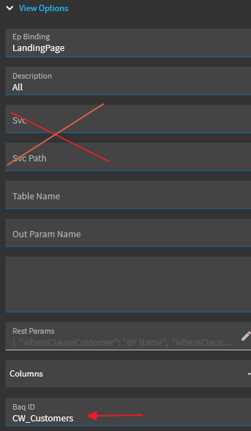

Don’t forget also to adjust the View Options if there are any to use your BAQ (UPDATE: No don’t do this), eg
No that didn’t work, it appeared that setting the BAQ on the view resulted in the dataview linked to the grid not being populatred; like the view was masquerading as a dataview itself, so the onclick did not work.
If I remove the views altogether it works though, and if I put in views just make sure neither BAQ nor Svc/Svc Path is set.
