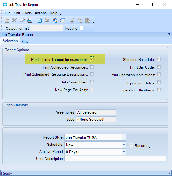

You’re probably doing this, but in case you missed it, I thought I’d bring it up… do you have this checked on the traveler print dialog when you want the Mass print to occur?

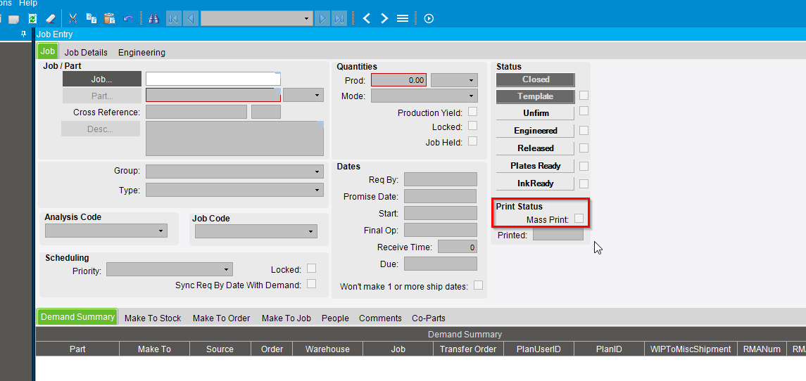

When you mass print the filter isn’t used for anything. Any job with the Mass Print checkbox checked in job entry should print as the default functionality.

  1. Open job entry
  2. Enter a job, set mass print, save job.
  3. Repeat 2. on a few other jobs
  4. Open Job Traveler. Select “Print all jobs flagged for mass print”
  5. Print or print preview.
It only prints the first job selected. That’s it.
