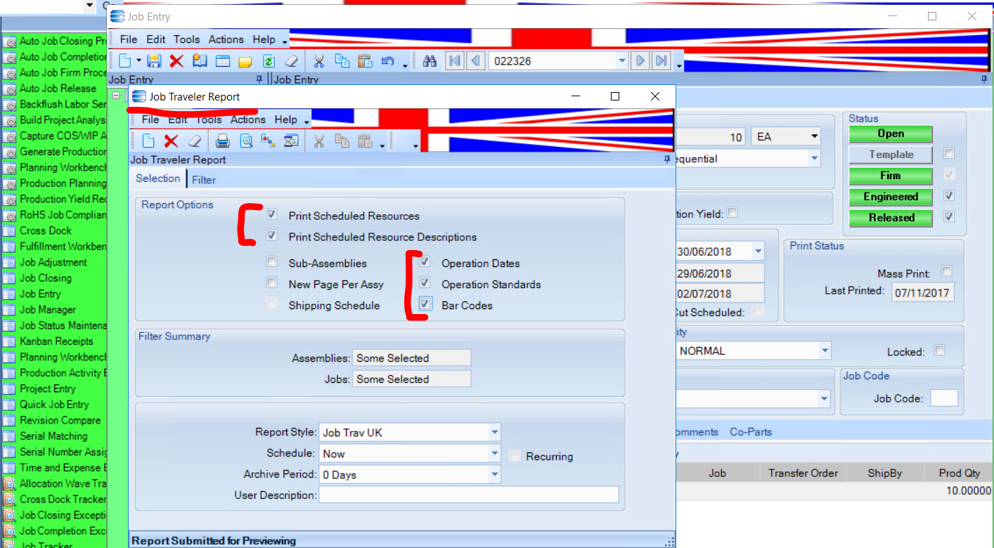

Task: When running Job Traveller Report from Job Entry i’d like the below checkboxes to be defaulted to true.
Question: Is this a form customisation, can each user do it via a personalisation or can a bpm do it?
Many thanks in advance.

Users can set/save the options they want, the under Actions click Save Defaults. @Rowley150
Rowley150
(Mark Rowley)
July 16, 2018, 8:36pm
3
this works perfect for job entry / print job traveller…thank you.

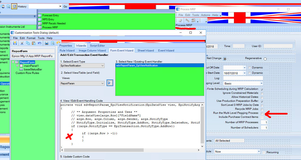

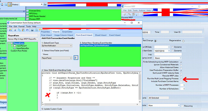

I was hoping it would be similar for the process MRP screen but sadly although the “save changes” option is there, it doesn’t appear to work. I was hoping to default multi level pegging to true.

You can do this with a customization quite easily if Save Defaults doesn’t work.

I put the below post up, …im just not sure of the syntax to type and where exactly to place it.
Epicor version 9.05.701 Task: I want to default “Run the multi level pegging process” to true when processing MRP. (Field Name: RunPegging EpiBinding: ReportParam.RunPegging) What is the code to type into part 4 (view / edit event handling...
