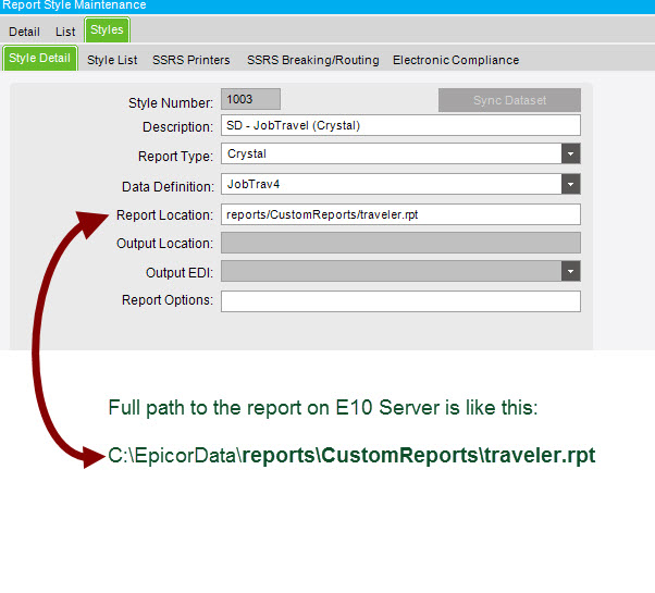

Keeping Crystal Reports in V10
Finally got the correct directory so that the application can find the .rpt files.
I had to create a CustomReports directory inside the reports folder, which was confusing because the Reports folder normally just contains report data from users when they run a report.
hope this helps someone
