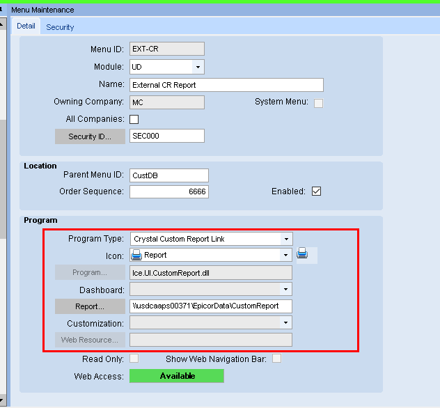

You have to add the reports as a menu item in Menu Maintenance. Your menu item would look something like this.

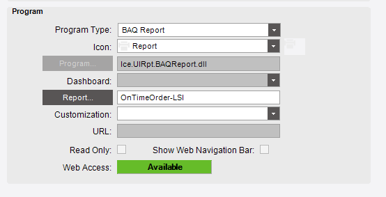

Our program type is BAQ report.

All I did was make a Menu entry as follows:
With the “Report…” field set as
\\usdcaaps00371\EpicorData\CustomReports\e10H-External_CR_Report.rpt
I think the tricky part is knowing the reference for the path.

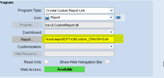

The following also worked:
Because i didn’t make a network share, I had to use the full URL with C$ for the c-drive
\\usdcaaps00371\c$\Custom_CR\e10H-External_CR_Report.rpt

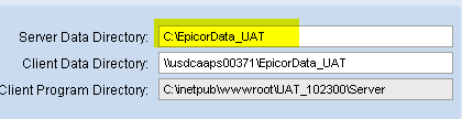

I think the Original poster wants to know how to have a separate “CustomReports” folder (for crystal based reports) for their Test Environment.
What the OP can do is set the Server Data Directory in System Agent. The following is for our TEST environment.
That way the Report Style entries can still be reports/CustomReports/MyCustCrystalRpt
But the actual RPT file used is in \\appserver\EpicorData_UAT\CustomReports\
Calvin,
Yes I believe that is what we want. Thank you !!!
Carol
Just an FYI - That Server Data Directory setting can affect A LOT. Pretty much anything that is stored in there - which depending on your setup, could include Attachments.
