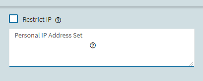

I am not sure if this would work as I’ve never tried it, but you could try Restricting the IP Address of the MES accounts on User Account Security.
If you do try or if anyone else has done this let me know how it works for you.
THANK YOU! I was wondering if this was a possibility… And since it appears that it is I can lock down our MES user to only be able to login from our two IP addresses.

I’m liking the potential option to locking down a user to only sign on from a specific IP address. That may work out well for our MES account, but we’ll see.
okay so I’m not crazy suggesting this… glad to know someone is doing it.
