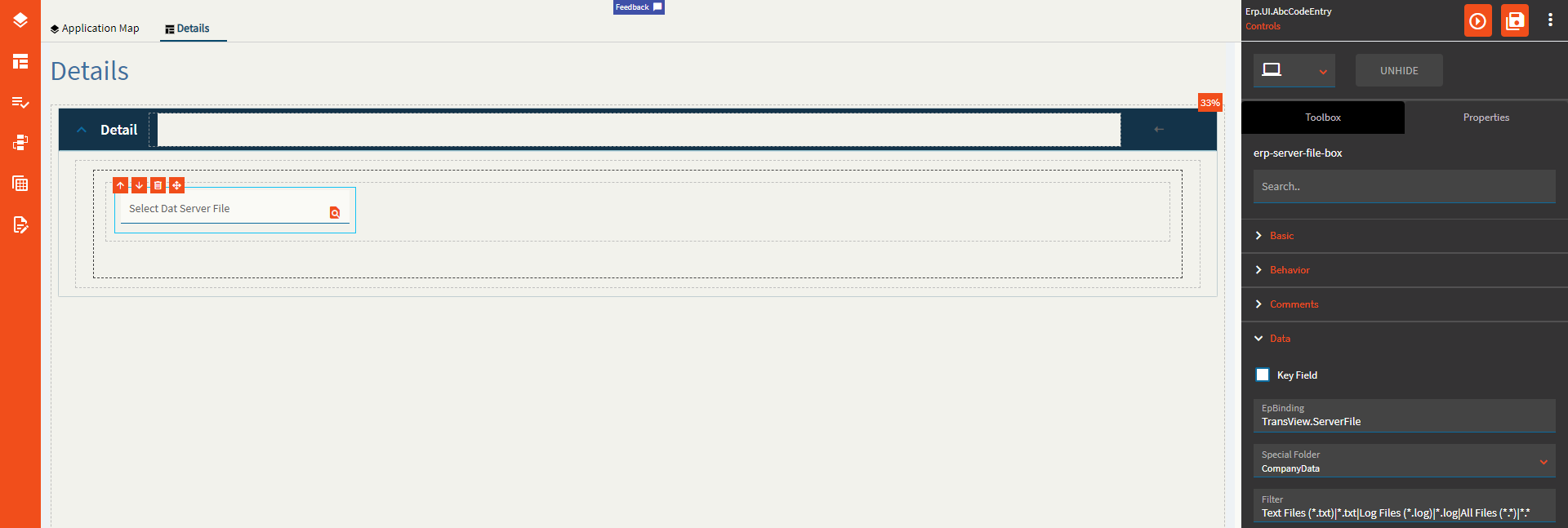

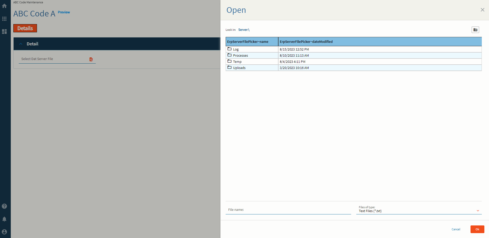

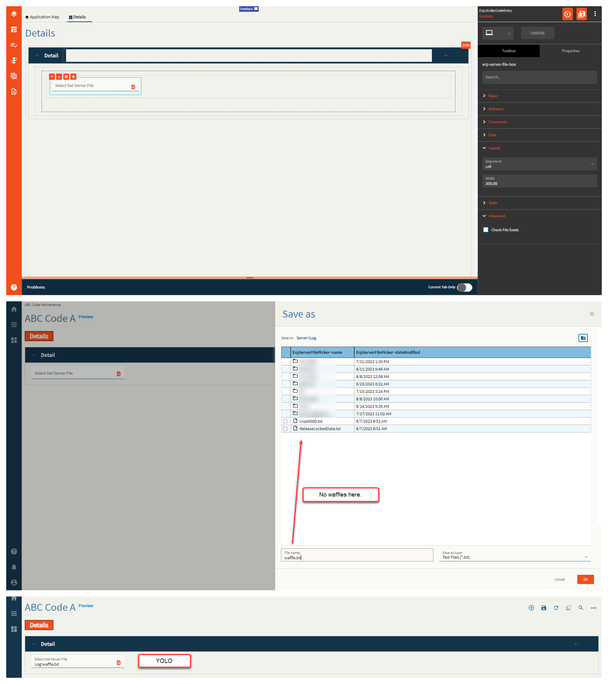

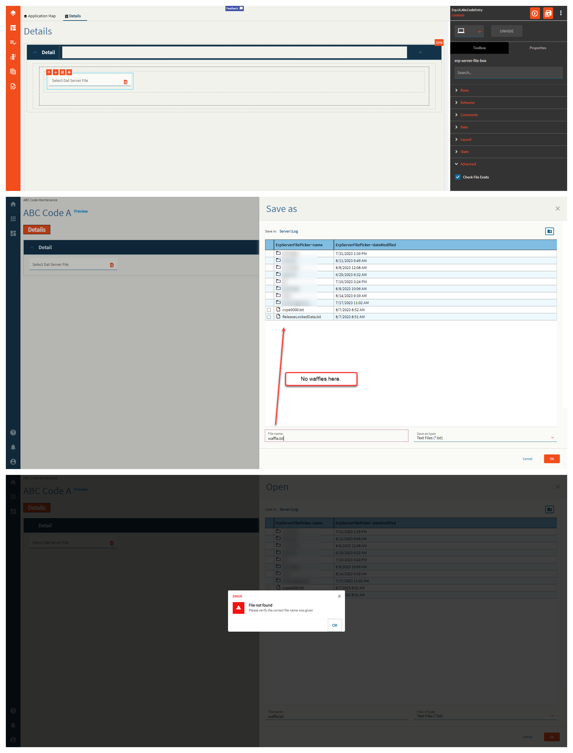

File Picker Server
Allows a user to “select” a file form the server. I say “select” in quotes because this does not bring the file down. It only binds the path to the data binding fields. You will need to use an event with the erp-file-transfer widget to move things about.
I don’t know what I’m doing.
Property Group Properties Description
Basic Id Unique identifier for the control

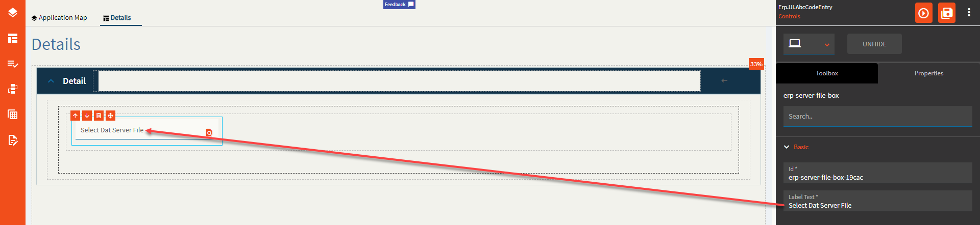

Basic Label Text Sets the label within the control. (Fig. A)
Behavior On Blur Click this to create an OnBlur event for the control. On Blur is triggered when the control loses focus.
Behavior On Create Click this to create an OnCreate event for the control On Create is triggered when the control is painted to the GUI.

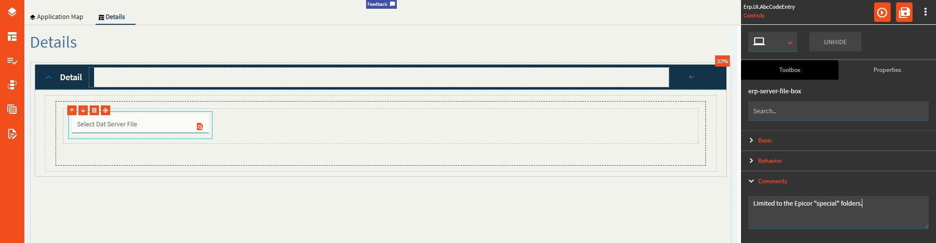

Comments Comments Add some developer notes to the control. These are not customer-facing and are only visible in App Studio (Fig. B)
Data Key Field Indicates that a bound component is a key field. If true, the field is enabled if there is no current record, allowing the user to select an existing record or create a new one.
Data EpBinding Bind the button control to a DataView.Column. I wonder how many times I’ve copy+pasta that wrong. :thinking:. This will store the file name and partial path such as Log\LogTextFile.txt.
Data Special Folder Server folder that should be navigated to in order to select files. Valid Options Include: Report, WebDeployment, ReportDefinition, CustomReportDefinition, UserData, CompanyData, EWADeployment, and Attachment. (Fig. C)
Data Filter Filters to be added to the file selector type. Format: Text Files (*.txt)|*.txt|All Files (*.*)|*.* In plain words Description|WildCard.FileExtension (Fig. D)

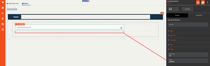

Data Binding File Name Binding to store the relative file path such as C:\EpicorData\EpicorKineticGold\Companies\C001\Log\LogTextFile.txt (Fig. E)

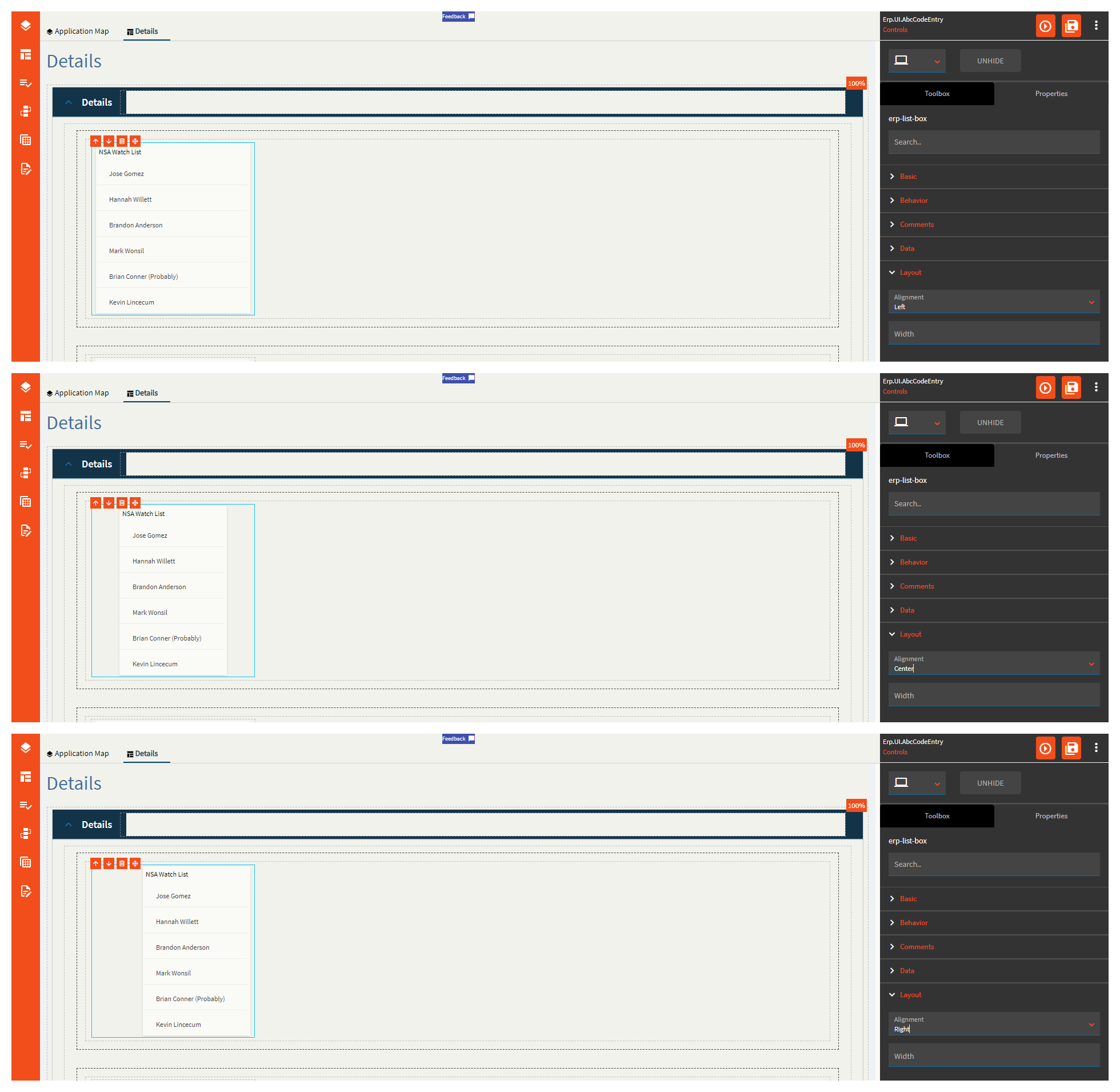

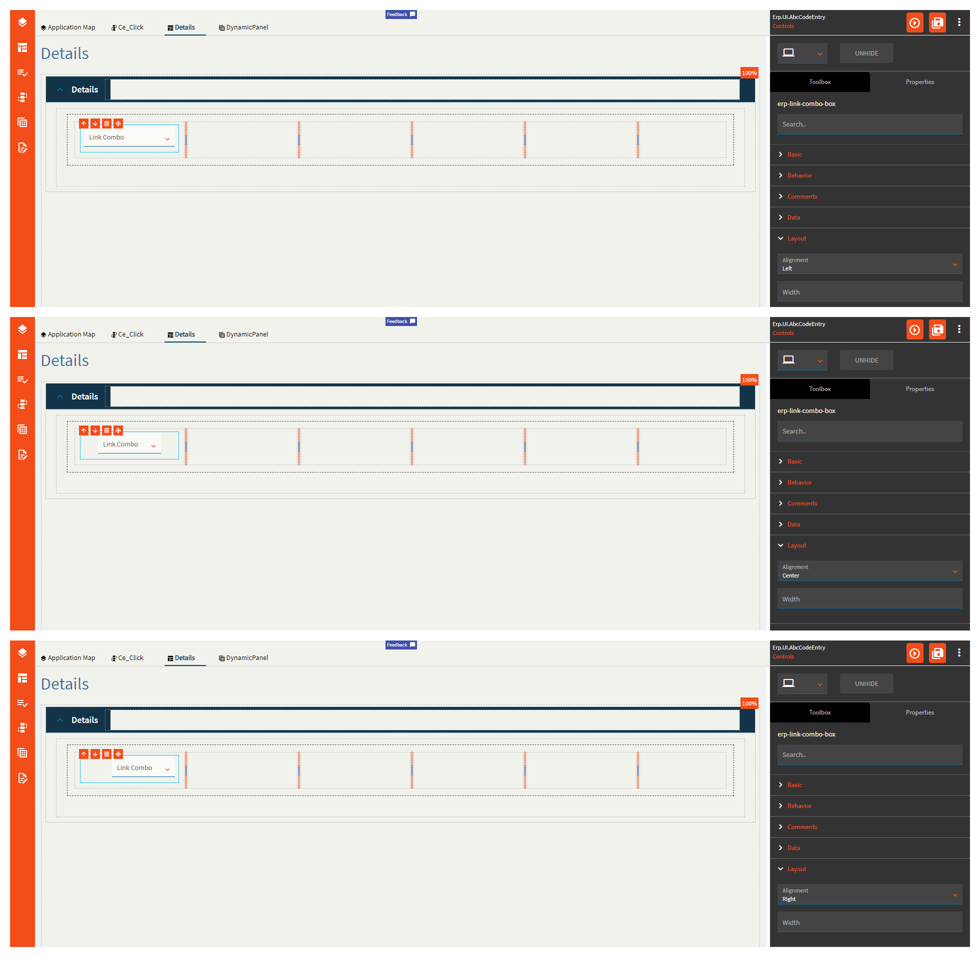

Layout Alignment Set the alignment for the control. Valid options are Left, Center, Right. (Fig. F)
Layout Width Sets the specific width (pixels) for the control. (Fig. G)
State Personalizable If true, a user can personalize this component(hide/show)
State Customizable If true, a user can customize this component in child layers
State Hidden Hides the control from view.
State Disabled Disables the control. The control will not allow editing or focus.
State Read Only Makes the control read only so that it will not allow editing. The control can still be focused.
State Auto Focus When enabled, the control is automatically focused on creation.
Advanced Check File Exists If this is false, you can type in whatever you want in the file name box from the slide out and it will accept it as truth. If enabled, this will check if the file actually exists and sternly yell at you if it doesn’t! (Fig. H)
Figure A: Label Text
Figure B: Comments
Figure C: Special Folder
Figure D: Filter
ServerFileFilter
Figure E: Binding File Name
Figure F: Alignment
Figure G: Width
Figure H: Check File Exists = FALSE
Figure H: Check File Exists = TRUE

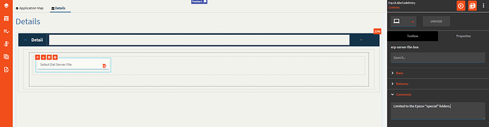

File Server Folder
Allows a user to select a folder from the server. And by “select” I mean it just puts the name of it into the binding.
Property Group Property Description
Data EpBinding Bind the control to a DataView.Column.
Layout Alignment Set the alignment for the control. Valid options are Left, Center, Right. (Fig. C)
Layout Width Sets the specific width (pixels) for the control. (Fig. D)
Advanced Special Folder Root Folder to display subfolders in. Valid Options Include: Report, WebDeployment, ReportDefinition, CustomReportDefinition, UserData, CompanyData, EWADeployment, and Attachment. (Fig. E)
Advanced Disable Validation :mag_right: Validates the folder still exists on the server on click of OK. This doesn’t work.
Figure B: Comments
Figure C: Alignment
Figure D: Width
Figure E: Special Folder

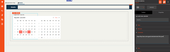

Comments Comments Add some developer notes to the control. These are not customer-facing and are only visible in App Studio (Fig. A)

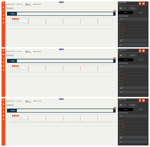

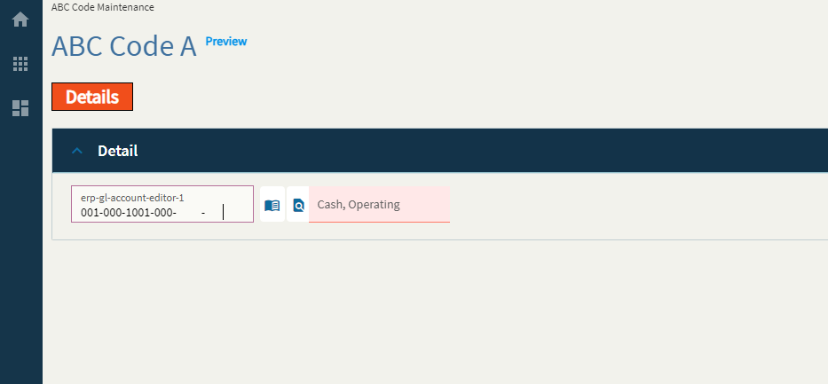

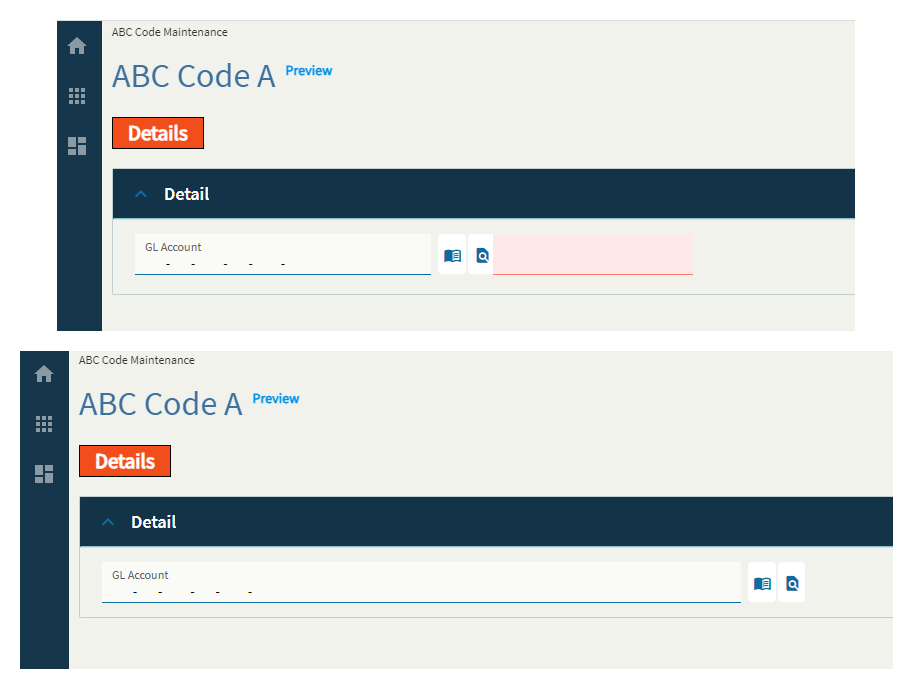

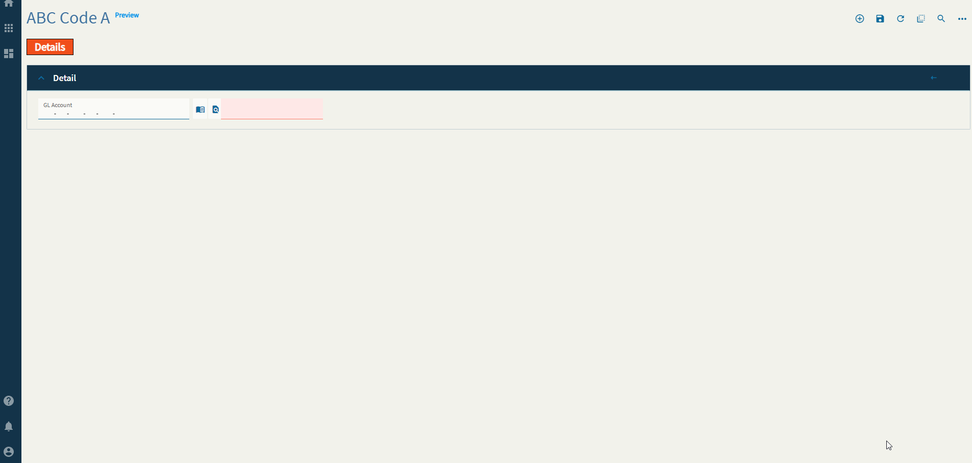

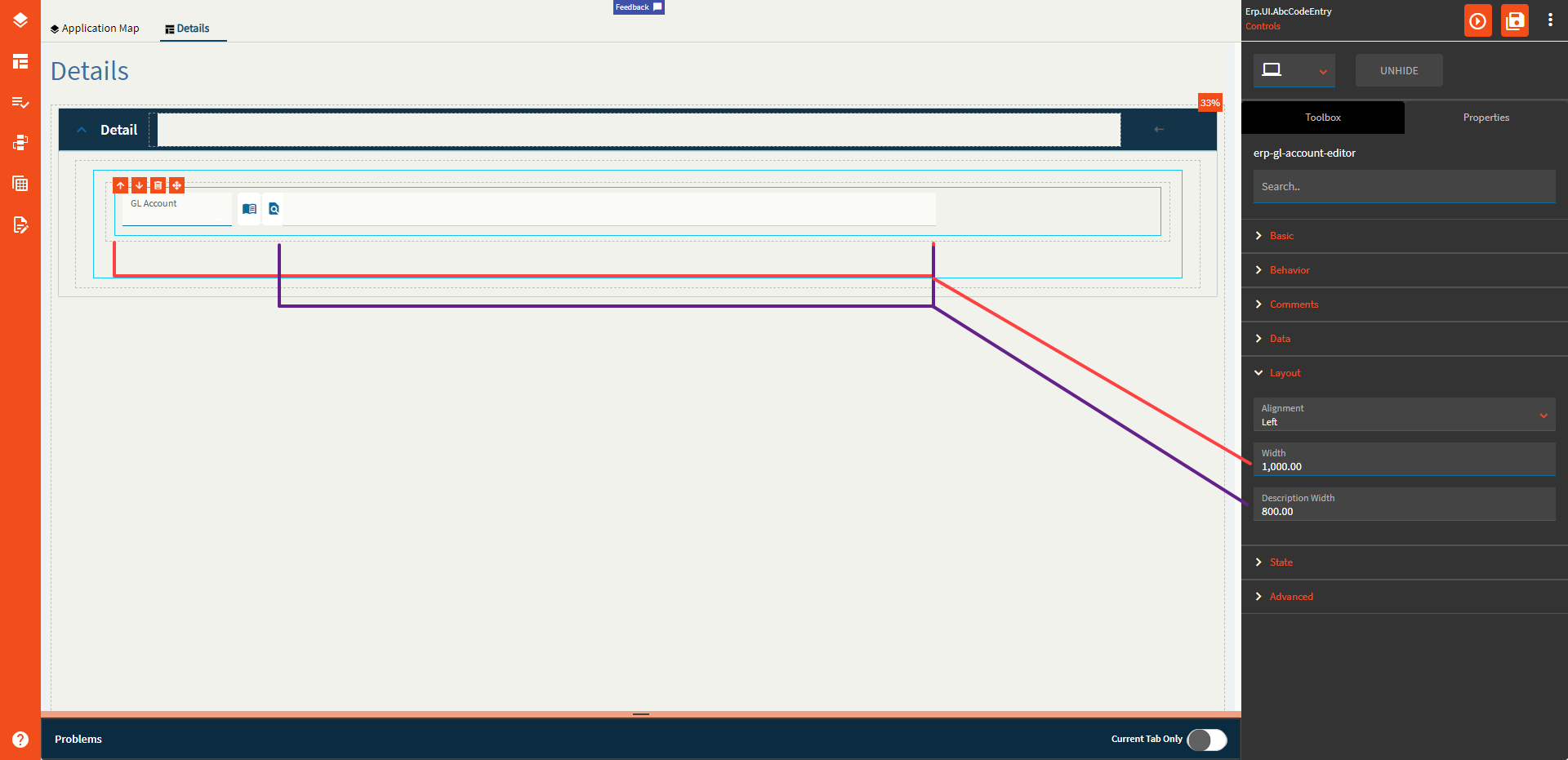

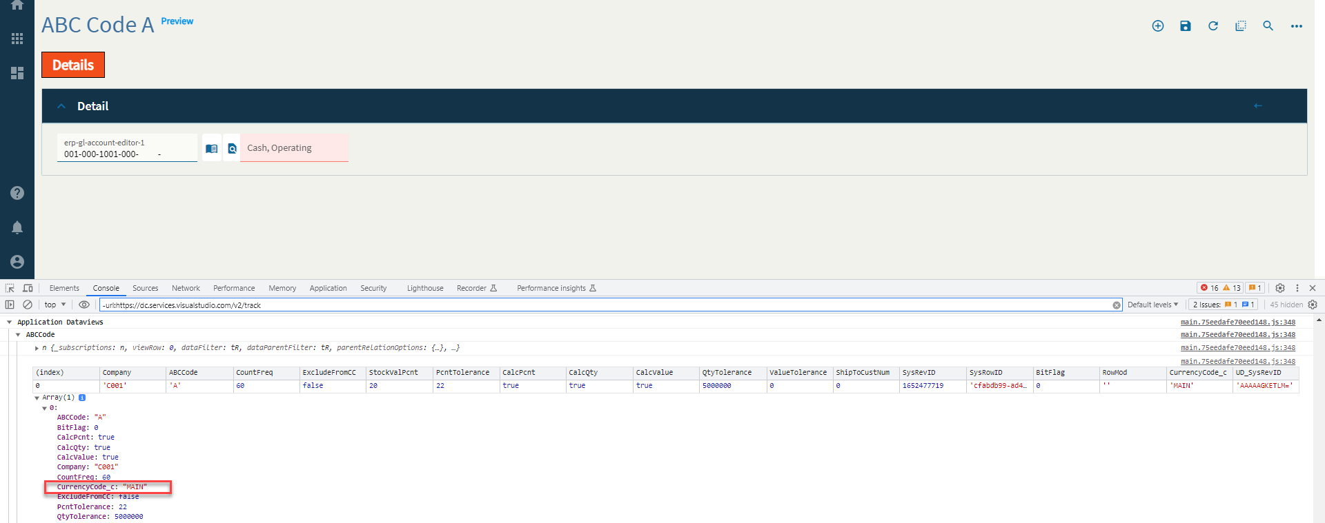

GL Account Editor
General Ledger Multi-book account editor component with possible multi-book account code entries.

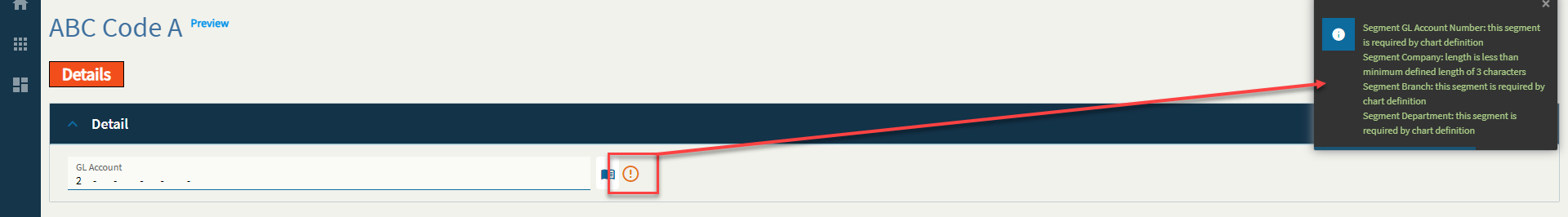

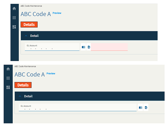

I can’t, for the life of me, figure out how to make the description stop being red by using the properties of this field alone. :sob:

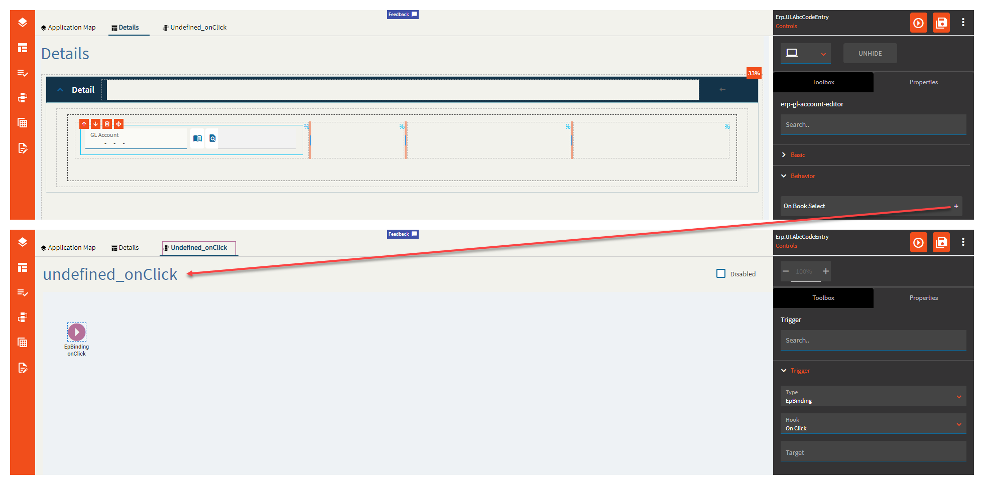

Behavior On Book Select :mag_right: Click this to create a useless event you’ll have to delete. (Fig. B for the lulz)
Comments Comments Add some developer notes to the control. These are not customer-facing and are only visible in App Studio (Fig. C)
Data Coa Code Column Set the data binding for the COA Code using the format View.Column. This is a column the control pulls from to read the COA Code. Needs to be an actual DB column. (Fig. D)
Data Binding External CompanyId Set data binding for the External CompanyID. Format: View.Column. (Fig. E)
Data Binding Description Set the data binding for the Description. Format: View.Column (Fig.E)
Data Binding Acct Disp Set the data binding for the Account Display. Format: View.Column. (Fig. E)
Data Binding Segments Set the data binding for the Segments. This will generate 20 different bindings in the format of View.Column1 - View.Column20. Format: View.Column (Fig. E)
Data Binding Invalid Account Message Set the data binding to retrieve the invalid message. Format: View.Column. (Fig. E)
Layout Description Width Sets the width of the description which must be less than the total width. (Fig. G)

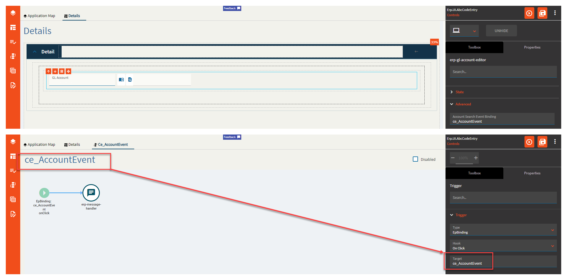

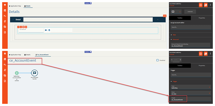

Advanced Account Search Event Binding Set an event name to overwrite the default account search event. The trigger for the event needs to be EpBinding/OnClick/EventName where the event name is the event you’re currently editing. Yup. (Fig. H)
Advanced Segment Search Event Binding :mag_right: Supposed to be the same as the account one, but for segments, but I could not get this one to fire. Maybe it’s the book icon? If so–that one is broken too.

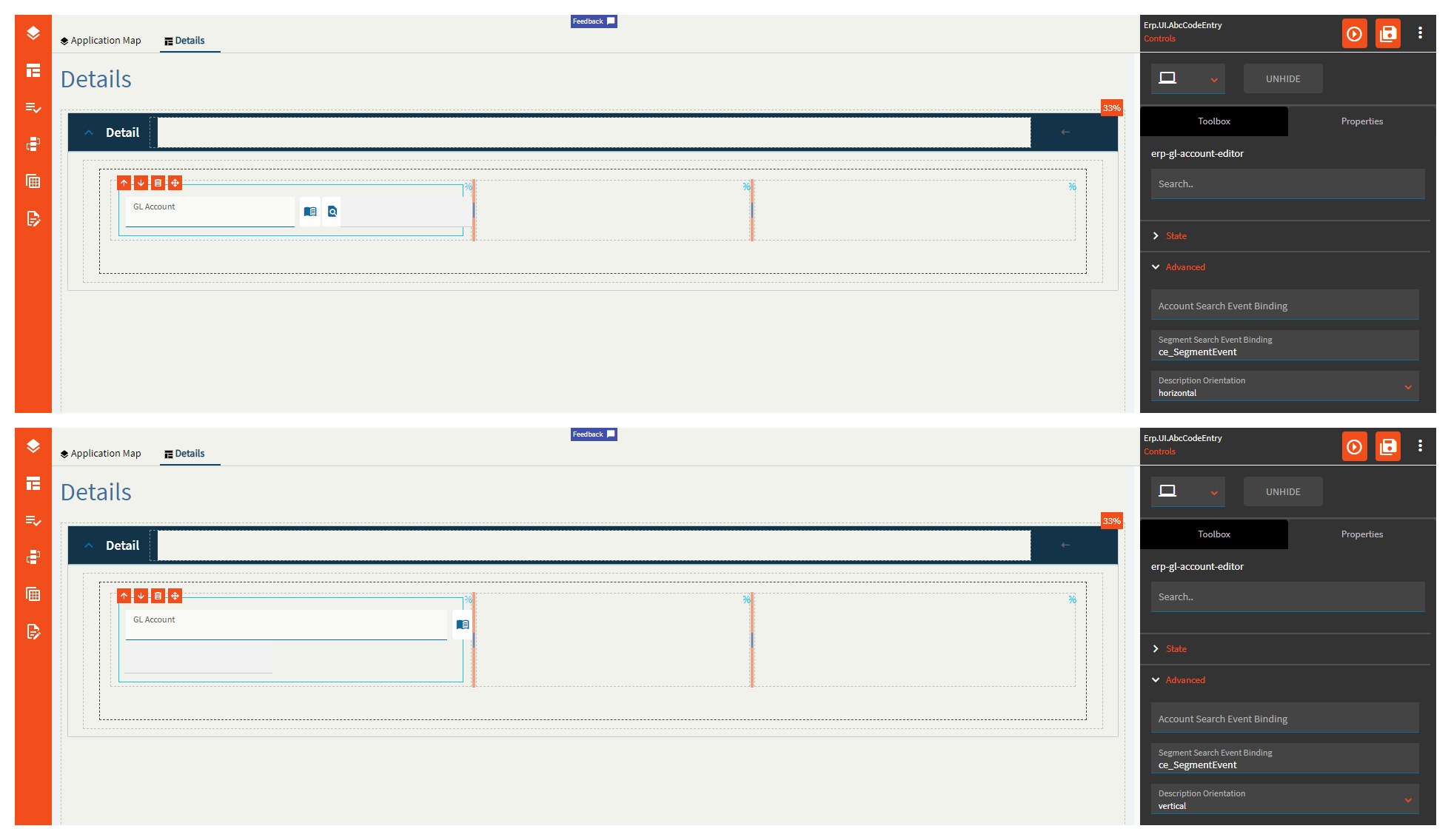

Advanced Description Orientation Set the orientation for the description field. Valid Options include: horizontal and vertical. (Fig. I)
Advanced Hide Dynamic Enable to hide dynamic segments.
Advanced Do not require Dynamic Check this to disable dynamic segments required
Advanced Allow Pattern :mag_right: Enables patterns in account. This is some GL-ese I don’t speak. Not sure what this does.
Advanced Pattern Options Select a pattern option allowed in the account. Valid options include: All, percent, underscore. Again–this is some GL-ese I don’t speak. Maybe someone in finance can weigh in?
Advanced Validate Segment Values Enable to include segment validation when typing in a GL. (Fig. J)
Advanced Validate Account Code Enable to include account code validation when typing in a GL. (Fig. J)
Advanced Validate Account on Load :mag_right: Enables validation when the account is loaded. Not sure how to test this to fully describe it.
Advanced Validate Required Segments Enables validation of the entered required segments. (Fig. J)
Advanced Validate Segment Properties Enable to include segment property validation. (Fig. J)
Advanced Hide Segment Labels :mag_right: Marked as obsolete.
Advanced Show Description Enable to show the description field. (Fig. K)
Advanced Do not cache description :mag_right: Checking this disables the description caching. Not quite sure what this means.

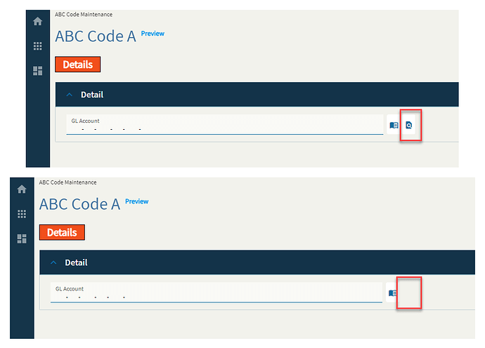

Advanced Show Account Search Button Checking this shows the search button. (Fig. L)
Figure B: On Book Select
Little Girl Wtf GIF
Figure C: Comments
Figure D: COA Code Binding
Note–I’m using the currency column because it’s the only string column I had to use that wasn’t a KeyField.
Figure E: Data Bindings
Figure F: Alignment
Figure G: Width
Figure H: Account Event Binding
Default
AccountEventNormal
Custom Event
AccountEventCustom
Figure I: Description Orientation
Figure J: Validations
Figure K: Show Description
Figure L: Show Account Search
This is my favorite one. :laughing:

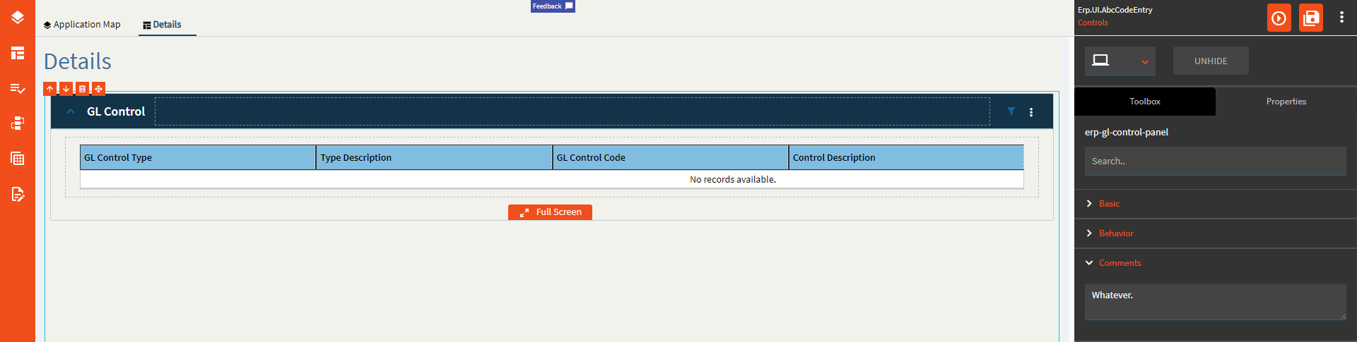

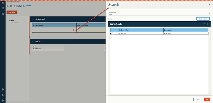

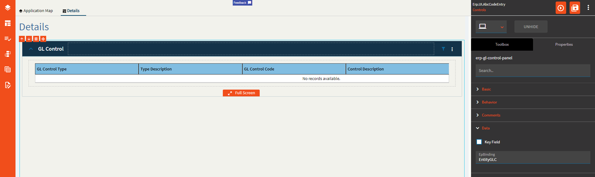

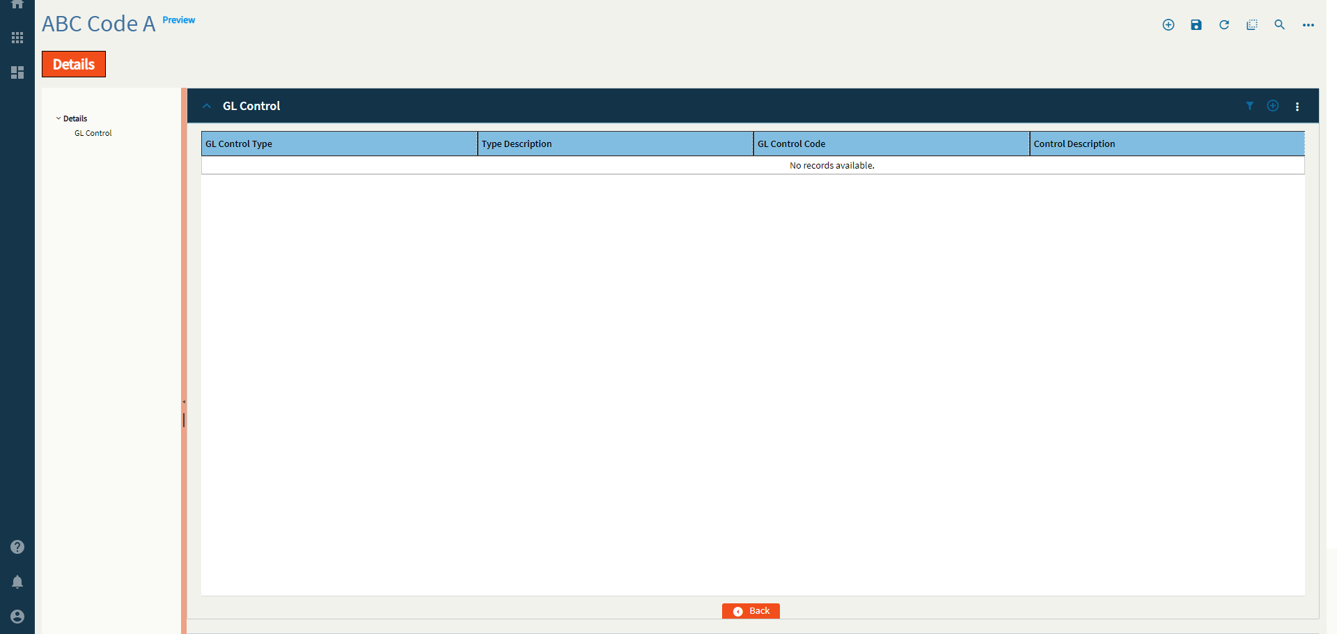

GL Control Panel
A grid of GL Control Types and Codes.

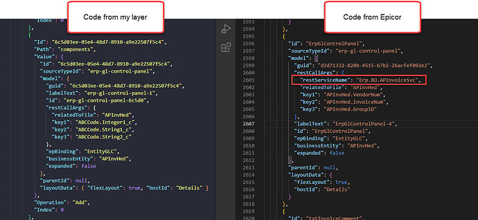

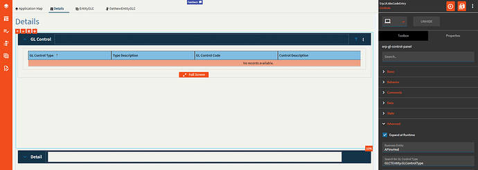

This control is busted. I can’t get it to do anything. It doesn’t even react–as in no console or network activity of any kind. At all.
I will outline the properties and what they should do, but don’t expect this one to work. Or–if you do get it working, come tell me what TF I’m missing.
But FIRST! … Some code discrepancies between my control setup and Epicor’s native one.

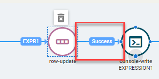

Look at that. That boxed line there. The Rest Service.
Do you see that property anywhere? No? Me neither. But has that ever stopped me? …Nope! So, I went and added the line in myself in the JSON and pushed it back into the DB. Did it fix the control? Also nope. Whatever. I’m over it. I am NOT patient enough to submit this one to support. To walk them through how to set this up… I can’t won’t do it!
And now for something completely different.
Data Key Field Indicates that a bound component is a key field. If true, the field is enabled if there is no current record, allowing the user to select an existing record or create a new one. Not really relevant to this control.
Data EpBinding Bind the control to a DataView only. No column. You will also need to configure the dataview (Fig. B)
Advanced Expand At Runtime :mag_right: Expand the panel by default when the form opens at runtime. Doesn’t work. At all. It doesn’t even add it to the JSON. I can add it to the JSON and make it work. But the property doesn’t. (Fig. C)
Advanced Business Entity Set the business entity that the GL control type links to. The business entity defines what areas of the database the GL control type updates through its account and journal contexts. Example: APInvHed

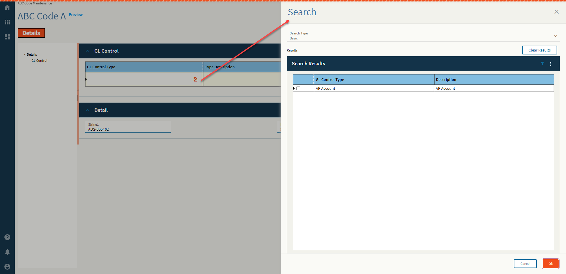

Advanced Search for GL Control Type Set the search to run for the GL Control Type Field. Default search used is ‘GLCTEntity.GLControlType’. This comes up when you click the New Row icon, then Search. (Fig. D) See Addendum for how to configure the REST call to make new New button work.
Advanced Search for GL Control Set the search to run for the GL Control Type Field. Default search used is ‘GLCTEntity.GLControlCode’. This comes up when you click the New Row icon, then Search. See Addendum for how to configure the REST call to make new New button work.

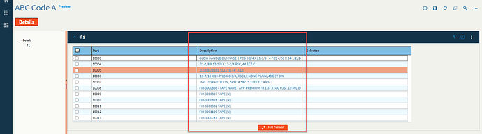

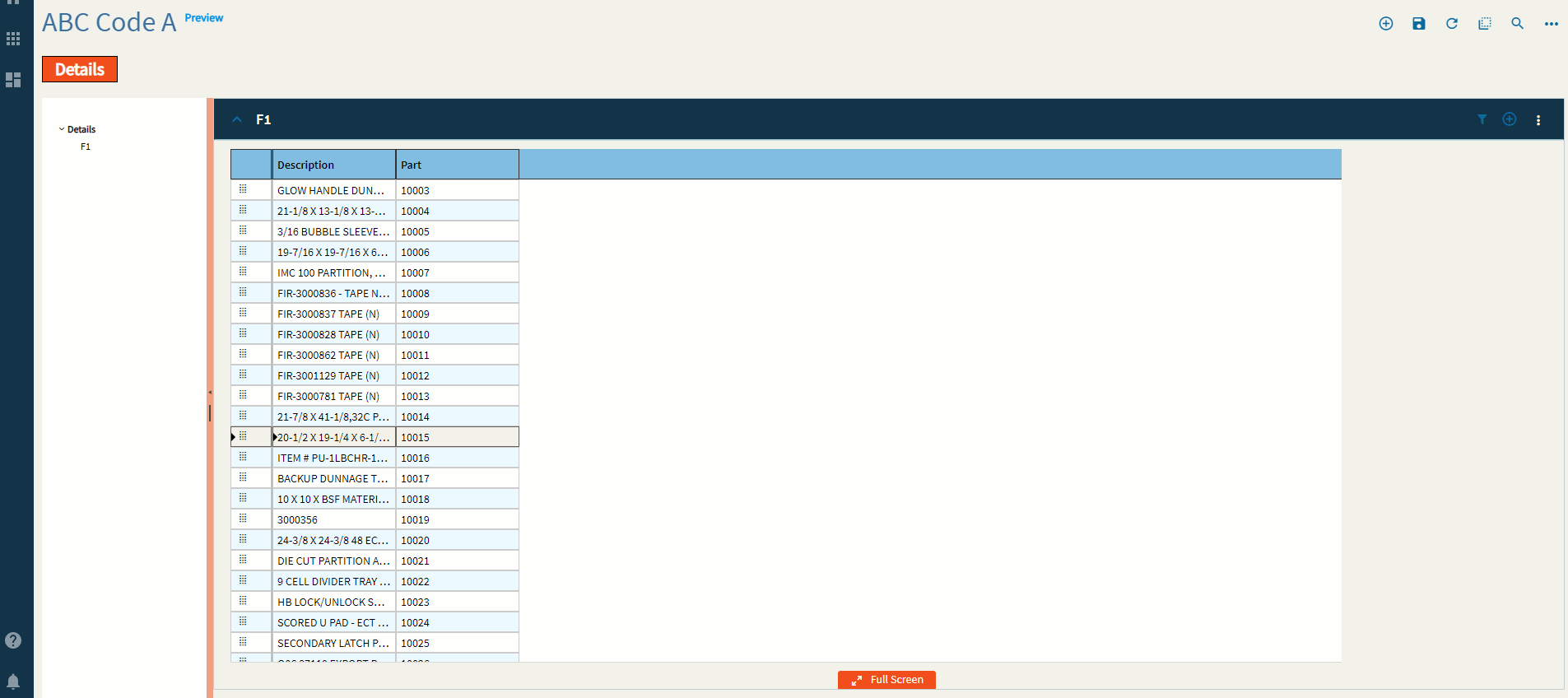

Advanced Full Screen Enable full screen mode! (Fig. E)
Advanced > Rest call arguments Related Entity Set the data binding in the format View.Column for the realtedToFile parameter value. Example: ApInvHed
Advanced > Rest call arguments Epbinding for first related entity key Set the data binding in the format View.Column that will provide the value for the first key in the relatedToFile Table. Example: ABCCode.Integer1_c which maps to VendorNum. Run a BAQ on the EntityGLC table to get some sample data for each RelatedToFile.
Advanced > Rest call arguments Epbinding for second related entity key Set the data binding in the format View.Column that will provide the value for the second key in the relatedToFile Table. Example: ABCCode.String1_c which maps to InvoiceNum.
Advanced > Rest call arguments Epbinding for third related entity key Set the data binding in the format View.Column that will provide the value for the third key in the relatedToFile Table. Example: ABCCode.String2_c which maps to GroupID.
Advanced > Rest call arguments Epbinding for fourth related entity key Set the data binding in the format View.Column that will provide the value for the fourth key in the relatedToFile Table.
Advanced > Rest call arguments Epbinding for fifth related entity key Set the data binding in the format View.Column that will provide the value for the fifth key in the relatedToFile Table.
Advanced > Rest call arguments Epbinding for sixth related entity key Set the data binding in the format View.Column that will provide the value for the sixth key in the relatedToFile Table.

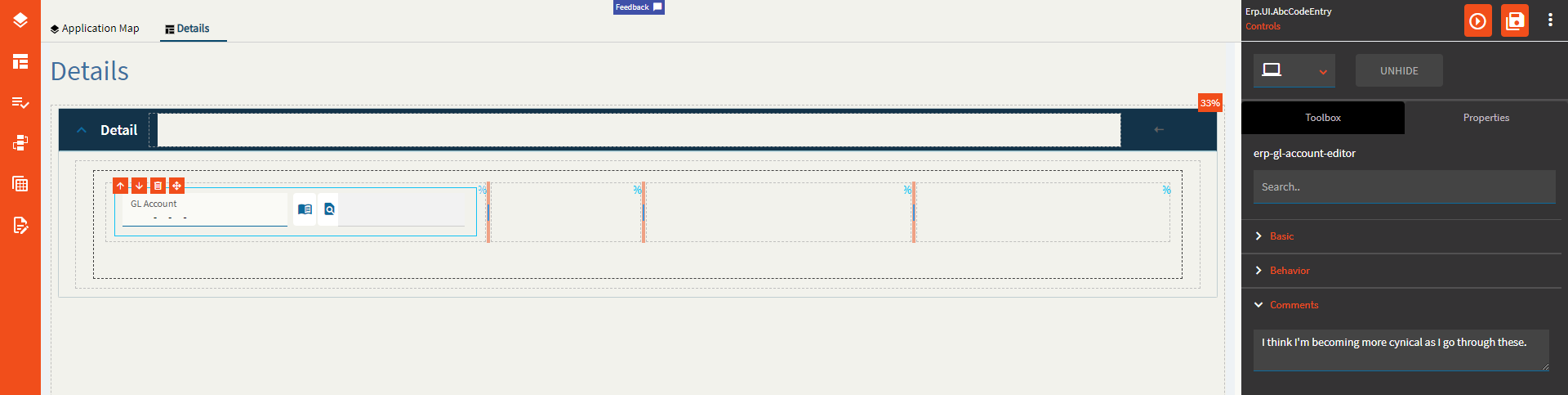

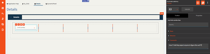

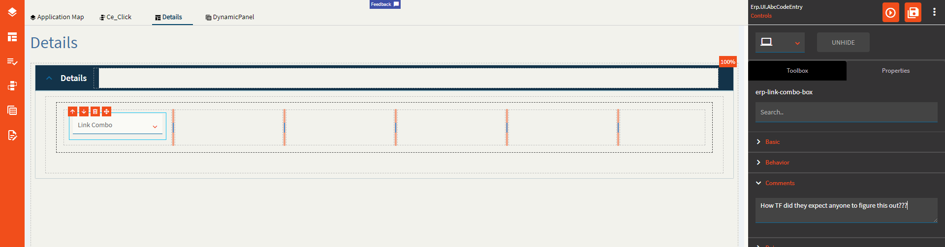

Figure A: Comments

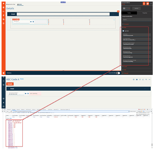

Figure B: EpBinding
Note the difference Dataset/Table

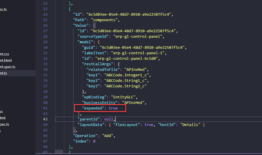

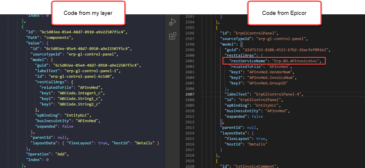

Figure C: Expand at Runtime JSON
The only way I could get this to work is to add it myself to the code. I’m not going to explain how.

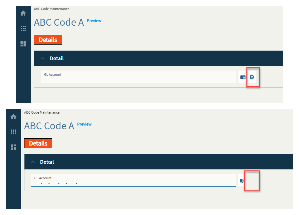

Figure D: Search for GL Control Type
Figure E: Full Screen

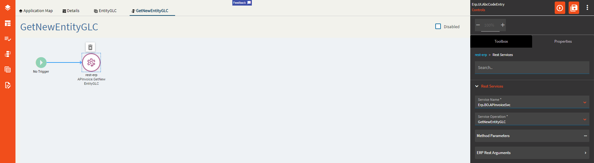

REST Setup for New button
The event must be called GetNewEntityGLC (or some variation of your dataview). If you named your dataview Stroopwafel, then name the event ‘GetNewStroopwafel’.
Method Parameters (modify to your specific BO call):
ds: empty
realtedToFile APInvHed
key1: Bound vendor column {ABCCode.Integer1_c}
key2: Bound invoice number column {ABCCode.String1_c}
key3: Enter a space, this is empty.
key4: Enter a space, this is empty.
key5: Enter a space, this is empty.
key6: Enter a space, this is empty.

GL Multibook Account Editor
No No No GIF
Some of these I just don’t know what to tell y’all.
It seems like the GL Account Editor with extra steps that… don’t work. And it pulls dataviews out of it’s magical GL ass. I hate accounting.
Gonna keep on going and revisit these ones later.

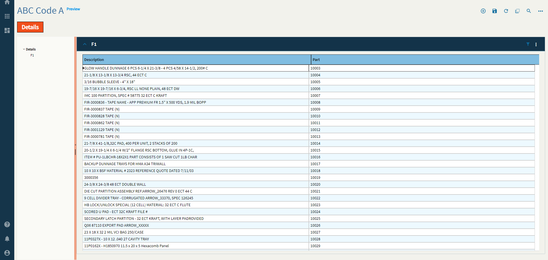

Grid :checkered_flag:
The formation of each driver’s starting position at the beginning of the ra-- …ope, nope. Not that one.
Expandable container that displays a grid and allows interaction with the grid using additional components in the panel card header.

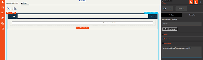

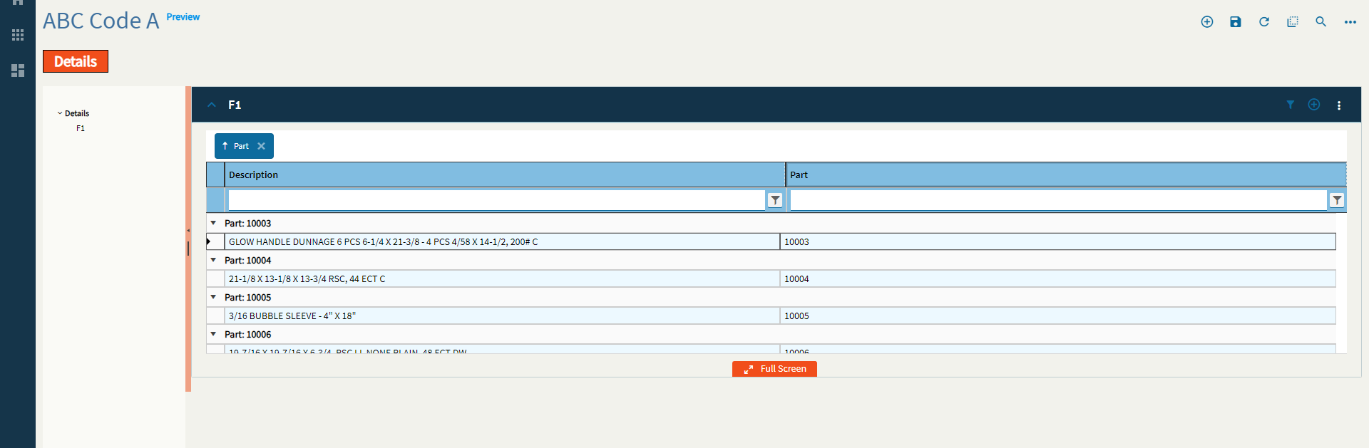

Data > Grid Groupable Not sure why this is tri-state, but enabling it allows a user to group on columns. (Fig. F)

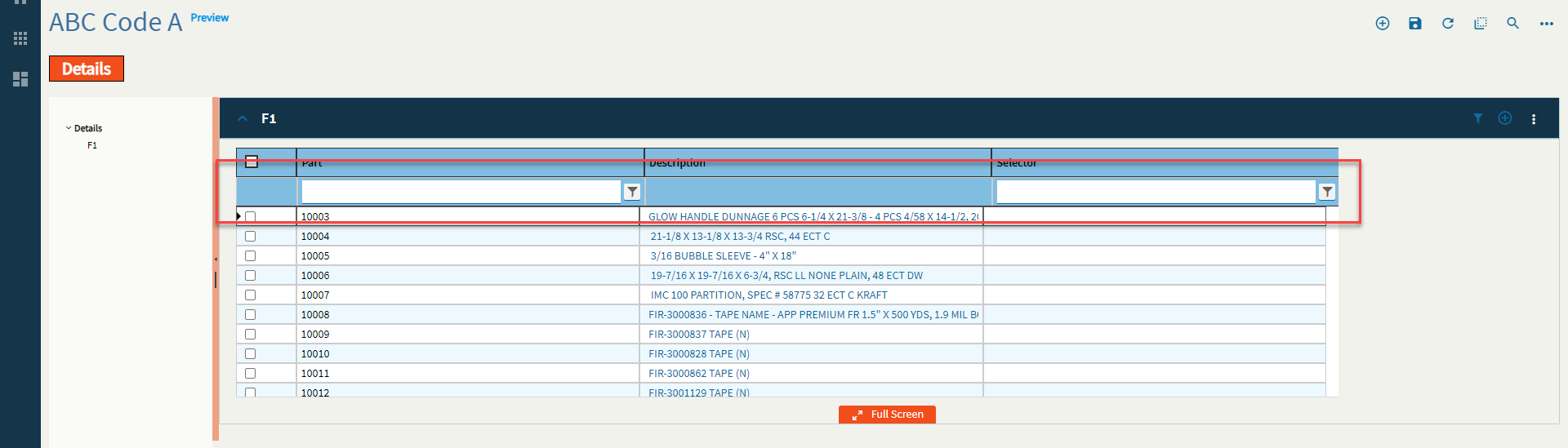

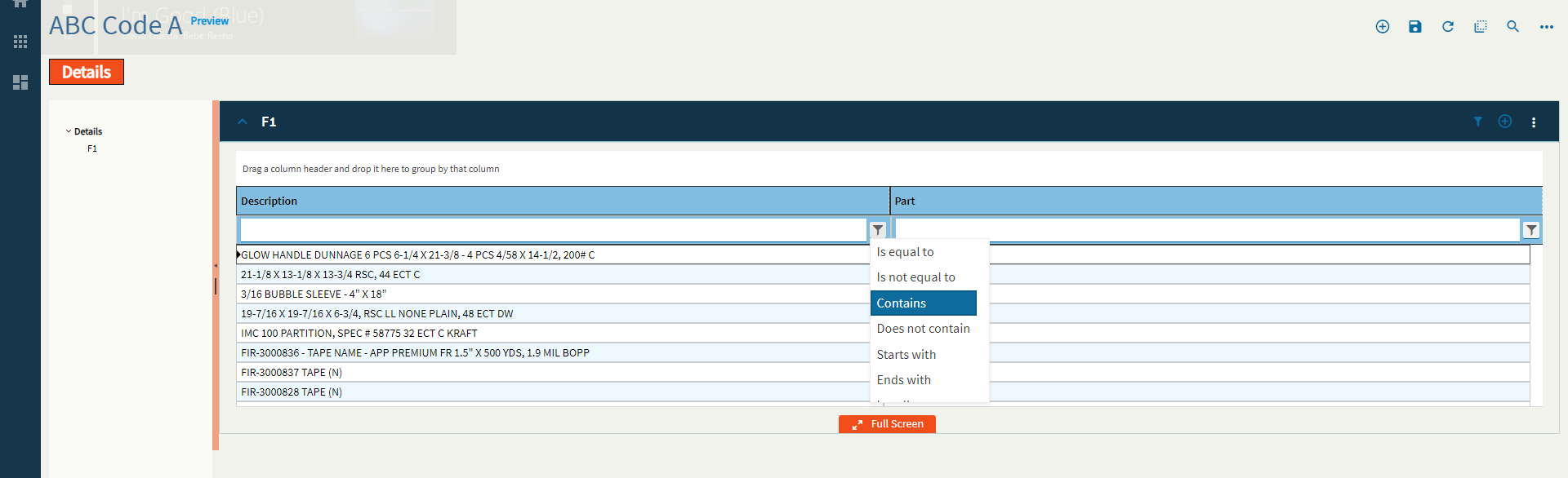

Data > Grid Filterable Enable to allow filtering. (Fig. G)
Data > Grid Advanced Filter :mag_right: Doesn’t change the filter settings. #Shrug

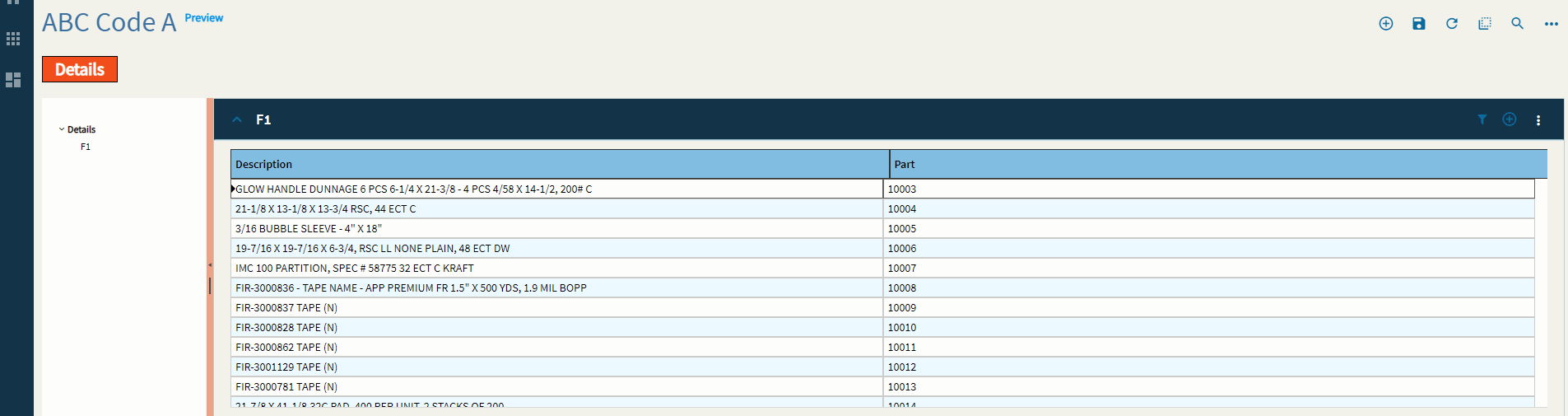

Data > Grid Reorderable Allows the user to reorder the columns to their fancy. (Fig. H)

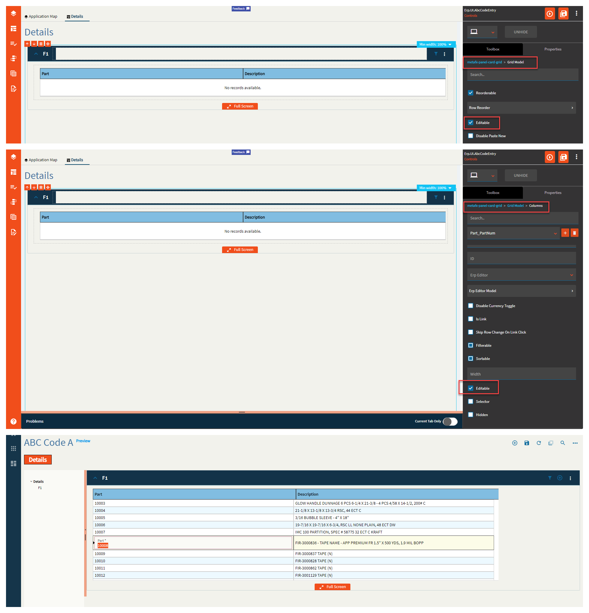

Data > Grid Editable Enables editing of the grid cells. This is to be used in conjunction with Columns > Editable. (Fig. J)

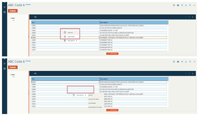

Data > Grid Disable Paste New Disables the paste new operation from the right-click menu. (Fig. K)
Data > Grid Disable Paste Update Disables the paste update operation from the right-click menu. (Fig. K)

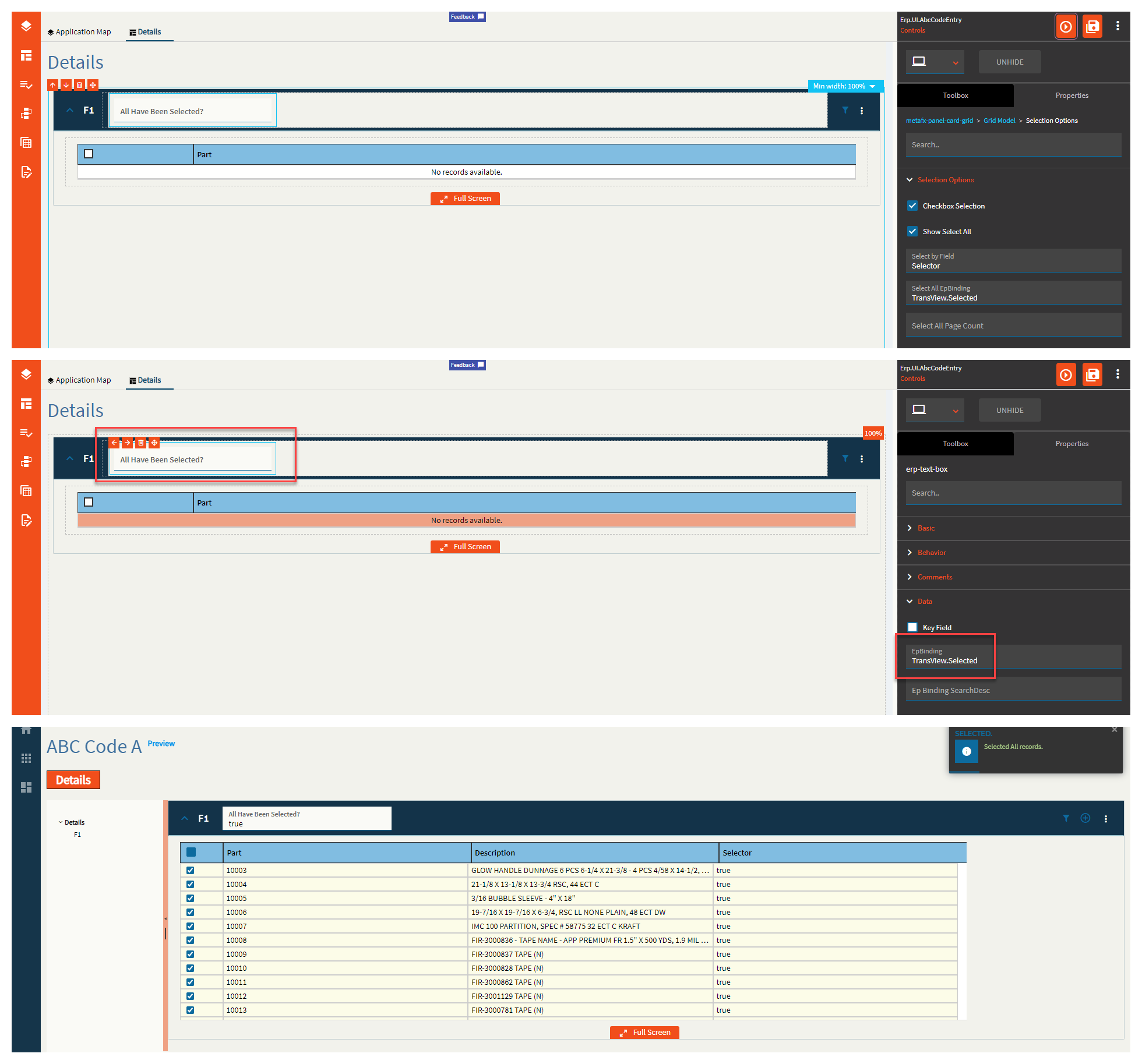

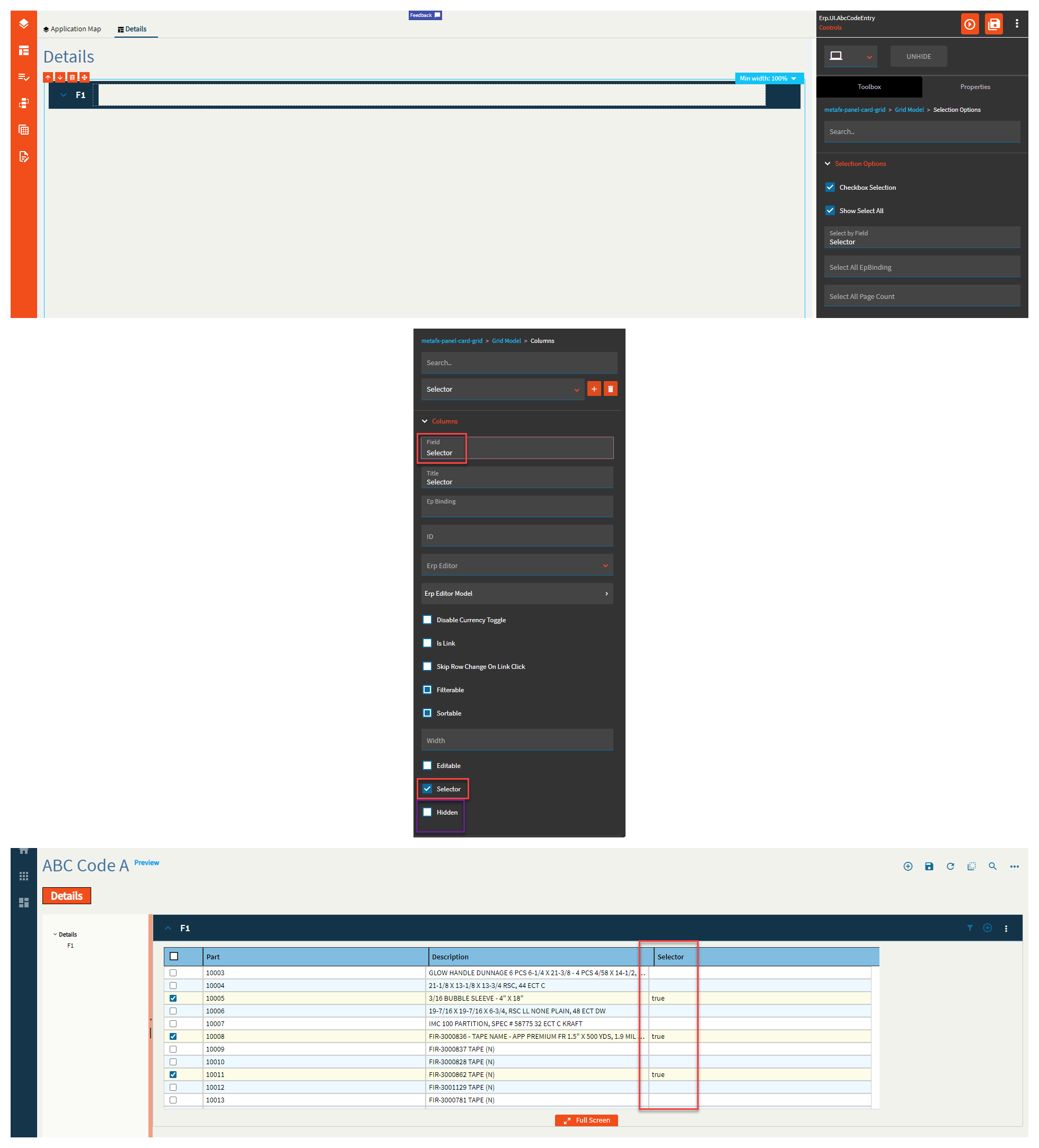

Data > Grid > Selection Options Checkbox Selection Shows a column of checkbox selectors. (Fig. L)

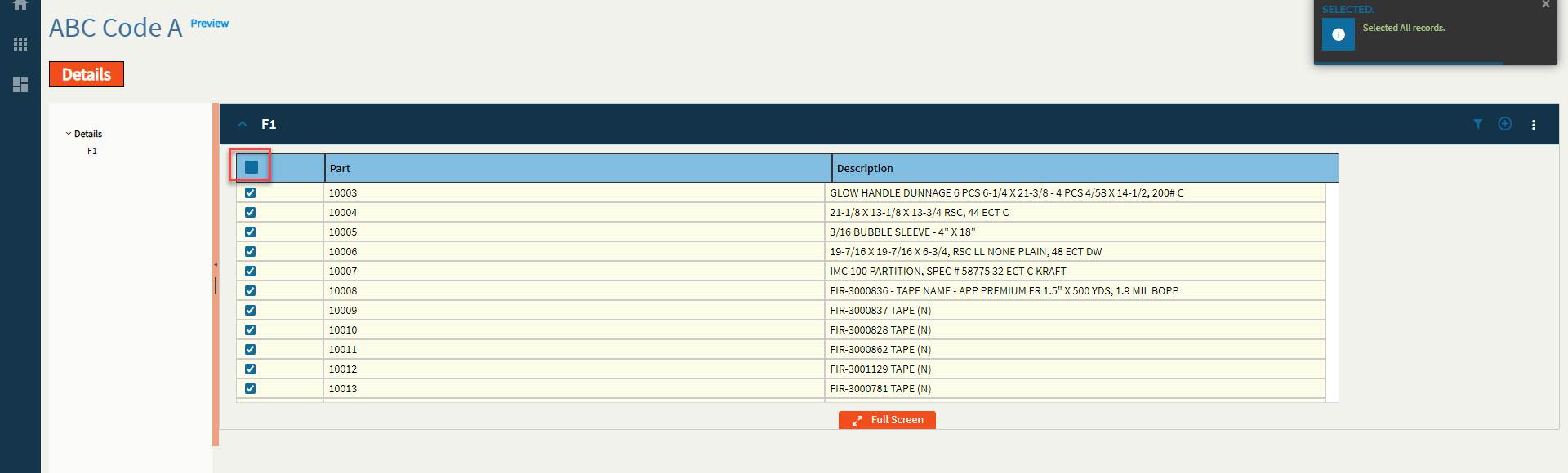

Data > Grid > Selection Options Show Select All Shows a checkbox in the upper-left that selects all rows. (Fig. N)
Data > Grid > Selection Options Select by Field Boolean field to designate that the row has been selected. Generally, this is a hidden column you create. (Fig. O)
Data > Grid > Selection Options Select All EpBinding Set the data binding to indicate select all has been checked in the format of DataView.Column. (Fig. P)

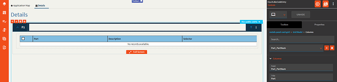

Data > Grid > Columns Field Set the field name from the dataset. If it’s from a BAQ, then it would be in the format of Table_Column. If it’s from a dataview bound to the grid, then it would just be the column name with no table or dataview prefix. BAQ Example: Part_PartNum | BO Example: PartNum
Data > Grid > Columns Title Give the column header a title. This will default to the Field name if none is supplied. (Fig. Q)
Data > Grid > Columns Ep Binding :mag_right: Set the data binding for the column using format View.Column (special cases). What are those special cases? Who knows?
Data > Grid > Columns ID Set the ID for the column. This can be used in events.
Data > Grid > Columns Erp Editor Select the type that the column will be such as Boolean, Combo, Text, Currency, etc. This is used in conjunction with the Erp Editor Model to define the special behaviors of each. For instance, if setting the Erp Editor to Combo, you can then define the data in said combo by using the Erp Editor Model.
Data > Grid > Columns Erp Editor Model As mentioned above, this is used to define the properties of the Erp Editor. To find out more, reference the appropriate control within this page. Text = Textbox, Boolean = Checkbox, Combo = Combo, etc.

Data > Grid > Columns Editable Enables editing for the column. (Fig. J)
Data > Grid > Columns Selector Sets the column as the designated selector. (Fig. O)

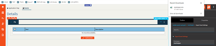

Data > Grid > Export Excel Settings File Name Name of the Excel file when exporting. (Fig. V)

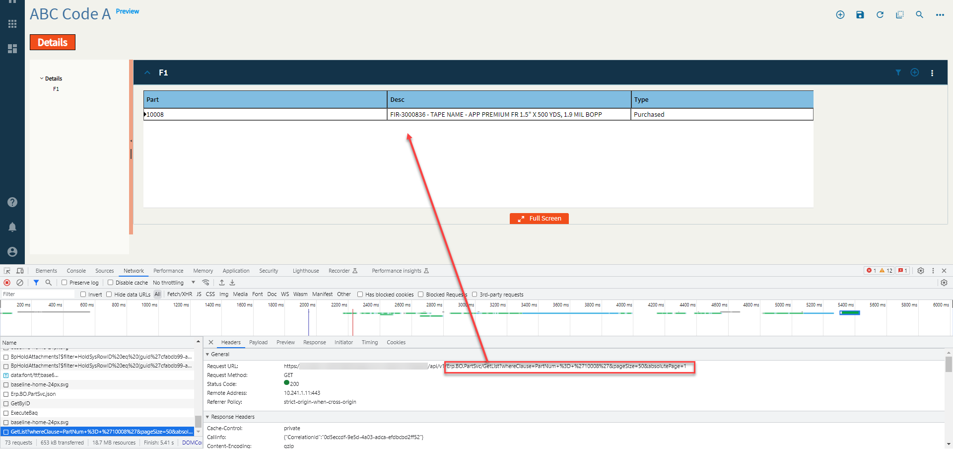

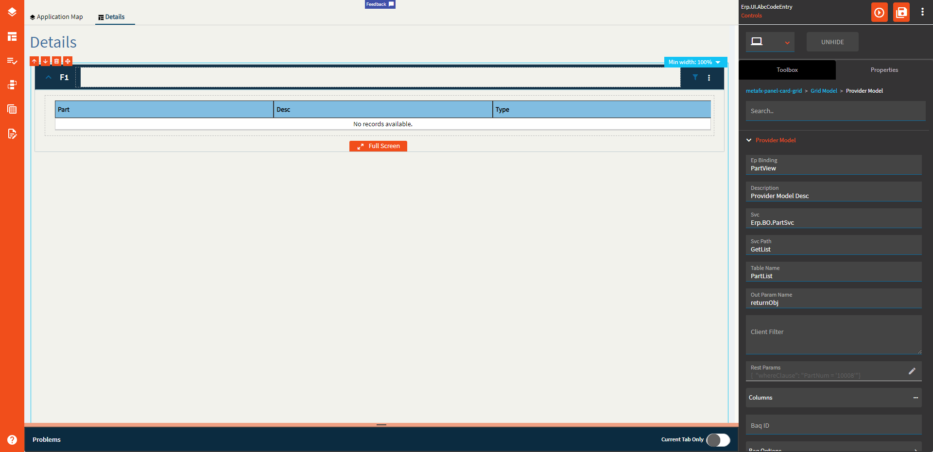

Data > Grid > Provider Model Ep Binding Set the name of the view that receives the data from the server call. Format: ABCCode
Data > Grid > Provider Model Description This is basically just a comment for the provider model.
Data > Grid > Provider Model Svc The REST service that provides the data. Example: Erp.BO.PartSvc (Fig. W)
Data > Grid > Provider Model Svc Path The REST method to be called. Example: GetList (Fig. W)
Data > Grid > Provider Model Table Name The table name that holds the data. Example: PartList (Fig. W)
Data > Grid > Provider Model Out Param Name Set the out parameter name that holds the rows of data. Example: returnObj (Fig. W)
Data > Grid > Provider Model Client Filter Filters the dataset after it’s returned from the server. Example: Part_Typecode = 'M'.
Data > Grid > Provider Model Rest Params Set a JSON object composed of key-value pairs that define the parameters that are sent into the service call. Example: { "whereClause": "PartNum = '10008'" } (Fig. W)
Data > Grid > Provider Model Columns :mag_right: Doesn’t work. Use the columns from the Grid Model section.

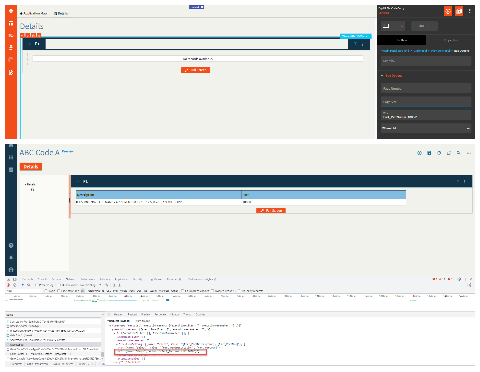

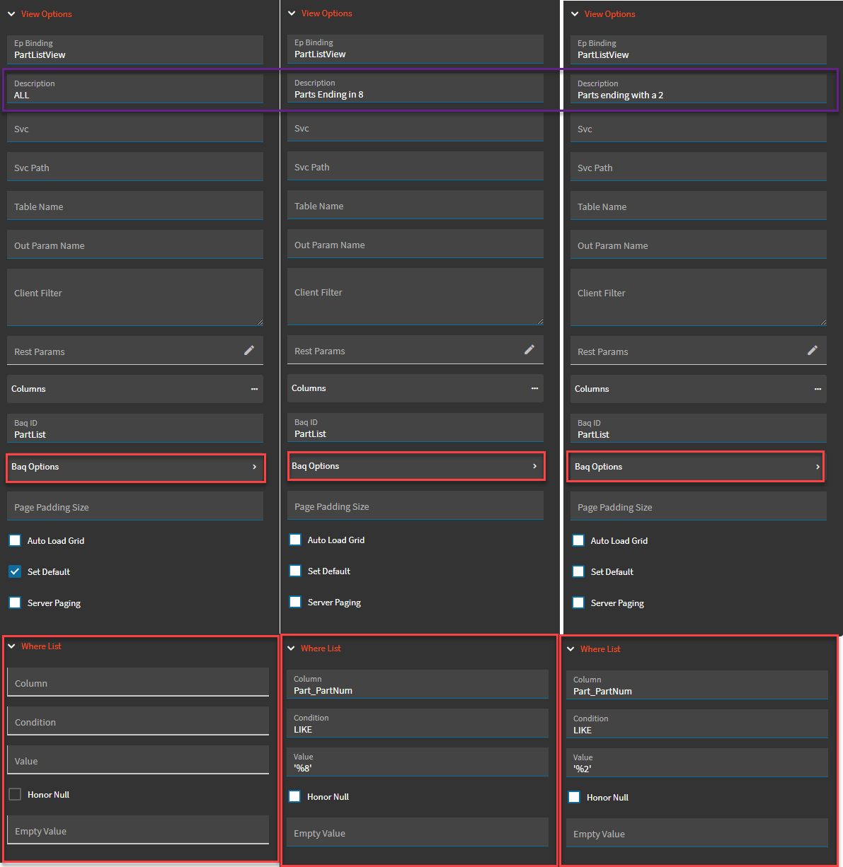

Data > Grid > Provider Model BAQ ID BAQ Identifier that will provide data. Example: PartList (Fig. X)
Data > Grid > Provider Model > BAQ Options Page Number If there are multiple pages, this defines the first page to display.
Data > Grid > Provider Model > BAQ Options Page Size Page size (number of rows) of data to return.

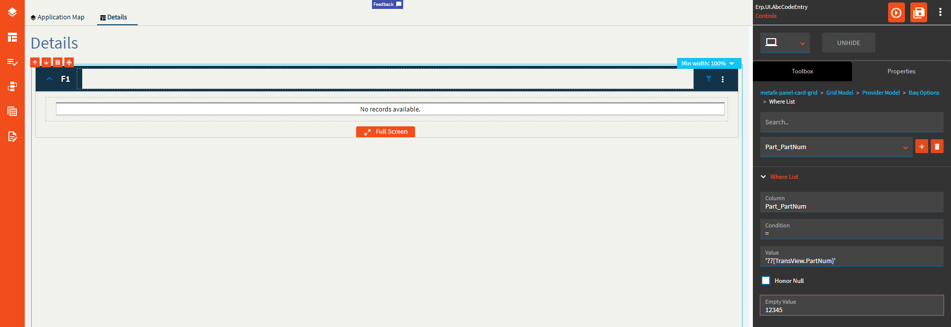

Data > Grid > Provider Model > BAQ Options Where Where Clause for the BAQ. (Fig. Y)
Data > Grid > Provider Model > BAQ Options > Where List Column The BAQ column name to filter on. Format: Table_Column (Fig. Z)
Data > Grid > Provider Model > BAQ Options > Where List Condition The operator to use. Valid options include =, <=, >=, <>, starts, matches, like (% wildcard). (Fig. Z)
Data > Grid > Provider Model > BAQ Options > Where List Value The value to check against. Format is '??{DataView.Column}' or a literal. Use single quotes around strings. A single ‘?’ will not let the REST call happen if the value is empty or null. ‘??’ will make the REST call regardless of the value. (Fig. Z)
Data > Grid > Provider Model > BAQ Options > Where List Honor Null Honor null will send null if the value is.. null! Otherwise, it will NOT append that where item to the where clause in the case of a null value.
Data > Grid > Provider Model > BAQ Options > Where List Empty Value If the value of the binding is empty, this will get sent instead.

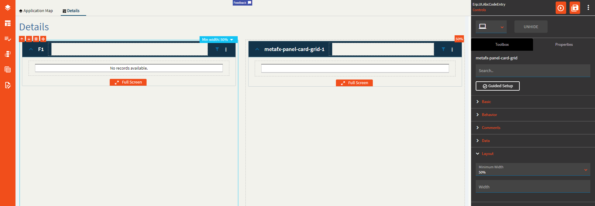

Layout Minimum Width Sets the minimum width the panel can shrink to when the page is in Flex Layout Mode. (Fig I ← Roman Numeral 1)

Advanced Auto Fill Container Enable this to have the grid take the full size of the container it’s in. (Fig. II)

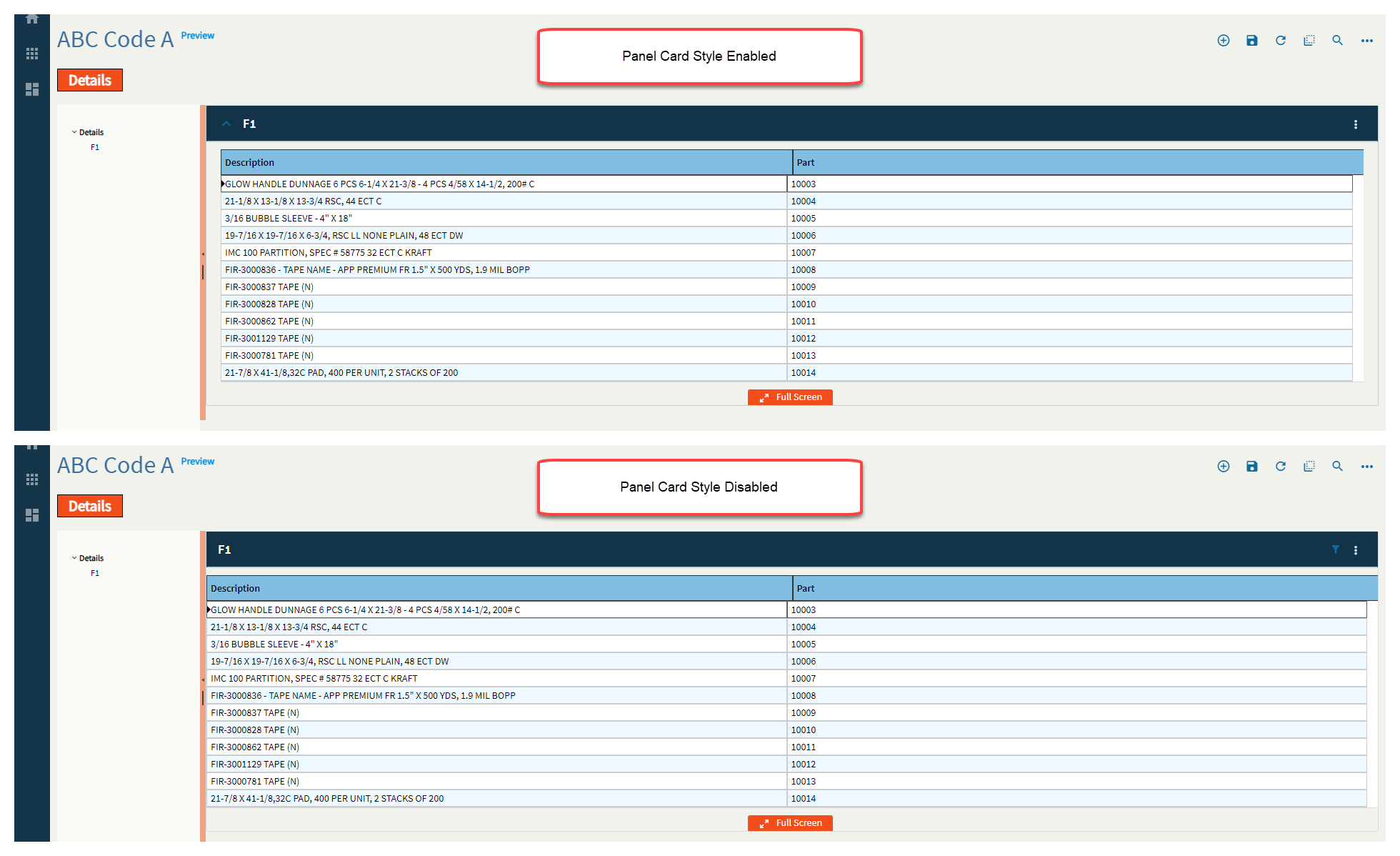

Advanced Disable Panel Card Style Pretty much removes the padding around the outside. This is nice when you’re embedding a panel in a tab control. (Fig. III)

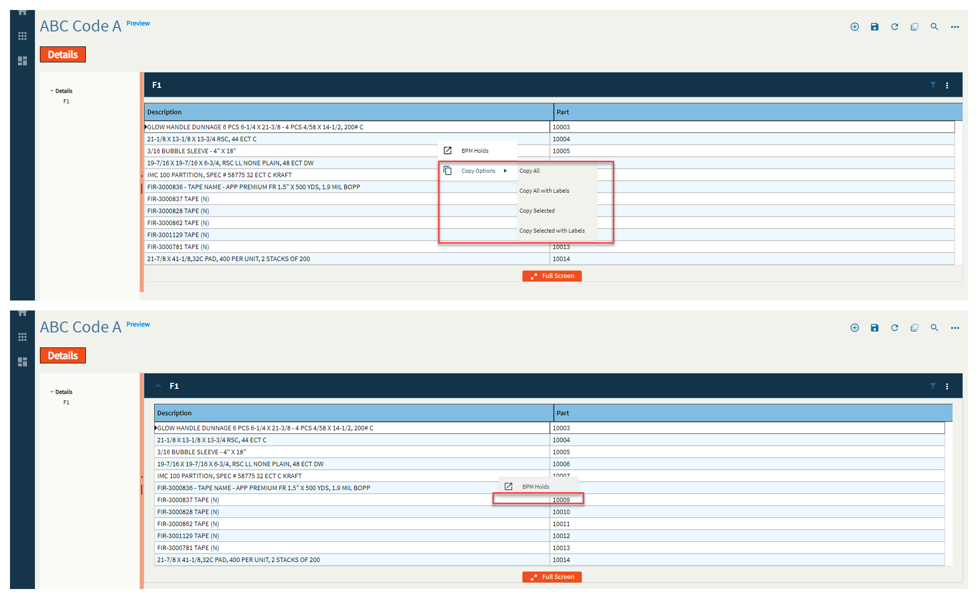

Advanced Disable Copy Options Removes the Copy Options from the right-click. (Fig. IV)

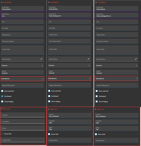

Advanced View Options This is where you can define different, selectable views for a single grid. For instance, if you have a sales order grid, you can have views for All, Open, and Closed. To configure these, please refer to the previously mentioned Provider Model. The setup is the same. You would just set different where clauses for each view. Some points of note that work here and not the overall provider model is the Description shows the text in the View combo and the Set Default selects that view over the others to load by default. (Fig. XII)

Figure C: Comments

Figure F: Groupable
Figure G: Filterable
Figure H: Reorderable
Reorderable

Figure J: Editable
Figure K: Disable Paste Operations
Figure L: Selectable
Figure M: Max Columns
Figure N: Select All
Figure O: Select by Field
Figure P: Select All EpBinding

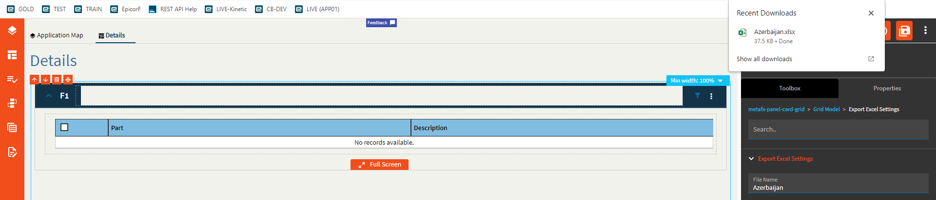

Figure V: File Name
Figure W: Provider Model
Figure X: BAQ ID
Figure Y: Where Clause
Figure Z: Where List
You can add as many of these as you need, but they will always be concatenated with “AND”. If you want to do an “OR” you will need to write it yourself in the “Where” found in the BAQ Options.
Figure I (Roman Numeral): Minimum Width

Figure III: Disable Panel Card Style
Figure IV: Disable Copy Options

Figure XII: View Options
ViewOptions

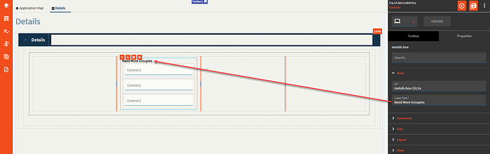

GroupBox
Use to group controls with an optional label so that they stay together as the UI responds to smaller screens.
Basic Label Text Sets the Title of the group. (Fig. A)
Data Key Field :mag_right: No idea why this is even here as you can’t bind a group box..
Layout Minimum Width Sets the minimum width the panel can shrink to when the page is in Flex Layout Mode. (Fig. C)

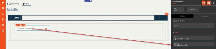

Label
Allows the user to create a label.
Basic Label Text Set the text of the label. (Fig. A)
Data EpBinding Set the data binding in the format of DataView.Column. This will replace what’s in the LabelText property. (Fig. B)
Layout Alignment Set the alignment of the text to Right, Center, or Left. (Fig. C)
Figure B: EpBinding
LabelBinding
Figure C: Alignment

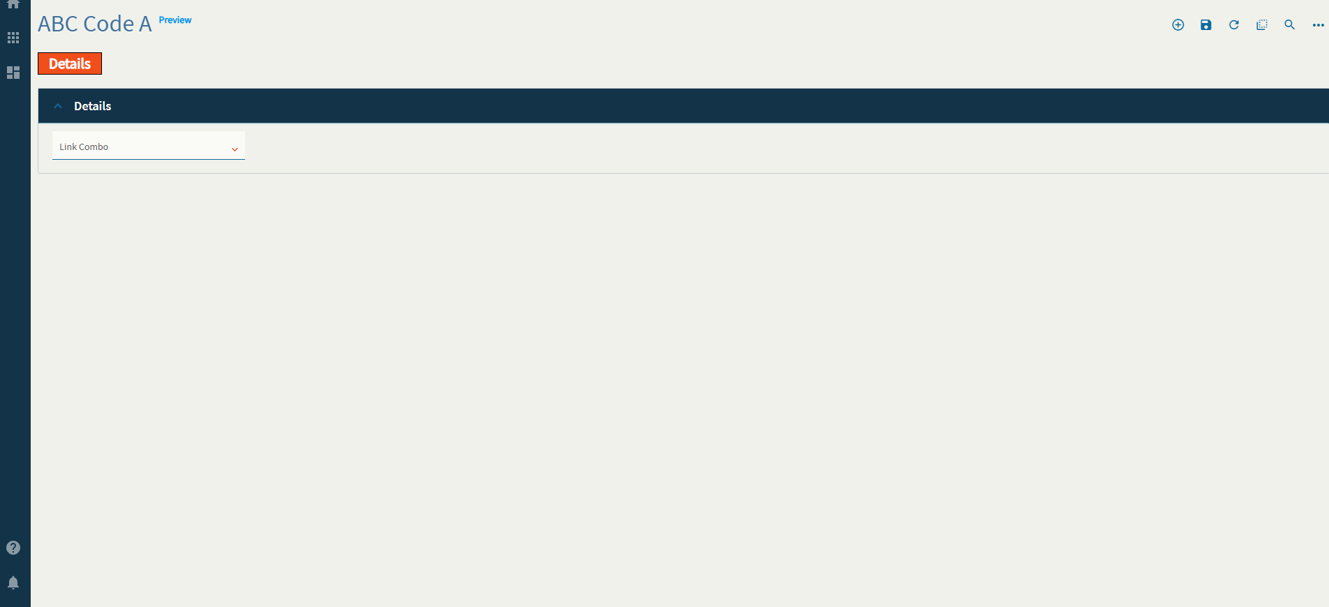

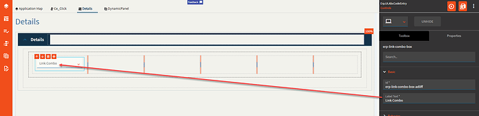

Link Combo Box
:dumpster_fire: incoming…
Wow, okay, so yeah. This was something.
Allows a user to select from a list of predefined formulers and populate values within them.
* I did not set events to do anything with the formula in this example:
LinkedCombo
Make sure to view the bottom Event configurations to make this thing work!!!
Basic Label Text Sets the label text within the control. (Fig. A)
Data EpBinding Bind the button to a DataView.Column.

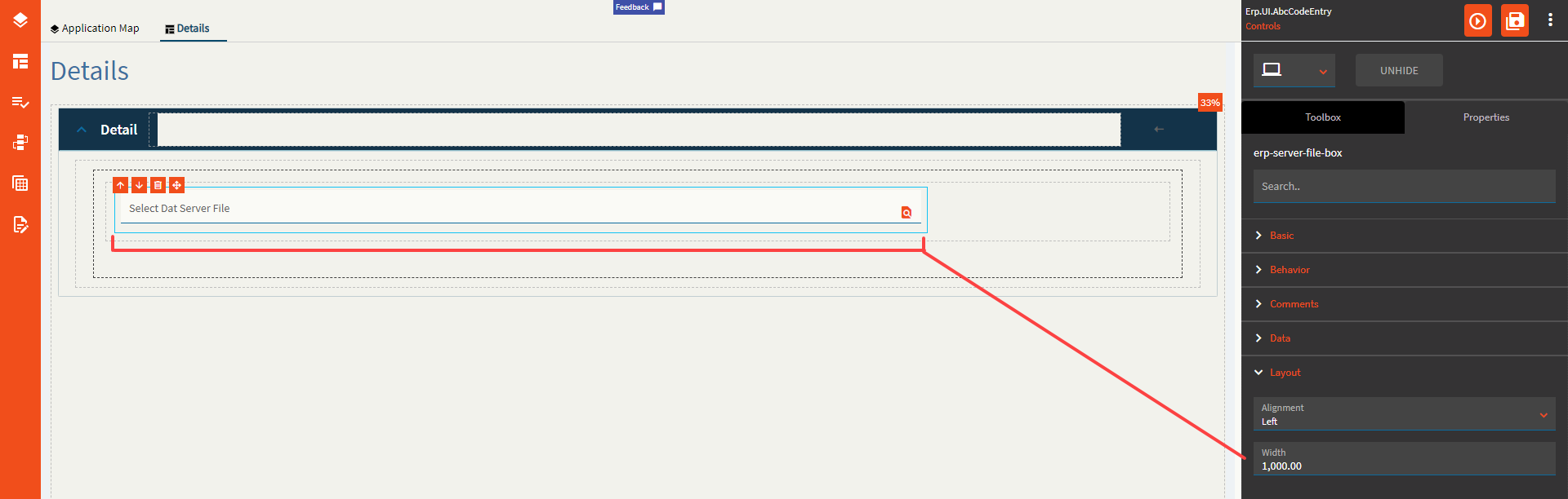

Misc EpBinding for Phrase Items Optional binding to a dataview that has the definitions for the items and phrase items. Honestly–I didn’t bother with this optional binding… 'cause optional. Yeah.
Advanced > Items ID Set an ID of the first collection of items–the row if you will.
Advanced > Items > Phrase Items (Type: Text) ID The ID for the item. (Fig. E)
Advanced > Items > Phrase Items (Type: Text) Type Type is Text or Link. Link will be clickable. (Fig. E)
Advanced > Items > Phrase Items (Type: Text) Text The, well… the text! (Fig. E)
Advanced > Items > Phrase Items (Type: Text) Max Width If the maximum width of the phrase item in the combo is exceeded, ellipses are used. (Fig. E)
Advanced > Items > Phrase Items (Type: Text) AlwaysClickable The phrase item is clickable even if read only or within an inactive grid row when type is link. (Fig. E)
Advanced > Items > Phrase Items (Type: Link) ID The ID for the item. (Fig. F)
Advanced > Items > Phrase Items (Type: Link) Type Type is Text or Link. Link will be clickable. (Fig. F)
Advanced > Items > Phrase Items (Type: Link) EpBinding Set the data binding the link reads from/to. Format Dataview.Column. (Fig. F)
Advanced > Items > Phrase Items (Type: Link) Default Text The text shown first before being replaced by the text in the binding. (Fig. F)
Advanced > Items > Phrase Items (Type: Link) Max Width If the maximum width of the phrase item in the combo is exceeded, ellipses are used. (Fig. F)
Advanced > Items > Phrase Items (Type: Link) AlwaysClickable AlwaysClickable
Figure B: Comments
Figure C: Alignment
Figure D: Width
Figure E: Phrase Type Text
Figure F: Phrase Type Text

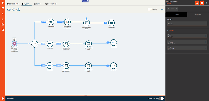

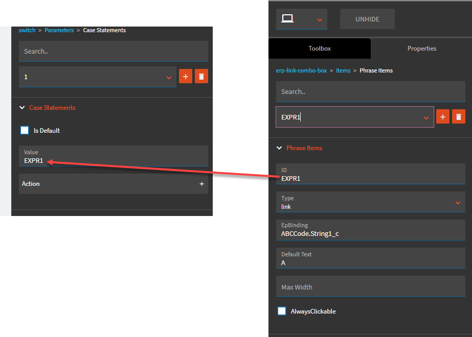

Events and Views

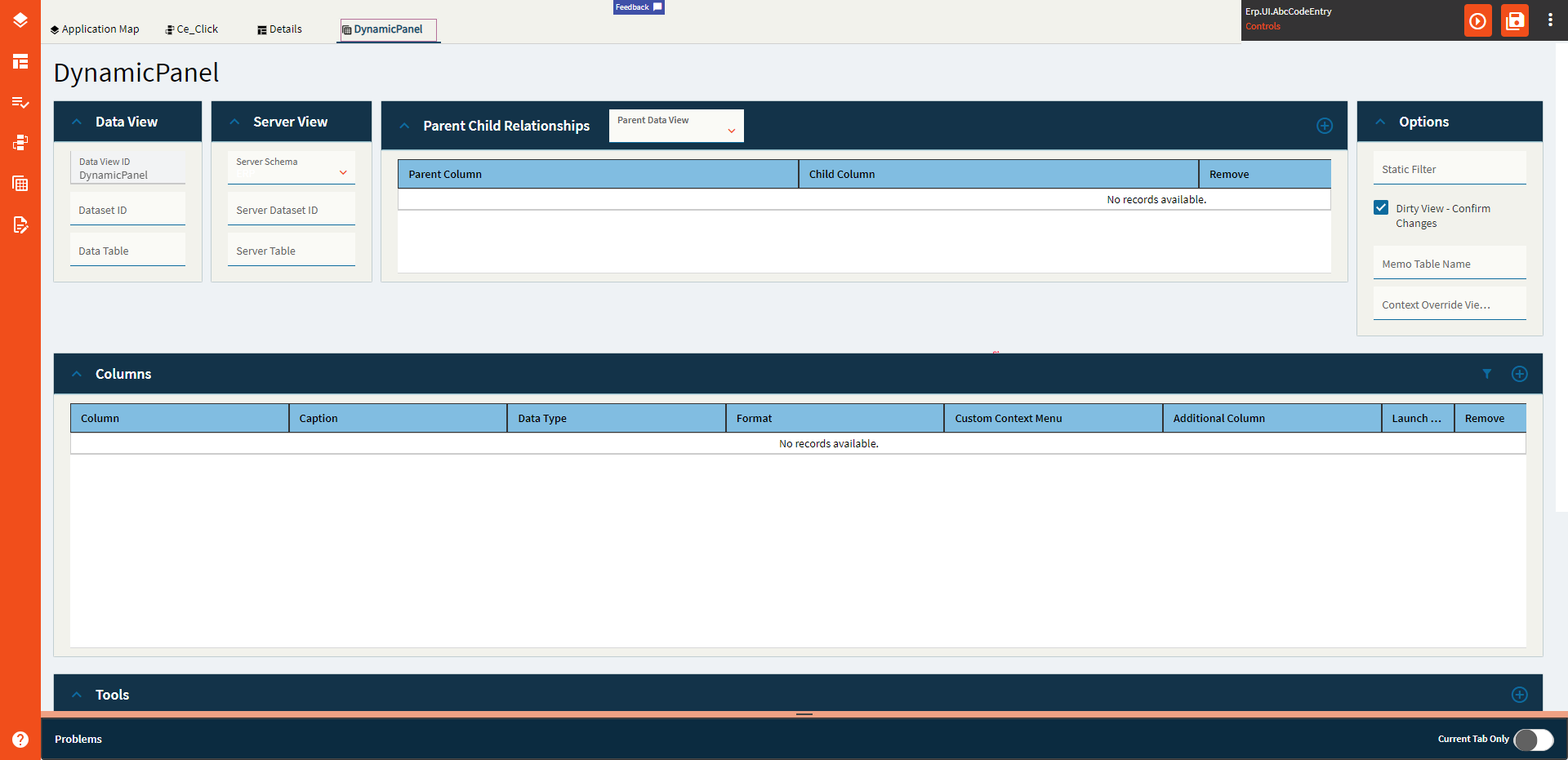

Create a dataview:

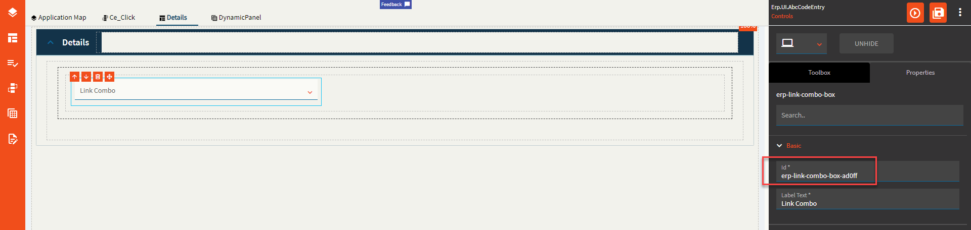

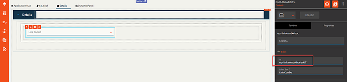

Get the ID of your Link Combo
Create a new event
The trigger is going to be:
Type Control
Hook onLinkClick (This is not in the dropdown… you just have to magically know this!! :expressionless: )
Target The ID you just copied.

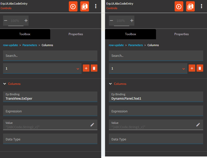

Put in a Switch. The value for the switch will be %value% to get whatever was just clicked. These values will correspond to the IDs you set for each Phrase item. The action off of that case statement will be row-update.
In the row update, set the Binding to DynamicPanel.Text1. This will be used in the next widget.
Set the value to the binding of your Phrase item. For the operator, bind it to TransView.ExOper. Or don’t. I dunno. That’s just what I found Epicor doing when I reverse engineered it.
The switch fails without this. Make sure to do an OnSuccess on your row-update widget. Throw a console-write after so that if you need to rearrange downstream widgets, you don’t have to start over. Initialize DyanmicPanel.Text1 and TransView.ExOper with what’s in our bindings presently.
Now attach some dynamic-panel-open widgets.

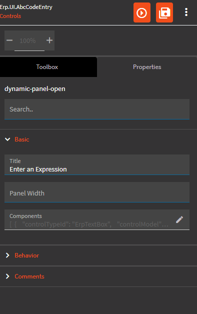

Give it a title.
Here’s the code for a textbox component. Note that it’s using the DynamicPanel.Text1. If you bound that to something else, change it here too.
		"controlTypeId": "ErpTextBox",
		"controlModel": {
			"labelText": "Enter Text",
			"epBinding": "DynamicPanel.Text1"

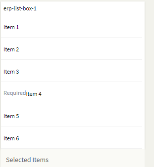

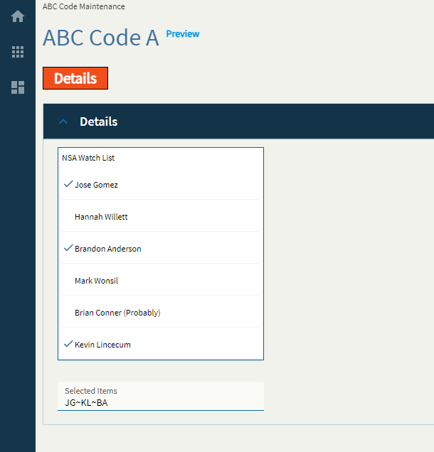

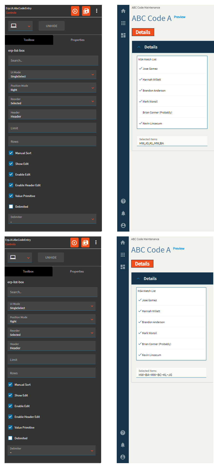

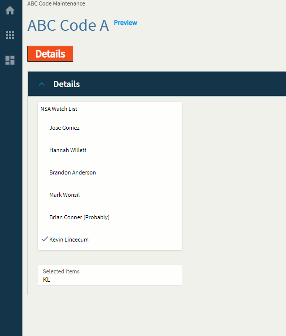

List Box
Allows a user to display a list of preset items. This control allows for single or multiple selections.
ListBox2
The properties on this control are nearly identical to the ones for the List Selection Box, however this is the pared down version and most properties don’t do anything.
Data EpBinding Bind the button to a DataView.Column. Multiple selections will be delimited and stored by their ID.
Data > Items Id Set the unique ID for the items. This is also what is stored in the EpBinding for the control. (Fig. C)
Data > Items Text Set the display text for the item. (Fig. C)
Data > Items Id Name :mag_right: (Obsolete)
Data > Items Description Detailed description for the item. This is internal only. (Fig. D)
Data > Items SubText :mag_right: Doesn’t do anything.
Data > Items LeftIcon :mag_right: Doesn’t do anything.
Data > Items Command :mag_right: Might do something if I could, you know, know what it’s looking for here. What a crap shoot!
Data > Items Selected :mag_right: Set the flag indicating the list item is selected. It shows it in App Studio as selected, but it doesn’t work in the actual application.
Data > Items Check Mark Hidden Hides the checkmark for the item, but still allows for selection. Nothing like confusing your users! (Fig. E)
Data > Items Toggle Disabled Indicates if the list item is disabled. There’s no visual to actually SHOW that it’s disabled, though. Again–nothing like confusing your users! :roll_eyes:
Data > Items Required :mag_right: This one is neat. /s Sets a flag indicating that the item is required. Yes–it does indicate that. It also doesn’t allow you to click the item nor does it automatically add it to the binding… (Fig. F)
Data > Items Bookmark :mag_right: Set the flag indicating the list item has a bookmark. Doesn’t do anything.
Layout Alignment Set the alignment for the control. Valid options are Left, Center, Right. (Fig. G)
Layout Width :mag_right: Sets the specific width (pixels) for the control. Doesn’t work.
Advanced Selection Mode This determines whether the user can select single or multiple values at once. This defaults to multi-selection mode. Valid options include: single and multi. (Fig. H)
Advanced Target Label Text :mag_right: Set the label text for the target list. Doesn’t do anything.
Advanced Mode Types :mag_right: Set the display mode such as single, dual, or panel. Doesn’t do anything.
Advanced Ui Mode :mag_right Set the UI mode such as select, single-select, or switch. Doesn’t do anything.
Advanced Position Mode :mag_right: Set the position mode (left or right). Doesn’t do anything.
Advanced Reorder :mag_right: Set the reorder mode (All or selected). Doesn’t do anything.
Advanced Header :mag_right: Sets the label text for the list. Only used on Panel Mode and thus–doesn’t do anything.
Advanced Limit :mag_right: Set the limit of the items to be displayed. Only used on Panel Mode and thus–doesn’t do anything.
Advanced Rows Sets the number of items to be displayed. (Fig. I)
Advanced Manual Sort :mag_right: Sets the flag indicating if the Sort button should be shown. Doesn’t work.
Advanced Show Edit :mag_right: Sets the flag indicating if the Edit button should be presented. Panel mode only. Doesn’t work for this control.
Advanced Enable Edit :mag_right: Set the flag indicating if editing of list items is allowed. Panel mode only. Doesn’t work for this control.
Advanced Enable Header Edit :mag_right: Sets the flag indicating if the edit button should be presented at the top of the list. Panel mode only. Doesn’t work for this control.
Advanced Value Primitive :mag_right: Specify the type of selected value. If set to true, the selected value has to be of a primitive value. Not sure what this is supposed to do. Doesn’t seem to change anything.
Advanced Delimited :mag_right: Set the flag indicating if the multi-select value for binding is delimited. It’s delimited regardless of this checkbox.
Advanced Delimiter Set the delimiter character used for the binding. Valid options include: Nothing, “~”, “,”, or “`”. (Fig. J)
Figure B: Comments
Figure C: Id and Text
Figure D: Description
Figure E: Checkmark Hidden
Figure F: Required
Required
Figure G: Alignment
Figure H: Selection Mode
Multi
Single
SingleSelect
Figure I: Rows
Figure J: Delimiter

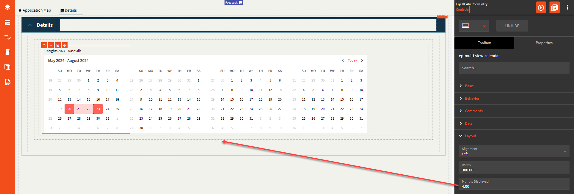

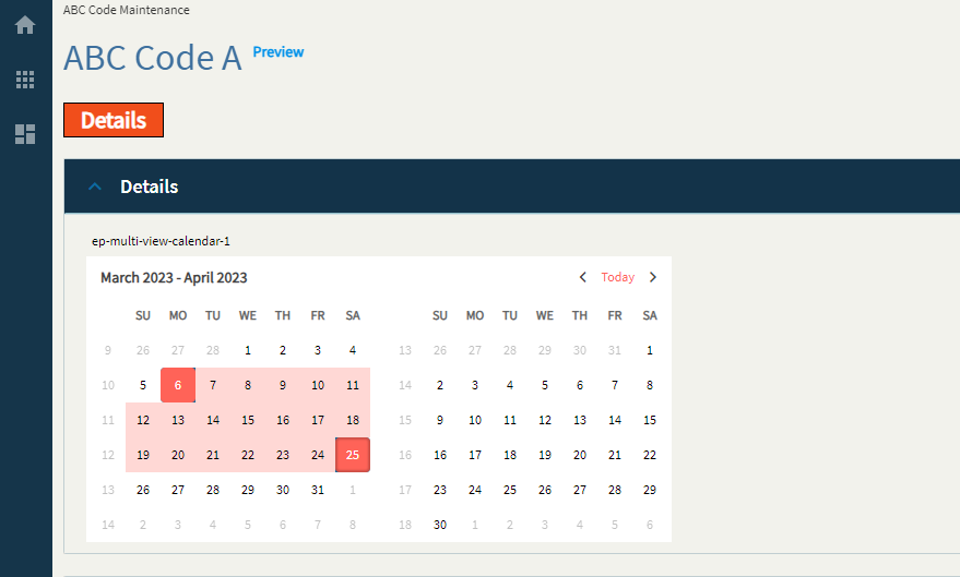

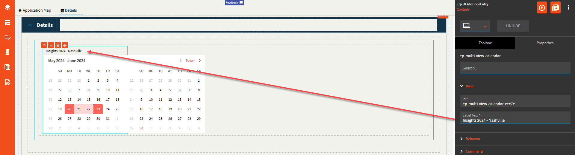

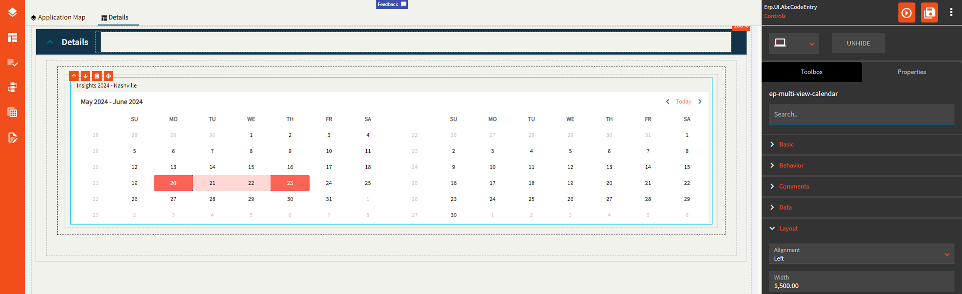

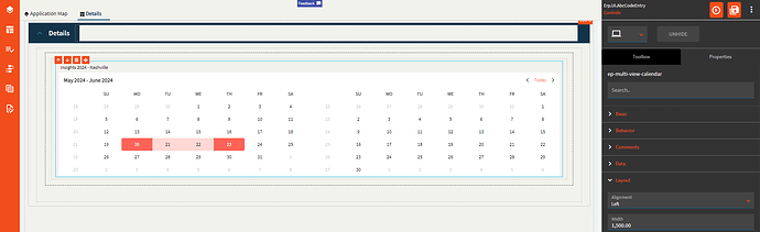

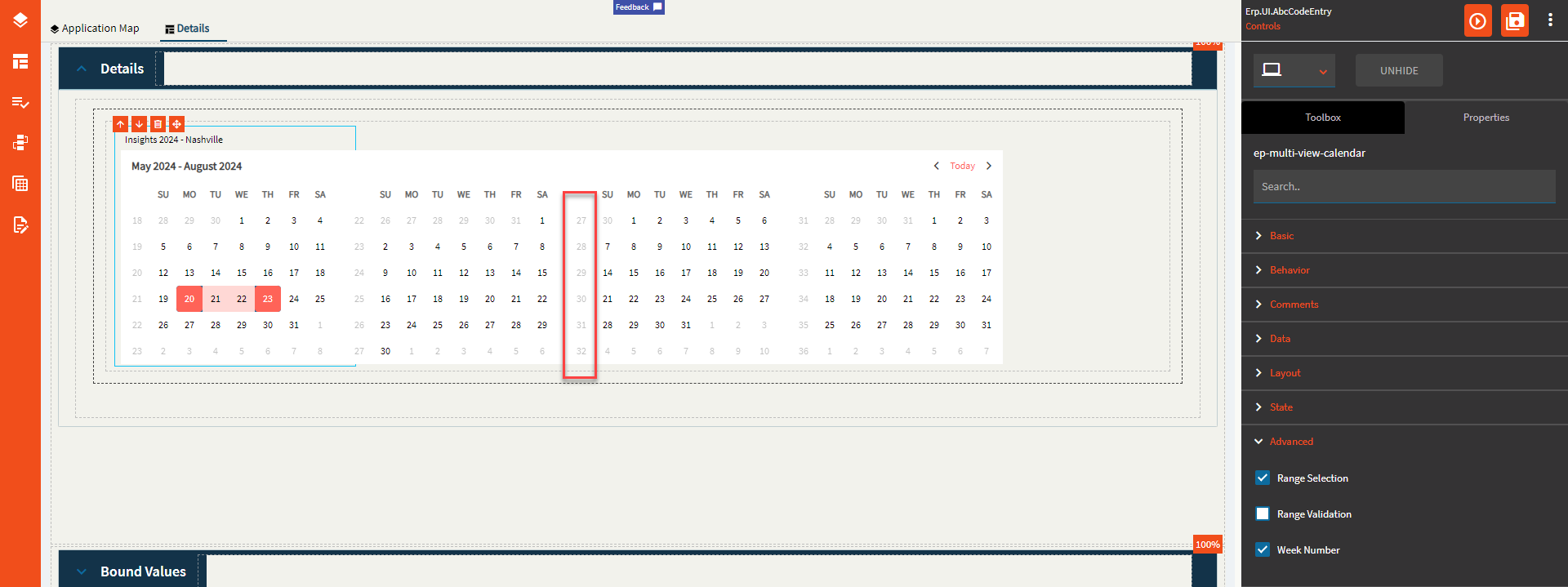

Multiview Calendar
The Multi-View calendar is an Angular form control that represents a graphical Gregorian calendar with multiple horizontal views. It supports the selection of and navigation between dates as well as data templates and ranges for scheduling appointments.
Data Range Start EpBinding Set the data binding to hold the start date of the selected range. Only used if the “Range Selection” property is enabled. (Fig. C)
Data Range End EpBinding Set the data binding to hold the end date of the selected range. Only used if the “Range Selection” property is enabled. (Fig. C)
Data > Selection Range Sets or gets the selection range property of the calendar and defines the selection range of the component. This really only works if the Range EpBindings are null.
Data > Selection Range Range Start Date The default start date for the range.
Data > Selection Range Range End Date The default end date for the range.

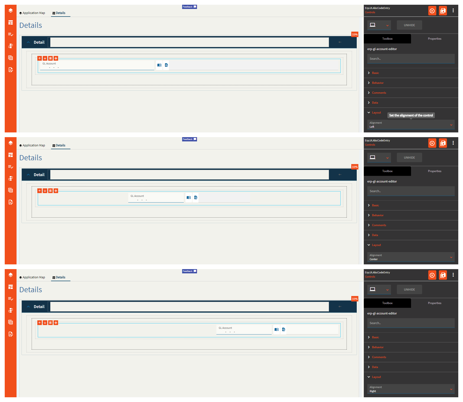

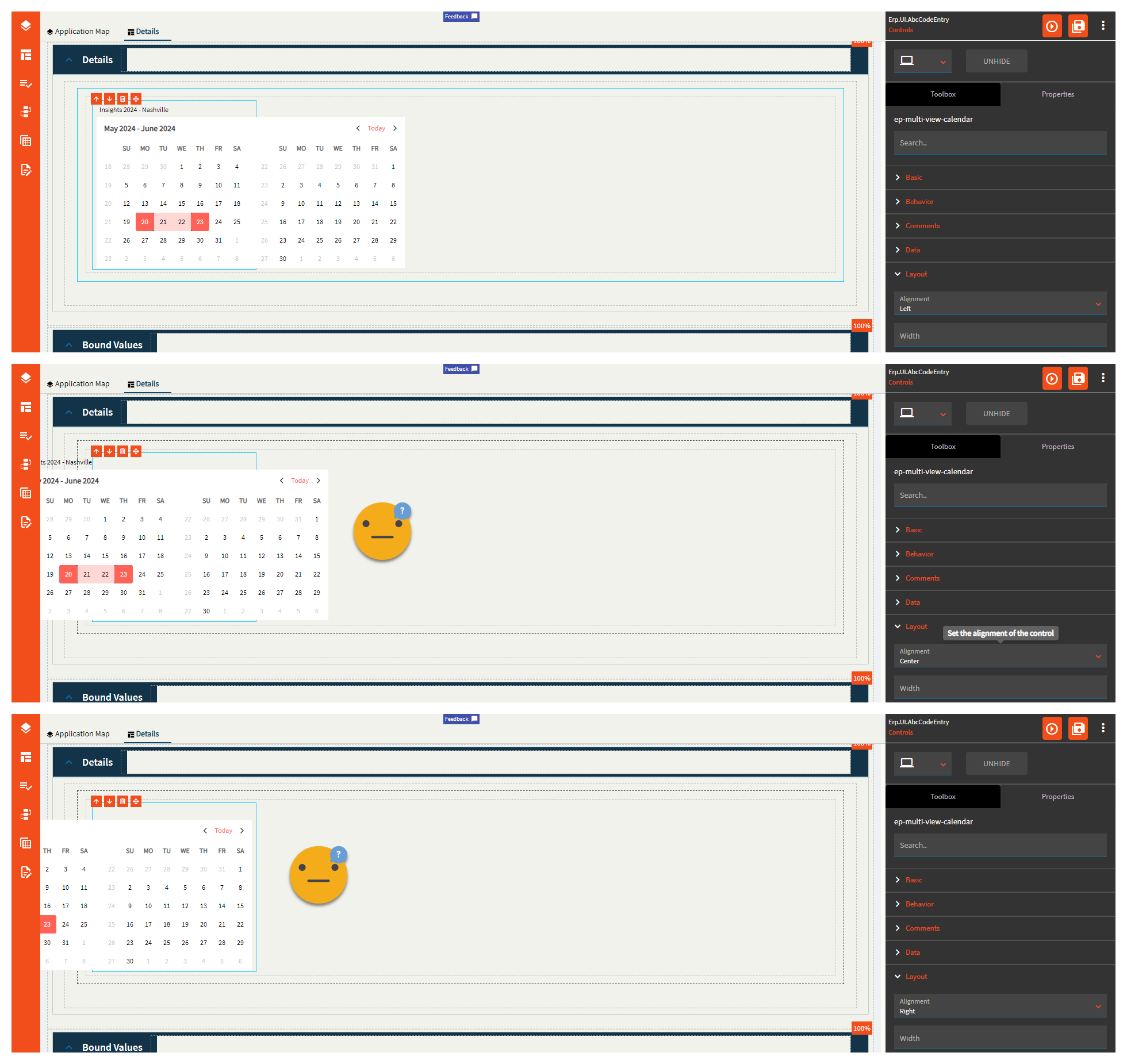

Layout Alignment :mag_right: Set the alignment for the control. Valid options are Left, Center, Right. Kinda wonky depending on where it’s placed… (Fig. D)
Layout Width :mag_right: Sets the specific width (pixels) for the control. (Fig. E)
Layout Months Displayed Show the number of months. By default this is 2. (Fig. F)
Advanced Range Selection Set to enable a range selection. Otherwise, this will be single select.
Advanced Range Validation :mag_right: Supposed to enforce some min/max validators, but those do not exist on this control, so this does not work.
Advanced Week Number Set to display the week number column. (Fig. G)
Figure B: Comments
Figure C: Range EpBindings
Figure D: Alignment
Figure E: Width
Figure F: Months Displayed
Figure G: Week Number
