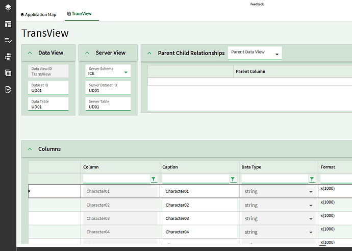

There is no path for a dv having blank schema value which is the case for TransView on ootb apps and if you add your own TransView, it’ll be schema ā€˜Erp’ or ā€˜Ice’ so it fails on path 2 beacuse there’s no BO Erp.TransView.
Adding TransView to well-known list doesn’t work because there’s no row at design-time.
There’s also an issue where custom columns go in additionalColumns array and no path handles those.
So custom dataviews and columns are pretty useless. I believe this finding likely relates to a bunch of issues around column inheritance in the framework. Your columns are just not there unless backed by a BO or BAQ. Shame.
EDIT: an ok workaround, as suggested by Kevin, is to set TransView to something generic like Ice.UD01 then use those columns instead of your own. Haven’t tried the pub/sub but pretty sure it’d work.
