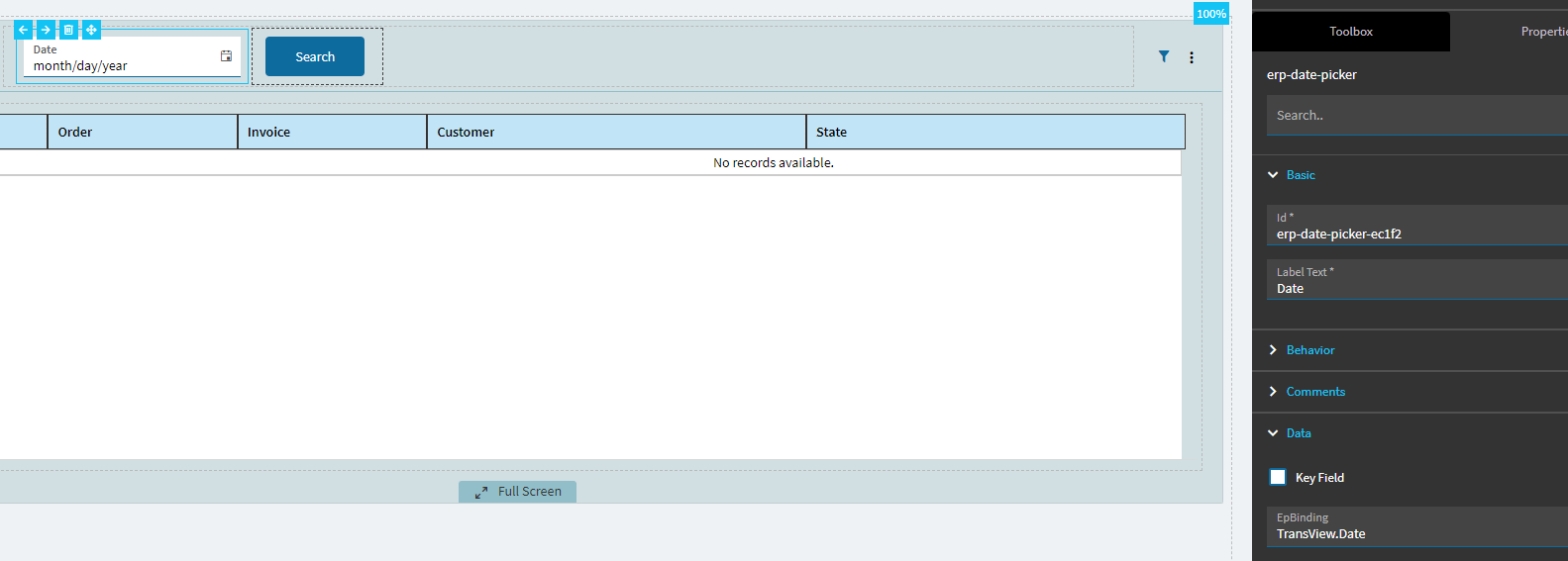

The date field is being bound to a TransView.Date
I’m defaulting the value in the date field to today’s date so there is initial data in the field by using the On Create behavior.

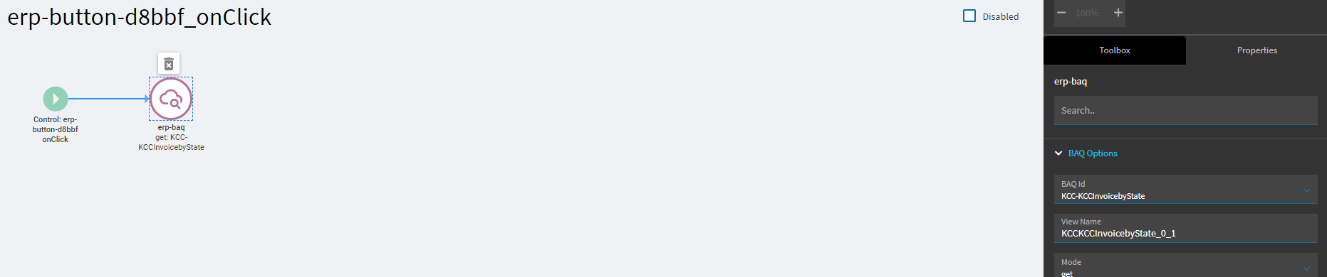

For the button i’ve got the OnClick event calling the view name and BAQ.

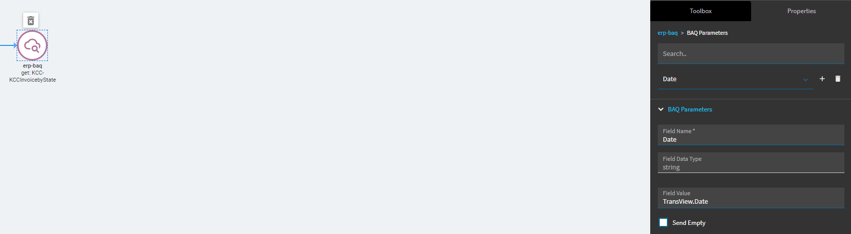

Now there is something I’m not doing right or it’s a bug in my version. YAY!! :roll_eyes: I can’t edit the Field Data Type it remains as string.
When I run it the date field populates with today’s date, but if I change the date and click search it doesn’t do anything.
When I go in the debugger it shows the transview binding but no column being bound.
Is “Date” the name of the parameter in your BAQ?
It should pick up the Field Data Type from the query parameter set up in your BAQ:

This may be why it was not picking up the “date” field data type when you tried it before.
