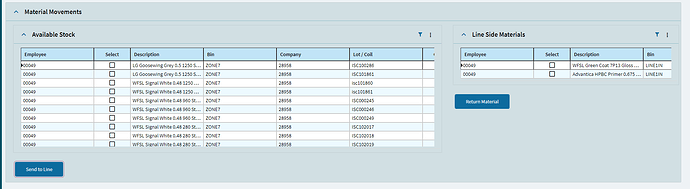

i have a dashboard i have created in Application Studio.
the screenshot attached shows an updateable BAQ, what i would like to do is tick one of the boxes in the available stock, and then when i press the button that says ‘Send to Line’ i would like it to move the materal from its current warehouse to a different warehouse and bin.
once we are finished with the material, i would like to then select a tick box in the ‘Line Side Materials’ section and when i press the ‘Return Material’ button, it will then create a move material request so the Fork lift operator can put the material away wherever they can.
