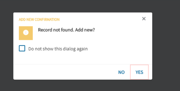

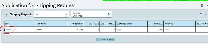

I am creating a custom Kinetic layer for UD01 table where I added a grid and am using UD Key1 as a link on the grid. I can add new records via this menu and they show in the grid, however when I click on my link to open the detail menu I get “Record not found. Add new?”

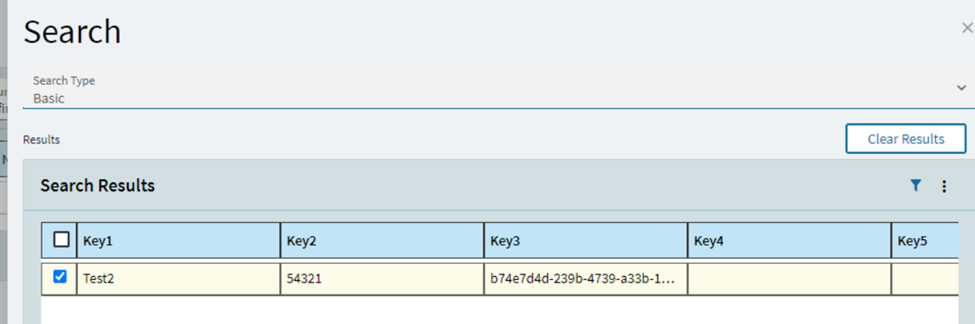

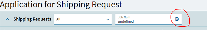

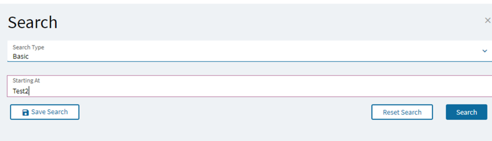

I can use the Search in Job Num above the grid
I am able to select the record

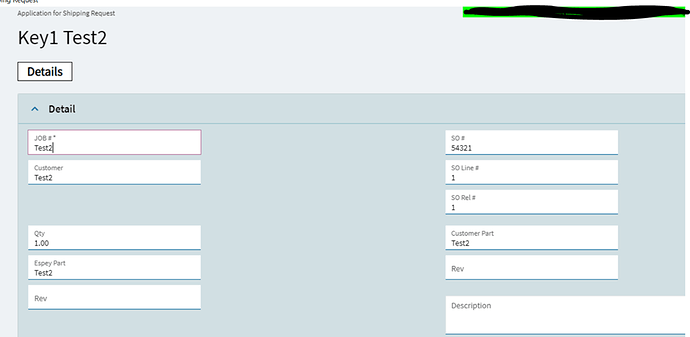

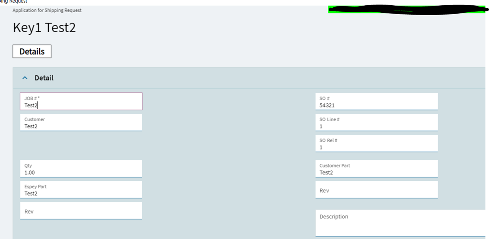

And the detail menu opens and allows me to update the record

I am not that fluent in Application Studio design and not sure what i need to do to link multiple keys. I selected Key1 as the hyper link for the grid as there was a checkbox. Do I need to create/update an Event or something else in order to select a row in a grid and have it open the Detail?
In Classic, if I select all during a search the List will display all records and I can click/select a row and then go to the Detail tab to view/update the detail fields. This is what I am trying to do in Kinetic.
