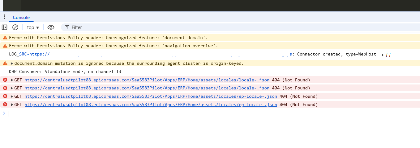

Hi,
I’m trying to use this tools on both Chrome 131.0.6778.140 and Edge 131.0.2903.99, but can’t make it work at all (No Windows popup after enable Trace). I just found that both Chrome and Edge mention polyfills.26b5daeb25c91dc4.js:17 is deprecated feature, which I think this is part of Kinetic UX Trace Utility core programing.
Is there any resolution for this error or which Chrome version is compatible with this tools?
Thanks.,
Best Regards.,
Sungsit
Update: Seems like a deprecated feature that I suspect is not the problem. I try to run tools on another machine which has the same Chrome build 131.0.6778.140 and some machine does work (but not all) even though it has the same warning about polyfills.26b5daeb25c91dc4.js:17 deprecated feature.
Still have no clue about this problem.

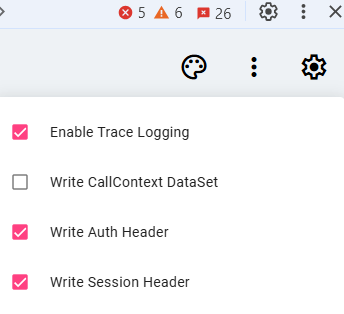

I did resolved it. The problem is related to the width of Extension UI. If it’s too narrow it will not work. Problem and Resolution can be reproduce with this steps:
Open Kinetic on Chrome browser then hit F12, by default Kinetic Trace Utility should show up on the right part of browser.
Case 1. - If width of this UI is too narrow, you will see the large Gear on the most right which has “Enable Trace Logging” check box inside. No matter how you try to enable it, this case will not work!
Case 2. - If you drag this windows too be wider enough, the “Enable Trace Logging” check box will move to top menu instead. If it display like this, the tools will work!
Notes: That’s mean, who ever display Developer Tools on Bottom will always work.
Too Narrow UI, Not working!
Cheers.,
Sungsit
Wide Enough UI, Always work!

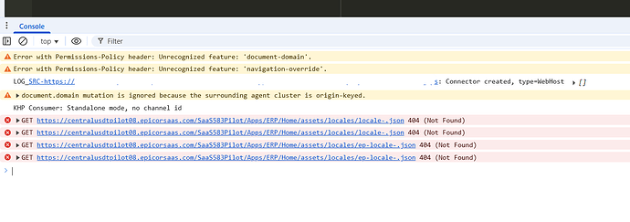

@r0lovic
Not work :frowning:
What you looking for? Did you install the extension?
Yes, I never get a popup, nothing happens.
It’s attached, and I’m full screen.

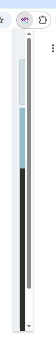

Downloaded and trying to use this and it’s popping up like this? Am I missing something?..
Please read the instructions and watch the demo. The tool is accessible via developer tools.
Oh my you’re fast haha! I just came back to say I figured it out lol. Thanks @josecgomez
