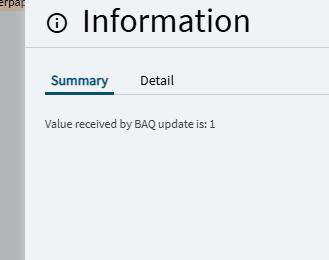

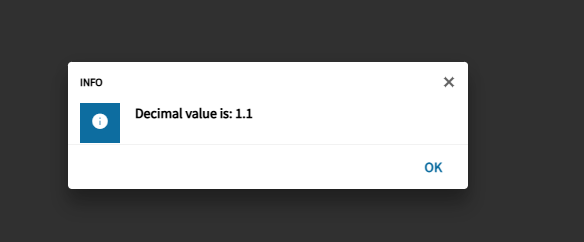

We use a classic updateable dashboard when adjusting part item/carton sizes. Having recreated the updateable dashboard in Kinetic we found the following bug- specifically when we have the kinetic-baq/erp-baq components “BAQ Update Options” > “Send All Rows” checked. For the cell we want to change – IF the value in the first row of that column is NOT a decimal value (ie: 0.00, 1.00) then any value we enter will be rounded up/down to the nearest integer. If the first value in the column is a decimal value (ie: 0.25, 1.50) then the saved value is retained (NOT rounded).

Anyone found a solution for that or opened a problem in EpiCare ? I understand that I could add a dummy row but honestly, that’s not an acceptable solution for a software this big. I don’t want to be using workarounds in every BAQ or layer just to prevent that error (It’s the 2nd or 3rd time that our users mention this situation since a few months)
If nothing, I’ll try to do a basic updateable BAQ to be able to replicate easily

I am experiencing a very similar issue. However, it is not based on the FIRST value returned by the BAQ. It is based on the First Value/Record that is updated.
The OrderDtl.DocUnitCost which is NOT updateable on the Dashboard, is being rounded when that value has no Decimals (10.00). Every record updated after that one will be updated.
However, after the user Updates the records that were altered on the Dashboard, it starts over again.
If the user now alters a record that contains the OrderDtl.DocUnitCost that has Decimals (10.55), all of the subsequent records that are altered will not have the DocUnitCost updated when the Update occurs. After clicking update, the scenario begins again.
If I alter a record with no Decimals First - Rounding for all subsequent
If I alter a record with Decimals First - No rounding issues for all subsequent
